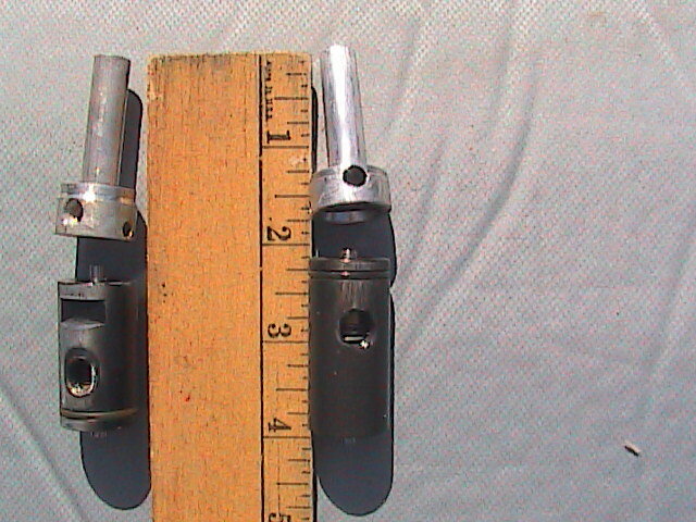

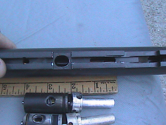

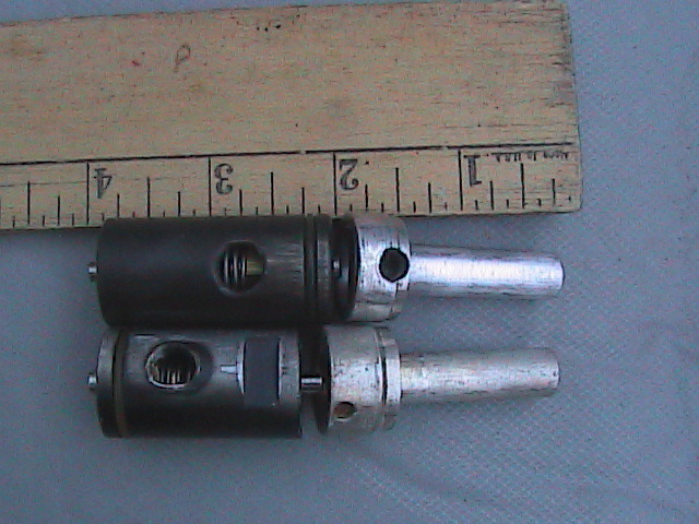

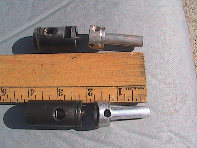

            Ok, so on the old board, I did a thread on older pro am, it had pictures and everything. Well 4 computers latter, I no longer know where the pictures are. As I remember it serial numbers below 10k had different construction, The most notable were the valve and power tube. The valve was much longer with no valve stop and the power tube was shorter (than latter models and the pro lite model) I did not take pictures of the trigger parts but I do think I remember them as being laminated.
            Now after Tippmann changed the internals, any of them sent back to the factory, would then be pro lite style internals.
            someone better than I and navigating the way back machine might find it, the pictures might be intact as I uploaded them directly to the website vs using a picture service

              found the pictures of the valve and power tube compared to pro lite ones, if yall would like me to post.
            • Myrkul
              Myrkul commented
              Yes please!
          • snaparen
            Neophyte of life
            • 57
            the valve with the valve stop is from a pro lite the other is from a pro am serial 216

              My valve and power tube are the Prolite style. That explains why the velocity adjustment hole was drilled twice. Still odd the stop wasn't added, and the trigger and sear replaced.
