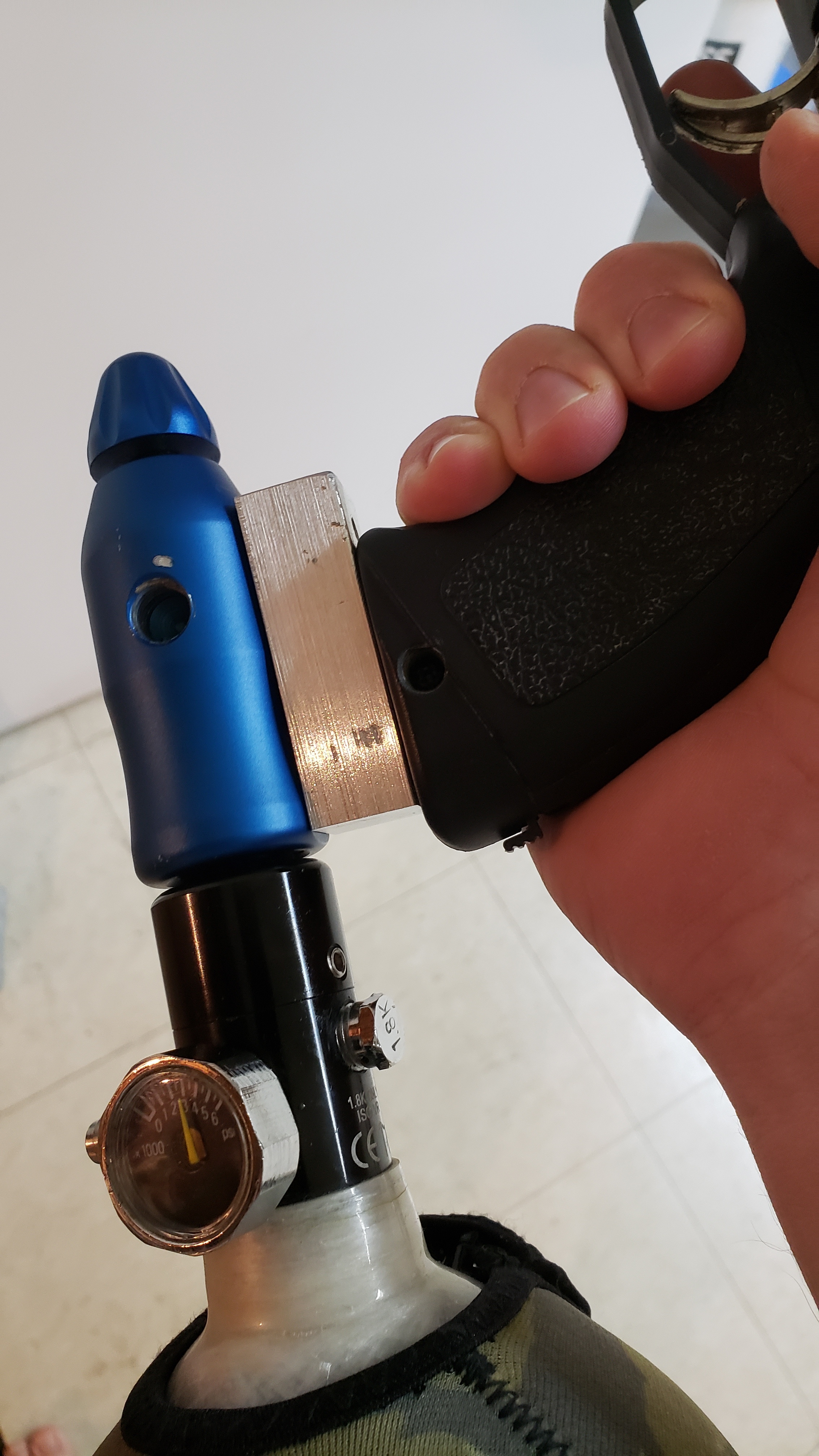

    Made a little air transfer block for my Phenom.

    Transfer or block off?

      Transfer. The I drilled the CP for an o-ring like they do on sleeper pneumags. I cut the bottom o-ring off of the air tube so it's wide open at the bottom to allow for air movement.

          Lol. I might. But it requires modding the on/off and the internal air line. So it wouldn't be a straight forward off-the-shelf kind of upgrade.
