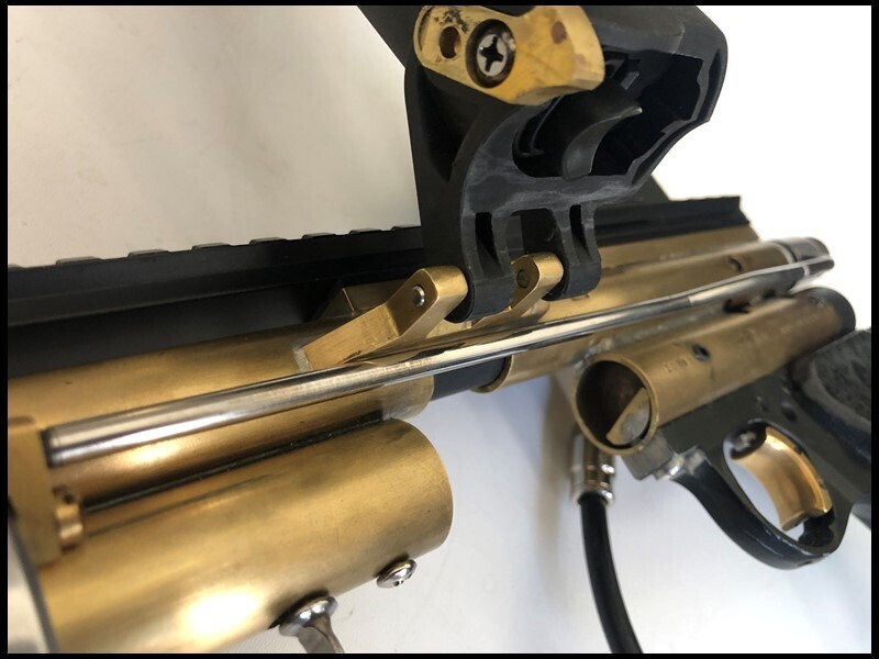

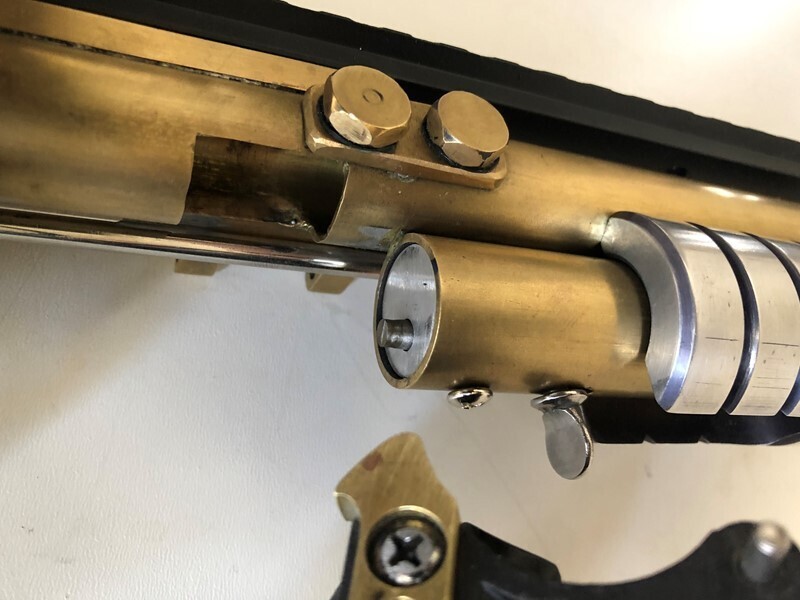

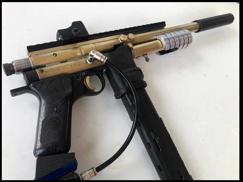

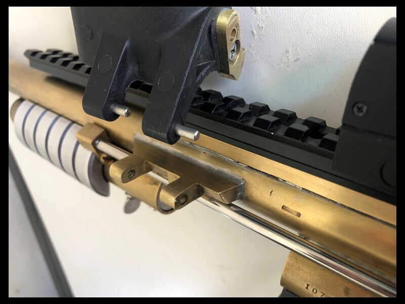

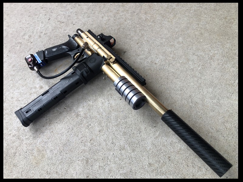

      rawbutter If you are able to get your hands on 1 of those Tippmann brand adapters. You must use it for making a fsr capable brass beast...
      Click image for larger version  Name:	image_9259.jpg Views:	20 Size:	80.2 KB ID:	381868Click image for larger version  Name:	image_9260.jpg Views:	20 Size:	85.4 KB ID:	381869
      Click image for larger version  Name:	image_9261.jpg Views:	20 Size:	90.7 KB ID:	381870
      I forget which brass mage here made this though, to give them the credit they deserve...🤤
      Edit...It was badger who created this...
