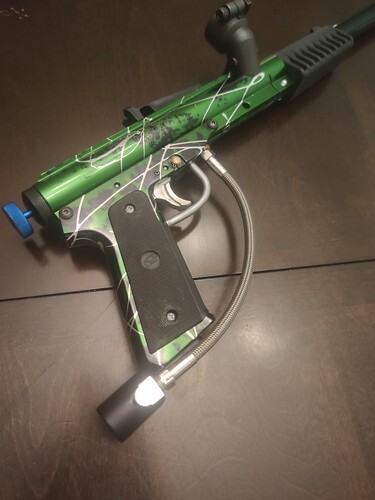

        Personally, for the sentiment, I wouldn't bother having it anodized- save that for a... shall we say, more worthy marker.
        I don't know, they look pretty sexy with a bit of color on them.

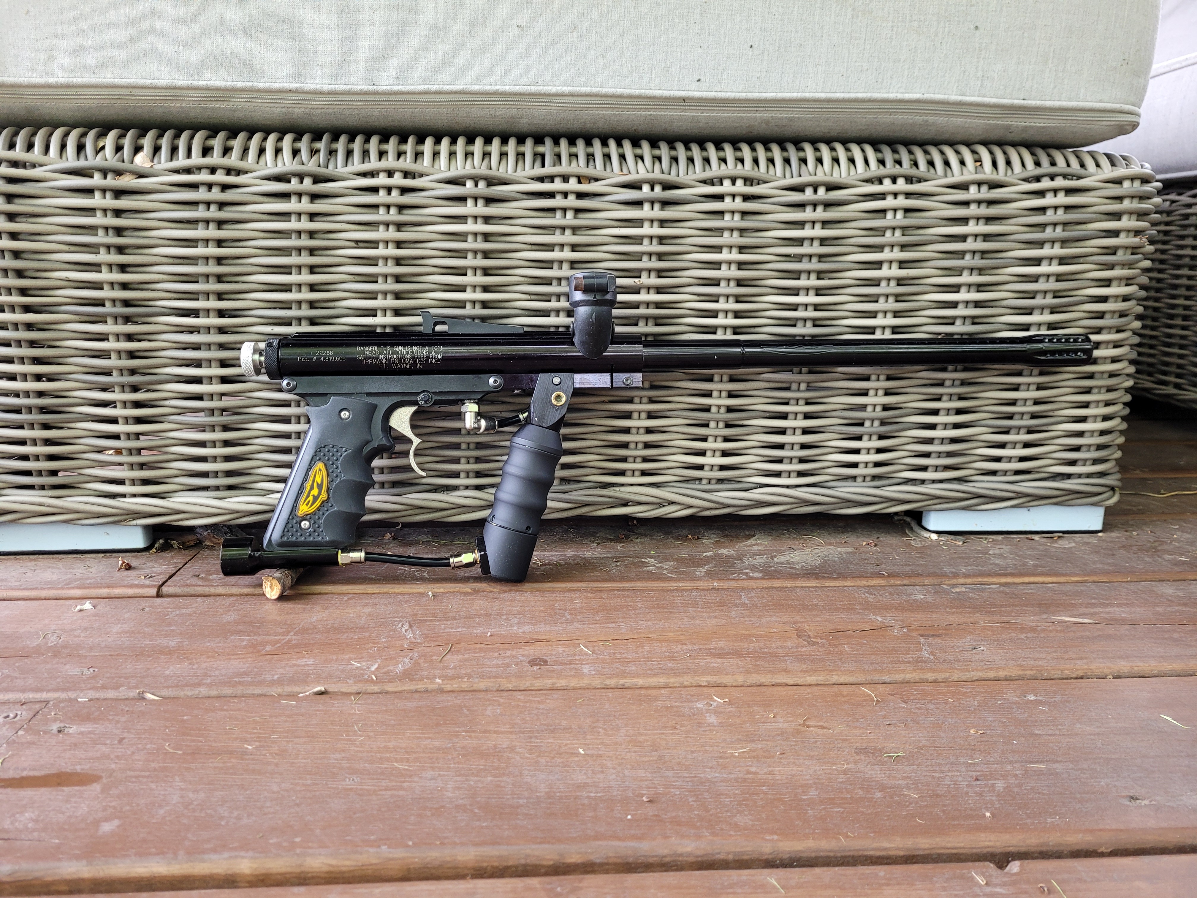

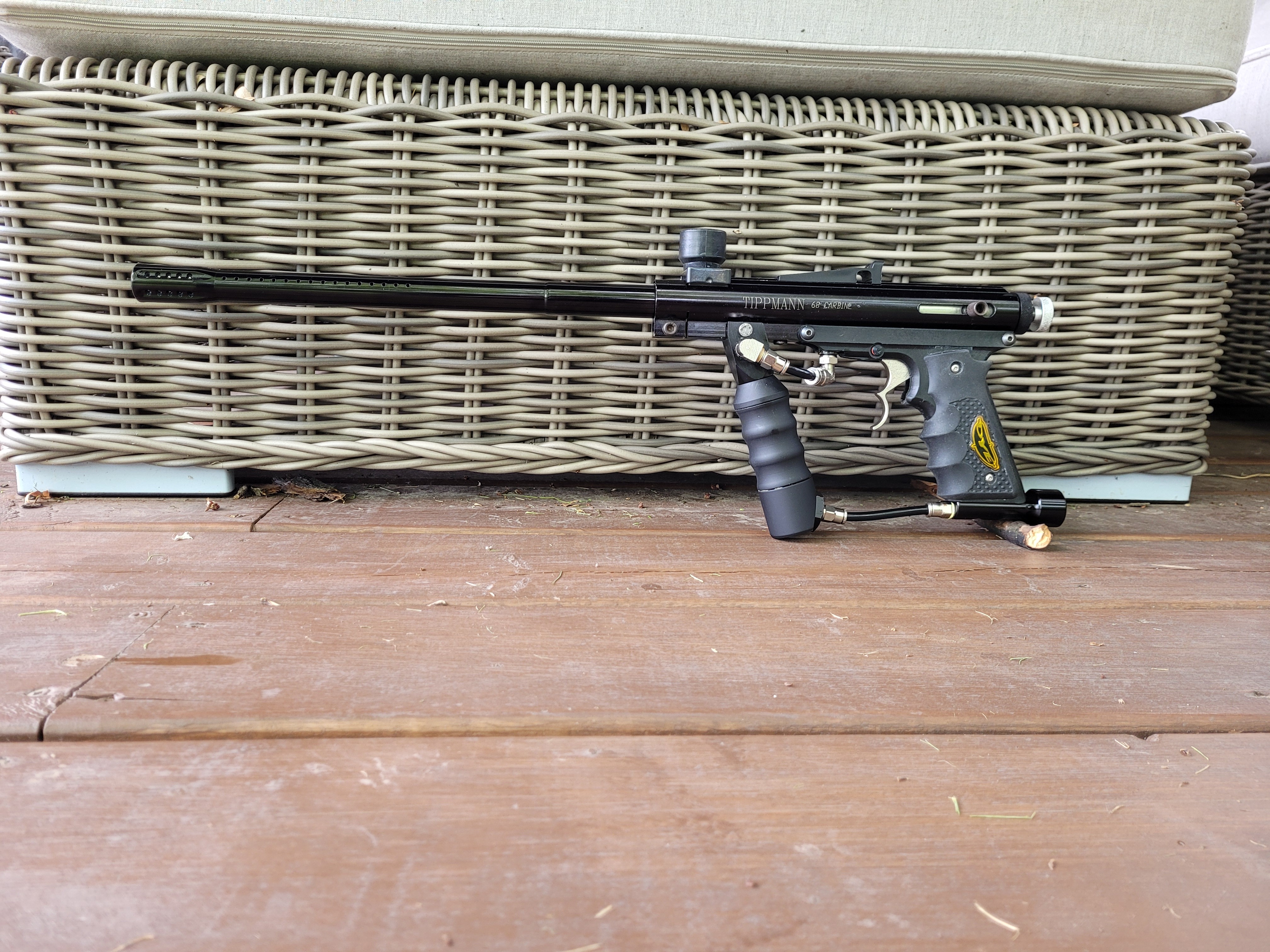

          I found a 68-Carbine on here over year ago, and built it up as close I could get to how my original gun i had in years 2000-2001
          it's got the tippmann vert kit , lapco pro-lite double trigger, taso rva, PTP intruder ex chamber, dye stickies and a dye 14" barrel , and a sconi asa
          I need one final part to call this build completed, which would be a Lapco 68-carbine stainless cocking knob !
          Click image for larger version  Name:	tipp1.jpg Views:	114 Size:	3.02 MB ID:	468972 Click image for larger version  Name:	tipp2.jpg Views:	112 Size:	2.76 MB ID:	468973
          • eld_catharsis_1968
            eld_catharsis_1968 commented
            You did a really nice job! It looks really sharp. Mark this as the first time I've ever seen a carbine rocking a double trigger.

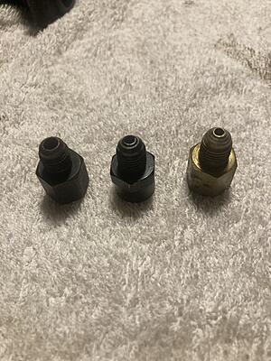

              Re: the airline reducer/valve fitting airflow:
              all three of these were factory. The one on the right has a small bore middle is medium and the left is the widest. Any wider than that and you are too big for the oring seal. Have a look at your reducer, if it’s like the right side you can benefit from opening it up.
                It's been a decade since I looked at it last but I'm pretty sure it's restricted like the one on the right, maybe the middle. Is this an easy part to source, or do people modify the fitting themselves? I think given the option I'd try to get a new one rather than mess with the structural integrity of a high-pressure fitting... unless that's something that's been done before with no ill results.
                Thanks so much for the help! My brother has agreed to ship the marker to me when he picks it up around Thanksgiving. I'm really excited to begin work on it and I'll keep y'all updated along the way.
                ETA: Went back and read Myrkuls post and he said he drills them so I think I'll be good to go there. I'll definitely need to replace that seal, I remember it being pretty chewed up. I think that the flexible hose might have exacerbated that. Do people ever hardline these or do you think that would add to the restriction? I could see a hardline bent the right way looking really nice on a carbine. Definitely another thing I like about the pro-lites, that airline trigger guard is pretty genius.

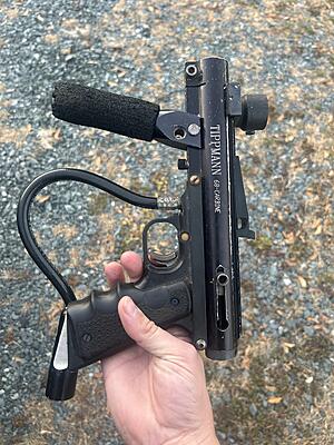

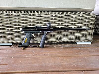

                  Happy Thanksgiving yall! My brother sent me this photo of my 68 Carbine. Talk about a blast from the past, I got this marker around 18 years ago, I was 14. He's dropping it in the mail to me shortly. I'll definitely be wanting to pick up a horizontal foregrip since that's an appealing part of the carbine look for me, as well as a barrel that'll accept the foregrip since mine are apparently long gone. Any recommendations? I'd love a simple, Phantom-style ported 11-in barrel and will probably have it anodized to match whatever I do with the body.
                  I'm going to do all new matching hardware and screws as well, will probably just go to the hardware store and get all new stainless. Not sure what I want to do with the vert foregrip. I think I might hard-line the vertical adapter and stick an expansion chamber on it, and hardline that too. Or I might just get rid of it completely. Will definitely be picking up a new hose, I don't trust the one that's on it now and don't remember putting that one on there. Pretty sure it had a SS braided line on it when I had it.
                  After all of that, I'm going to need to decide what parts I want anodized and what color scheme I want to do. If I do an expansion chamber or regulator, I'll prob have it anno'd to match. I'm definitely going to do muted/camo type colors, just need to decide which ones and what pattern.
                  Thank you guys for being along for the project and all the great advice so far! I'm super excited to get started and truth be told, I won't be sparing much expense on getting this thing up and running and looking great. After I anno it, I might even see if I can get the "Tippmann 68-Carbine" re-engraved on the side. It might all sound kind of silly, but this is primarily going to be a therapeutic process for me more than anything else.
                  • Myrkul
                    Myrkul commented
                    0.685 CP one piece barrels fit snug under the stock carbine foregrip/shroud. They also shoot absolute darts and are cheap.
                    Thanks for the recommendation Myrkul! Any particular model? Looks like CP has made a few different styles of one-piece bbls over the years. Would love this marker to end up being a tack-driver!
                  • Myrkul
                    Myrkul commented
                    Just the basic 12" With a 0.685 bore, I believe they call it the "Classic" On their website. Should only be like $30. It's what I run on mine anyway and it works awesome.
