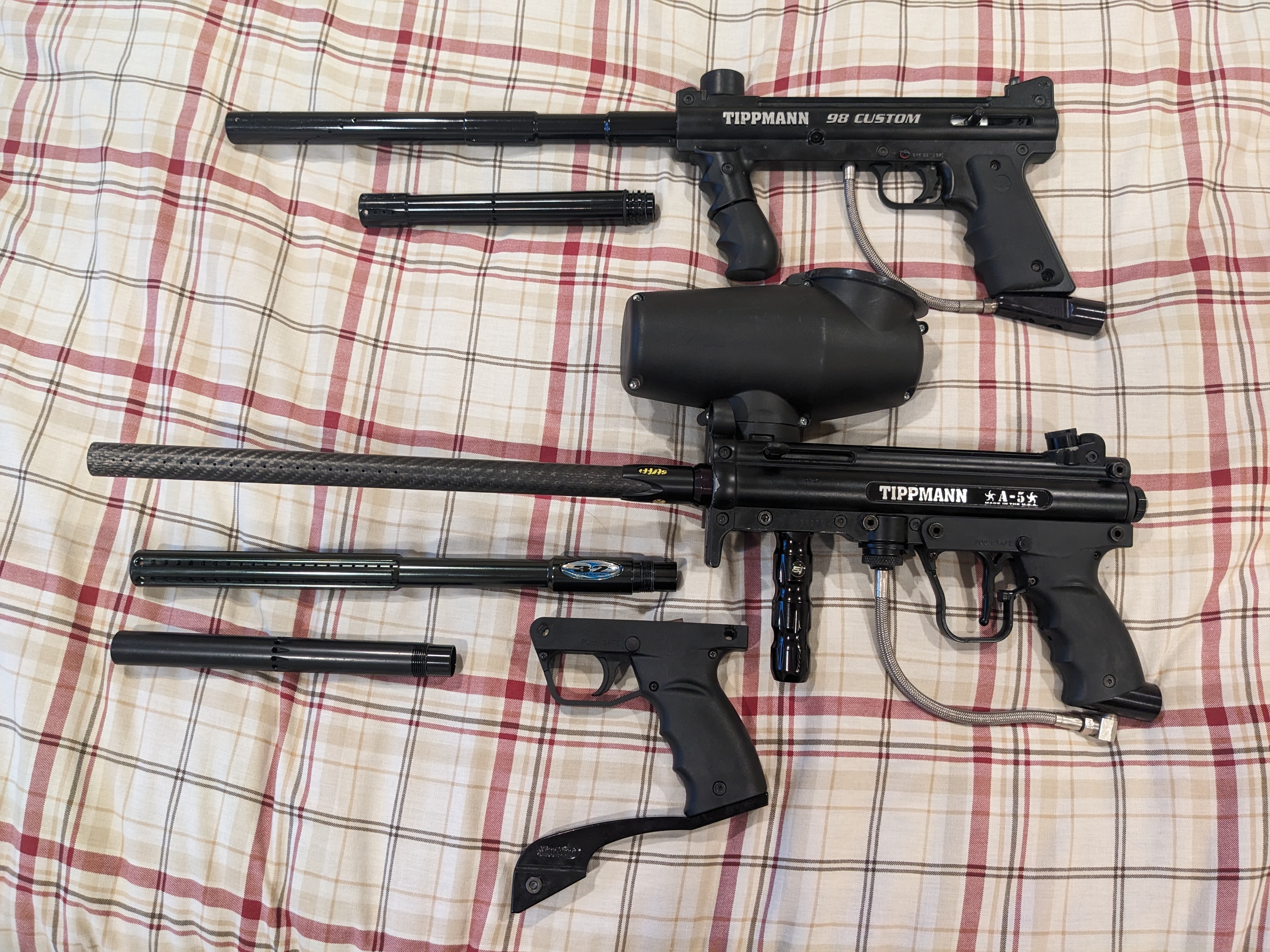

            Got this plus 3 CO2 tanks, a very old HPA tank, a bunch of pods and 2 holders, plus a Scott mask in good shape. The A5 came with an electronic frame that the seller thought was broken, but I got it working. Shocktech front grip and drop. 32 degrees whisper barrel, Stiffi barrel, and the 98 came with an ACI barrel. Parts kit and manuals. Solid for $50! Needed cleanup and lube, but they shoot and seal.

              Good vintage, these are Tippmann pneumatics , not later Tippmann USA. Those pre badge custom 98s are rock solid.
            Nice job even if you just got the 98 at $50 I would say it's a good deal you got a really good deal on all that
            I'm not surprised about the e-frame those things can be finicky and confusing I've had plenty of people say they're broken and they're not

              It's a 691 Stiffi and a 32 degrees whisper barrel. What's the general consensus on these barrels?
                For the stiffi make sure you use a squeegee and not a barrel swab. Fiber swabs will get caught in the fiber weave. They are not bad barrels but pretty much their only selling point is that they are made of carbon fiber
                The whisper is a decent barrel I wouldn't say it's anything super special but much better than stock
