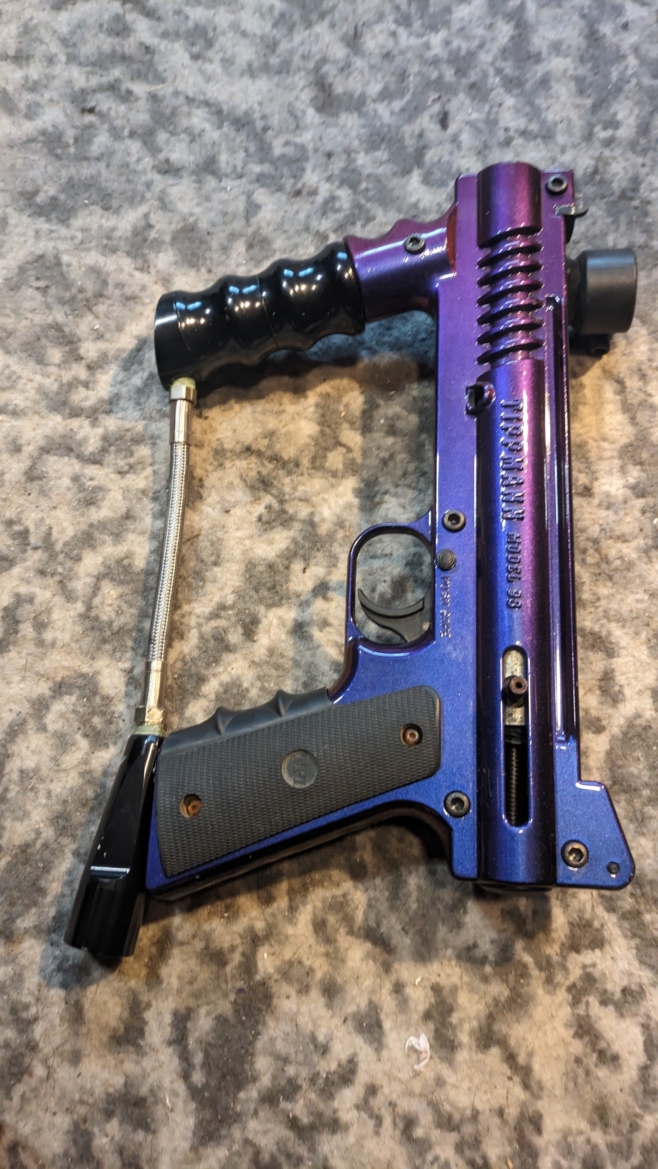

    Hello y'all,
    I got a chameleon model98 in a tade, and I'm thinking about putting a ring trigger and rt kit on it smog a few other upgrades😅
    How much of a blasphemy would it be to chop the trigger guard and maybe milling a few things inside to fit the rt?
    What y'all think?
    Thanks,

      How’s the condition of the finish? I personally wouldn’t if it’s super nice but that’s just like my opinion man. Source one of the old ptp 99 double trigger guards and it’ll look legit.

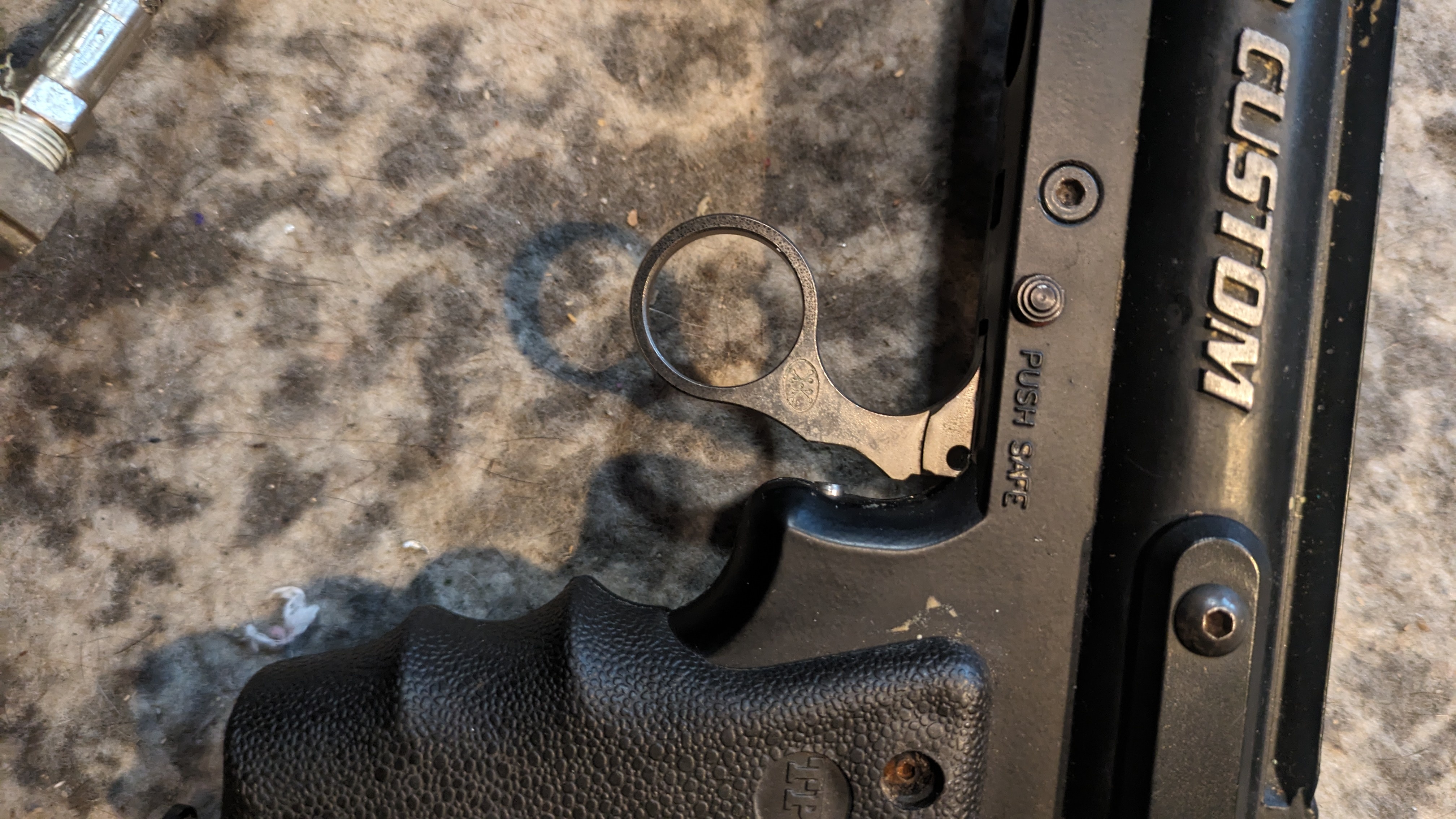

                  It's in decent shape except for some dings on the back of the frame. It would be trashed I would not feel one bit, but I'm just wondering if I'll feel bad once it's done and over 😋
                  If I do it I would probably use a cool aftermarket guard or make one out of stainless and heat oxide some purply color ...
                  Ecapnation
                  Do you mean the internal tabs and the hole on the right shell?
                  I'm planning on doing all that and using a 98comp valve body so everything looks like the 98custom but with the guild body 😁

                  Be sure to check the trigger linkage before you commit to this most of the m98s used pull springs for the triggers and Sears while most of the 98Cs use push springs for both.
                  It's not an insurmountable problem but is rather annoying to have to fix between the two
                    • 4422
                    Also you'll need to modify the trigger spring to be in front of the trigger not behind..
                    It's doable but with this one being a unique factory color and 98 customs cheap as they are is the work justification worth it.... To me no.

                        That’s a pre badge TPI 98, I think it has the same trigger parts as an old M.

                          So just don't do the trigger in the m98. Put the RT in it and maybe a RVA.
