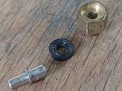

    Pro-lite valve material
    What is this stuff? Flexes quite a bit - not quite as much as a 70 durometer o-ring but still noticably squishy. Im thinking 90 durometer polyurethane?
  • Chappy
    Overmoderator
    • 1308
    I’m starting to think the seals in og tippmanns were made of Poly-unobtainathane. But I believe you are correct
    • mikeds80
      Paint Zaddy
      • 14
      • CT
      Have you had luck replacing the material with a modern oring? I have two prolites that likely need valve work.

        I have not yet ordered any material. Im building a list of stuff i want from mcmastercarr.

            You planning on making some new ones I take it Mark?

                Chuck E Ducky yes i plan to make new seals. Along with some different style valves. just messing around with a bunch of old broken guns i got for cheap

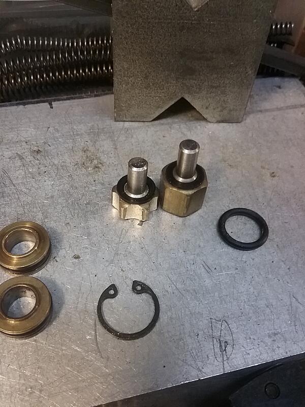

              • BretG
                • 717
                20190602_112547.jpg File it
                Sic transit res publica
                • Cal440
                  Cal440 commented
                  Are you reducing the height also, as well as filing the grooves?
                • BretG
                  BretG commented
                  Yes. The more internal volume you have, the better. Also I do the front poppet with all 6 facets filed and the back poppet only 2. This sends more air forward.
                • Cal440
                  Cal440 commented
                  Thanks for the clarification
