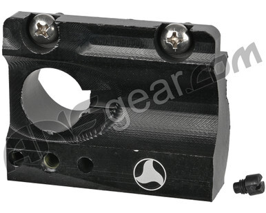

    My biggest mod was the Flasc A5 Rip Clip adapter
    https://ansgear.com/flasc-paintball-...lack-zyx-1830/
    This part was awesome, or rather once the rip clip ( i had the first gen on there) was installed , the rip clip was awesome. I rarely (maybe never) had a misfeed in this gun , and obviously this loader had no problems keeping up!
    I wish I had tried out a RT trigger with this setup before selling , as I imagine it would have absolutely "ripped" << pun intended! >>
    I ended up selling due to the already unbalanced front heavy ergos of the A5 , which were made worse by the heavier rip clip loader

      Yep , the BT RIP Clip apparently has the Halo guts inside, so the flasc adapter would basically make the A5 look like a BT TM7 with rip clip installed.
      so my A5 ended up looking like this https://pbsports.com/products/used-empire-tm7-black
      Another interesting fact is the flasc adapter is a permanent destructive mod, meaning you need to snap off the cyclone feed hook off the A5 right hand shell....
