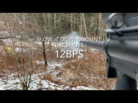

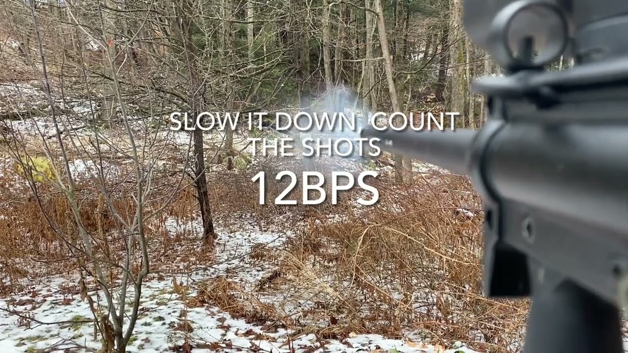

      • AnarchicArctic
        💀Founder Ragnastock💀
        • 961
        • Berkshires
        A bit of testing today. Nothing video worthy. I took the clam shells apart, polished the over spray and lubricated. With the same velocity screw and rt piston settings as before, the stock 1/16” rt hose performance jumped from 7 to 12bps. Plenty of ball breakage as before with the same rof on the super hose. I swapped to a fresh detent hoping that was the cause of the breakages, but it didn’t fix the soup. I’ll order some of the different paddle grades to try, as well as harder shelled paint.
