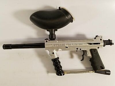

What is on this 98?
  • MrKittyCatMeowFace
    • 2378
    What is on this 98?

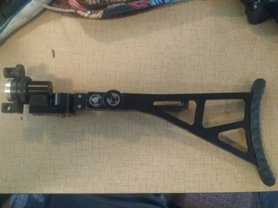

    The jcs piece on the back is what im ref
    Marker cocks easy but trigger is hard to pull. There is a broken piece in front of trigger; safety is also hard to push. This is a used, donated item that has not been cleaned, serviced or tested for functionality.

    Looks like just a broken/incomplete folding JCS stock.
    Edit... here's one for an A5.

      Very unlikely you'll hear from JCS at all about anything but at least the piece it's missing is easy enough to rig up.

          The folding stock part doesnt matter. The key here is that it is also a rear velocity adjuster. You can take the folding part off and just have the back cap. The back cap itself is the money part. They are the best Rva’s for tippmann s because they have a lot of travel. They are hard to come by these days and are worth we’ll more then the price of admission so far.
