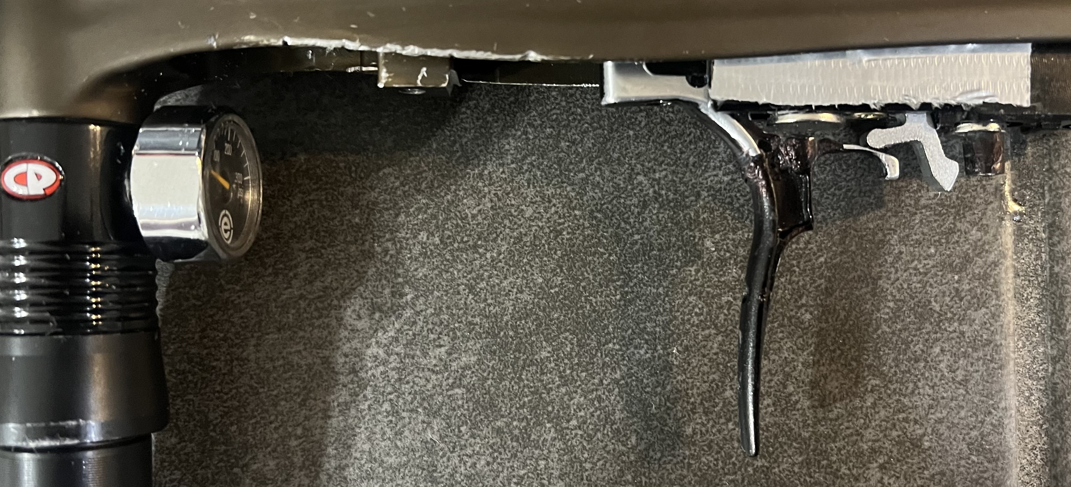

    The Automag bolt test will have to wait but I ordered a TechT MRT Pro Series Tipx bolt last night and hopefully that’ll be here soon so I can wrap this thing up.
    I did more trigger work recently. The return was too strong with the larger magnet behind the trigger lever. I swapped places of the larger and smaller magnet and it felt ok but then the return wasn’t strong enough. Tricky. When I say return, I mean the return of the trigger lever, not the trigger itself. It’s weird. The trigger lever (sear) is basically an extension of the trigger itself. It’s like tuning 2 separate triggers.
    Anyways, for those of you that have Crossovers you may have noticed that the trigger could definitely be more responsive in mech mode. Sometimes you may even experience shoot down. That’s not really from the trigger but the trigger lever not resetting all the way and catching the trigger pin before it’s seated fully in the valve core.
    So I’ve got a magnet under the trigger itself, next to the trigger pin housing (?) and that magnet helps the trigger pull by snatching the trigger lever once it’s broke free from the magnetic field of the magnet(s) behind it. There are 2 magnets behind the trigger lever. One is flat and rests partially over the valve assembly housing screw and the other is the cylinder style magnet that was in my broken adjustment arm. It’s encased it plastic and sits on top of the flat magnet.
    These 2 magnets return the trigger lever back to rest very quickly. Aside from making the trigger feel a lot better I have a theory that it might help prevent damage to the trigger pin by quickly getting the lever out of the way so the pin doesn’t slam against it.
    You can’t see it but there is a small magnet in the trigger spring recess on the trigger itself. It’s opposing to the large flat magnet under the trigger. This helps with actually trigger return (not trigger lever). It’s much better than the stock trigger spring on both pull and return of the trigger. Then there is the stock trigger adjustment magnet at the far end, on the trigger itself, at the top. I adjusted this to the point the trigger landing (the part thats under the trigger lever) is touching the lever. The trigger adjustment magnet also acts as a trigger return magnet.
    So 5 magnets all in all. I re-polished up the points where the trigger contacts the valve assembly housing. You can see where I did it by its silvery appearance. There is a lot of metal on metal contact with this trigger and, in my opinion, polishing those points makes for a much better feel and performance.
    The trigger landing and the trigger lever were also re-polished. Focusing mainly on where the landing and lever contact each other. I also shaved off that last little bit that was poking out from where I cut off the part of the trigger that I wasn’t using anymore. Then to top it off, a little Mississippi silver on the sides to keep those pins from walking out.
    Here is a video of me just messing with the trigger. I’m doing it left handed so it’s not all that great but at the end you can see the lever really moving good when I’m walking it.

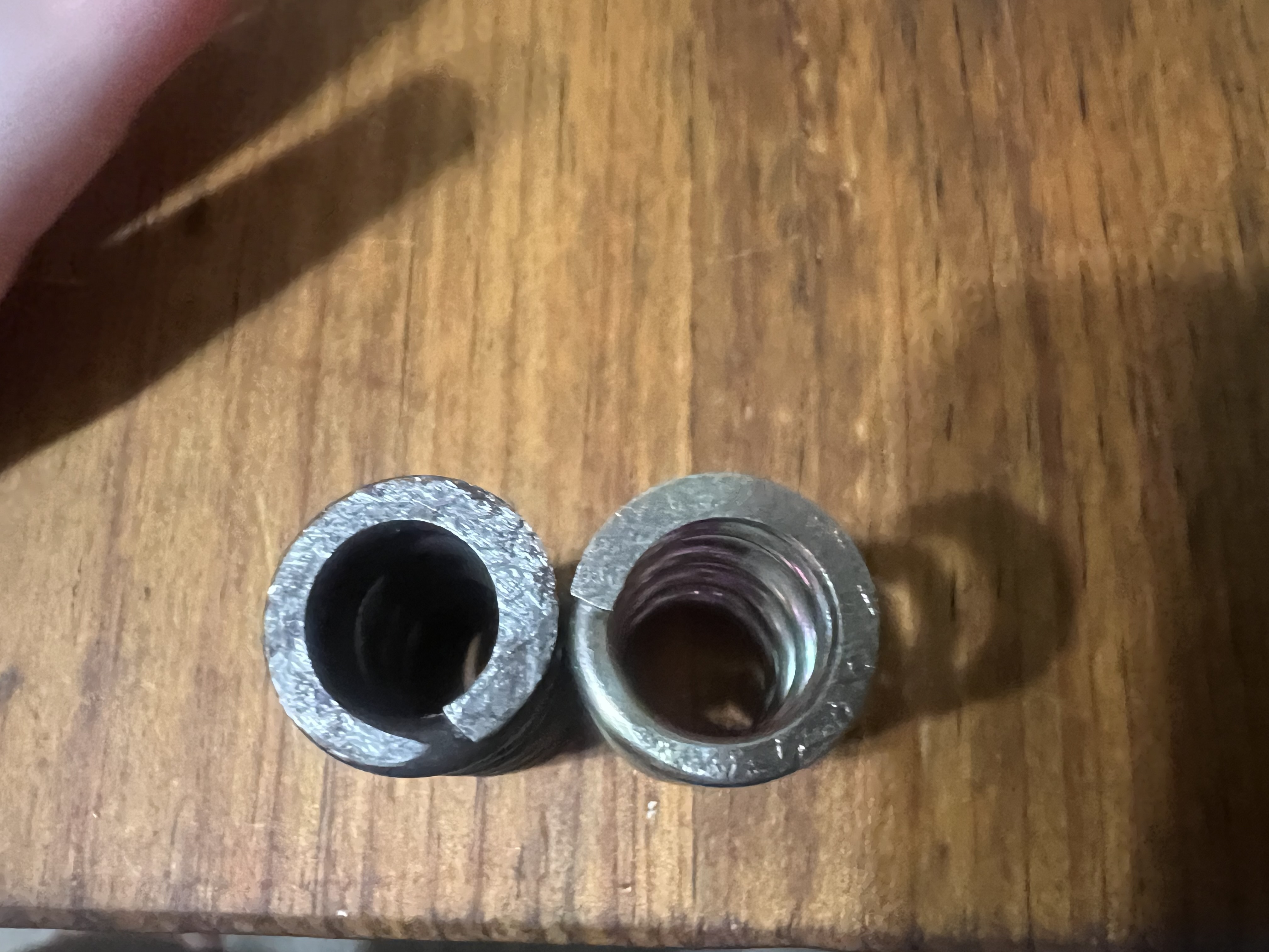

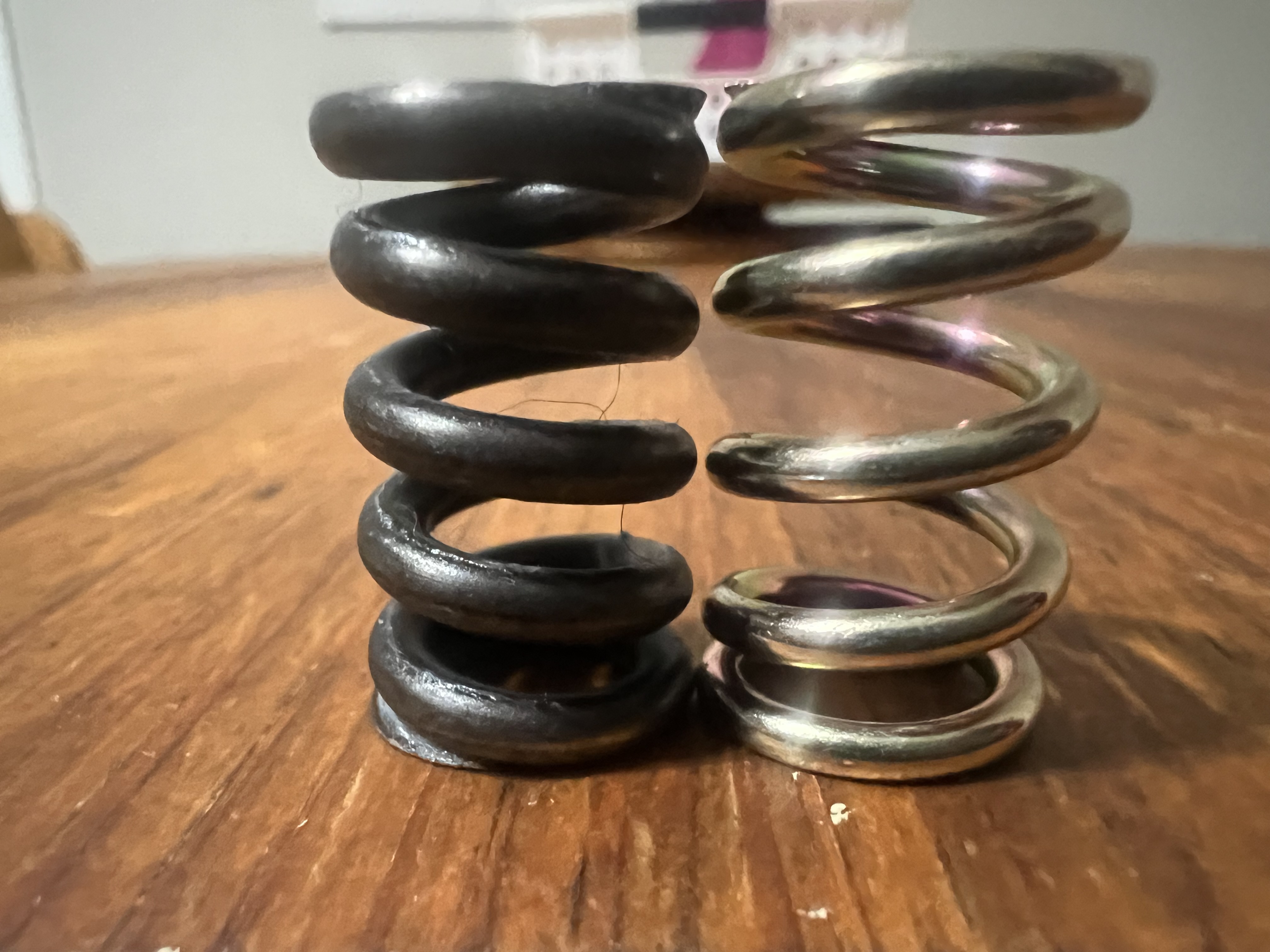

        On another note. The regulator spring for the PE SL3 reg is a drop in for the Crossover. Not a big upgrade by any means but it is a lighter spring and if you are dropping your OP via lighter front bolt, lighter front bolt spring, and volumizer I theorize it’ll give you better consistency.

        • FlightMedic938
          • Feb 2023
          • 440
          #19
          Stock spring and SL3 spring
