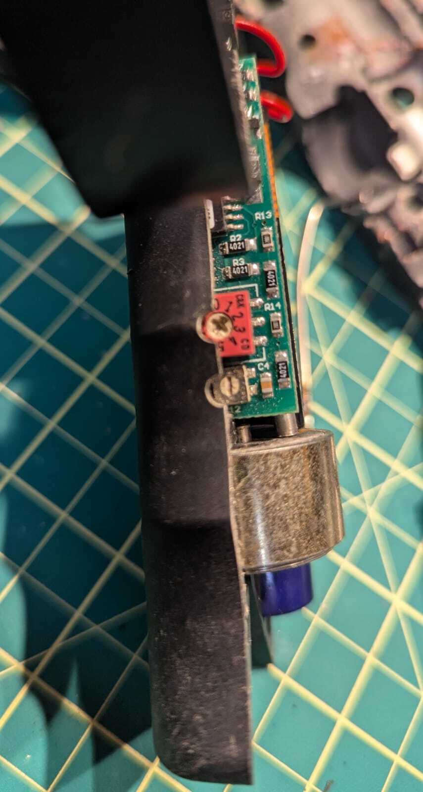

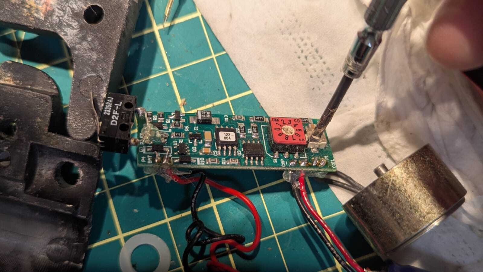

    Inherited this 13 year old A5.
    I have No idea how to turn this on.
    ​Installed a new 9v, and held the trigger [micro switch] down. Nothing.
    I put a meter to the, wire harness, micro swtich, and Cap. and all show 8.5 V.
    I think it's a WAS board <?>
    • 3398
    This is one of the awesome ones! That red pot is the on off and mode switch in one. The white pot is rof only. I think it topped out at like 10 bps or something, but its true fire modes. I'm pulling from memory here, but I wanna say like 1 is semi 2 is off, 3 is turbo, 4 off, 5 ramp, 6 off, 7 xxx, ect.
