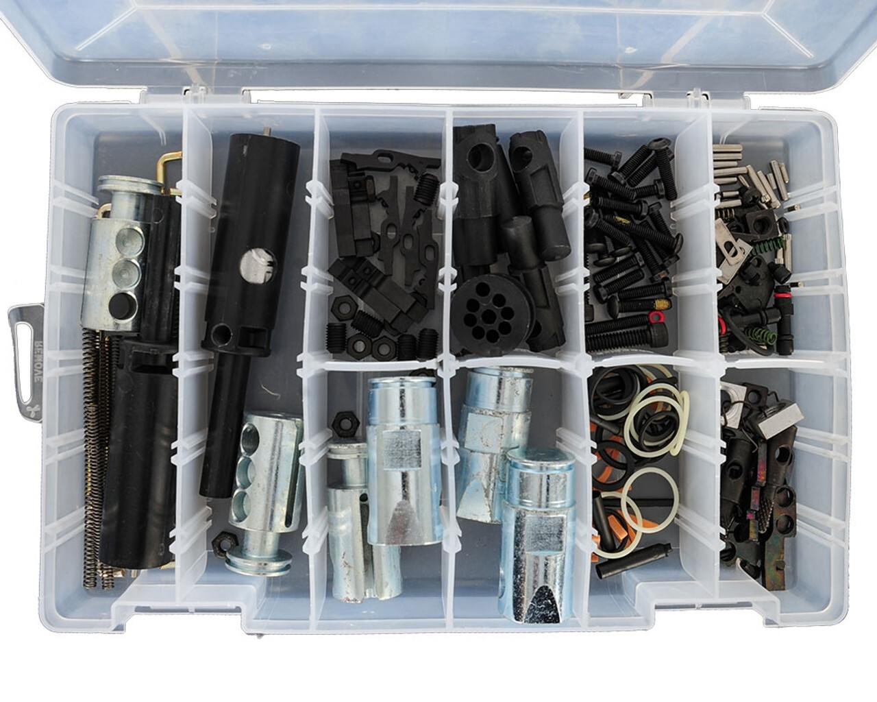

Other than getting another sear you could try a stiffer sear spring. Madman kits come with 2, a light one and a heavy one. The red one is the heavy one and could solve your problem. -
The only replacement sear I could find was in a 98C Platinum Series parts master kit for $250, at ActionVillage.
All the smaller kits do not contain a sear This kit has a small pile.

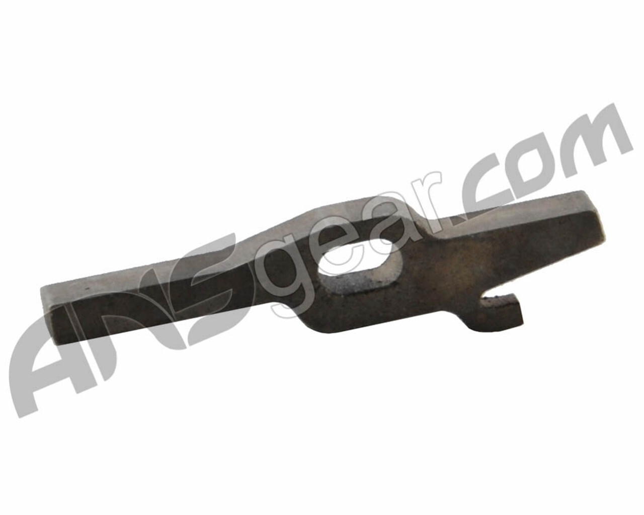

edit: Will this sear work for you? $8.99
Tippmann A5/ 98 PS/ X7 Sear 02-35 - Paintball-Discounters.comComment
ok, this may be a possible source of the OG style sear.
Oregon Paintball carries the largest selection of paintball products in the United States. Check it out @ oregonpaintball.com! | Oregon PaintballComment
