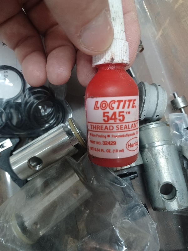

              I agree with trbo. Sounds like the air line may have a leak. But if your reaaalllyy wanna try a different method of sealing, you can try loctite 545. I believe this is what tippmann used from factory
