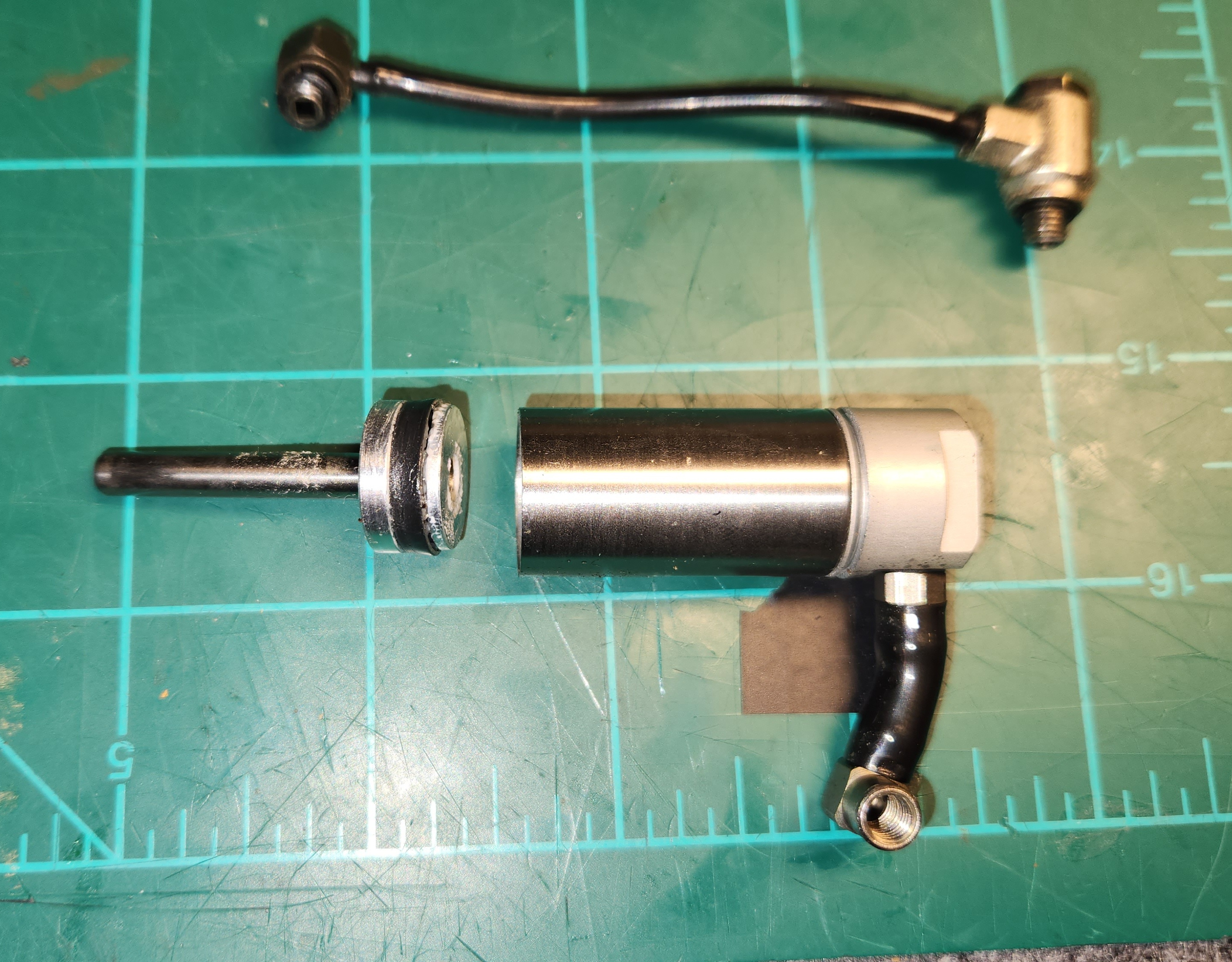

      Maintenance-wise, there're some smaller o-rings on the banjo fittings and one on the piston itself, which I believe is the same size as the front bolt (015). It's not too much of a fuss to get it dialed in, just need to ensure your hammer and sear aren't worn too badly otherwise those will start slipping and causing misfires. I put an aftermarket anti-chop front bolt system on mine and so far haven't had any chops with it. My Protoyz Speedster kept up with it well.

        I should add, I am using a high pressure output tank, anywhere from 700-850 psi, and am using the standard 1/16 size banjo fittings and hose. I did try and put a tee splitter banjo fitting and run a cyclone feeder as well, but was not getting enough pressure through that 1/16 line to move the cyclone feed paddles; I'm quite happy with the Speedster loader so I opted to forgo the cyclone feed altogether. The 1/16 line for the RT is working fine for my purposes. I guess YMMV

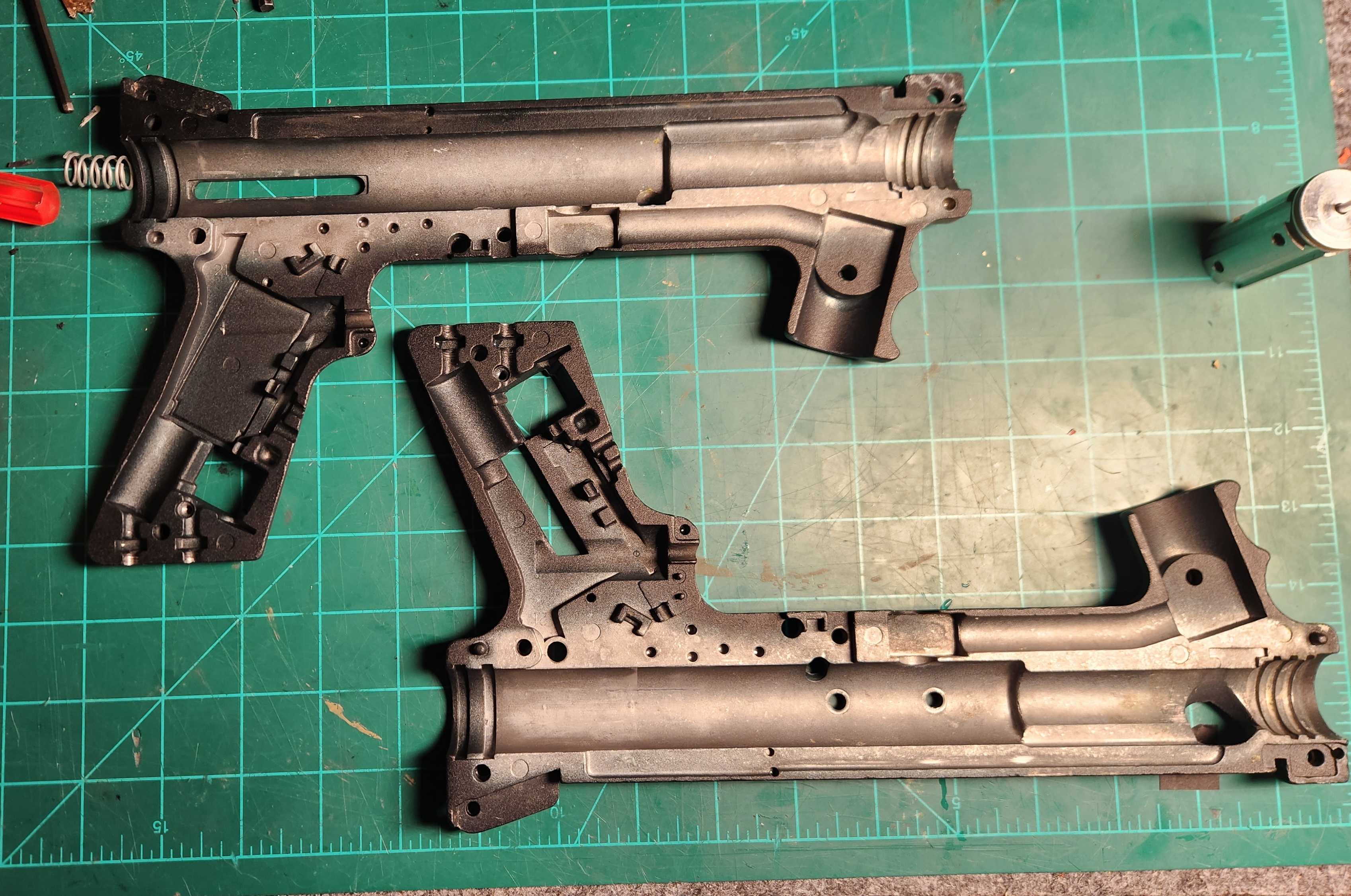

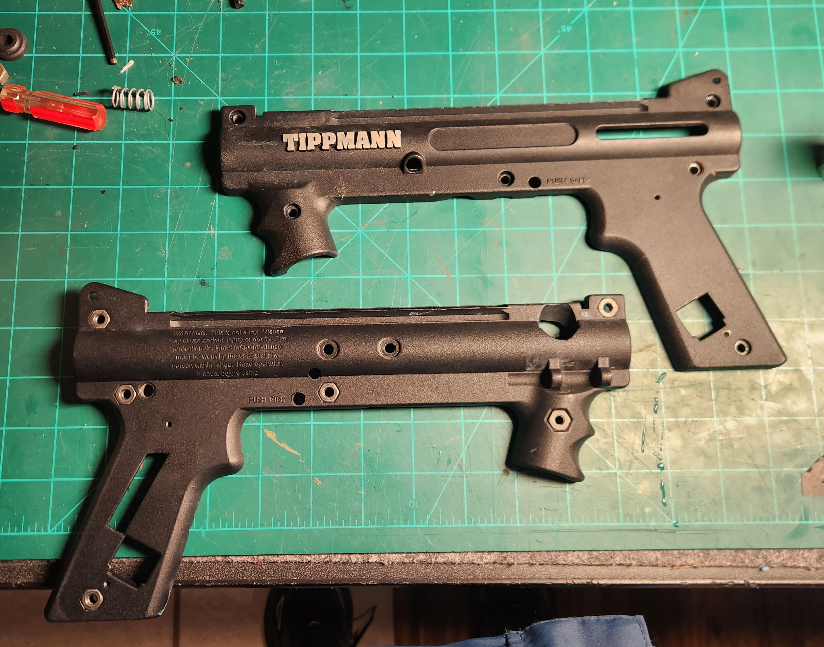

              I now have a shitbox RTed Model 98. It turned out to have ACT, which I'm not sure how I feel about. It was filled with the obligatory paint from its last use in 2017. Once I got everything cleaned up, I ended up with a box of parts and the shell halves.
ID:	794907 The finish isn't too bad, so I wont try to refinish it. I will polish the hammer area and the bolt run. Not sure if I'm going to keep the ACT parts or try to get it back into a more traditional 98 setup. I think I will keep the RT, but get the larger diameter hose and fitting set.

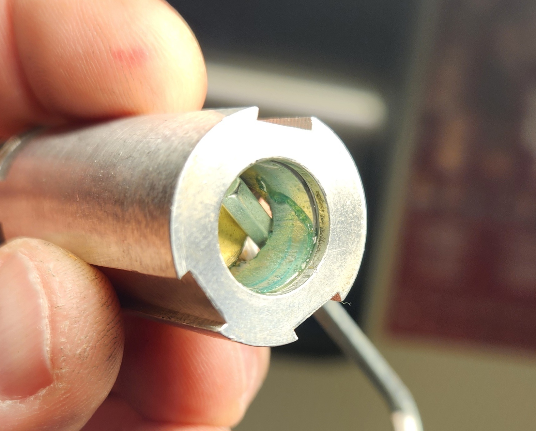

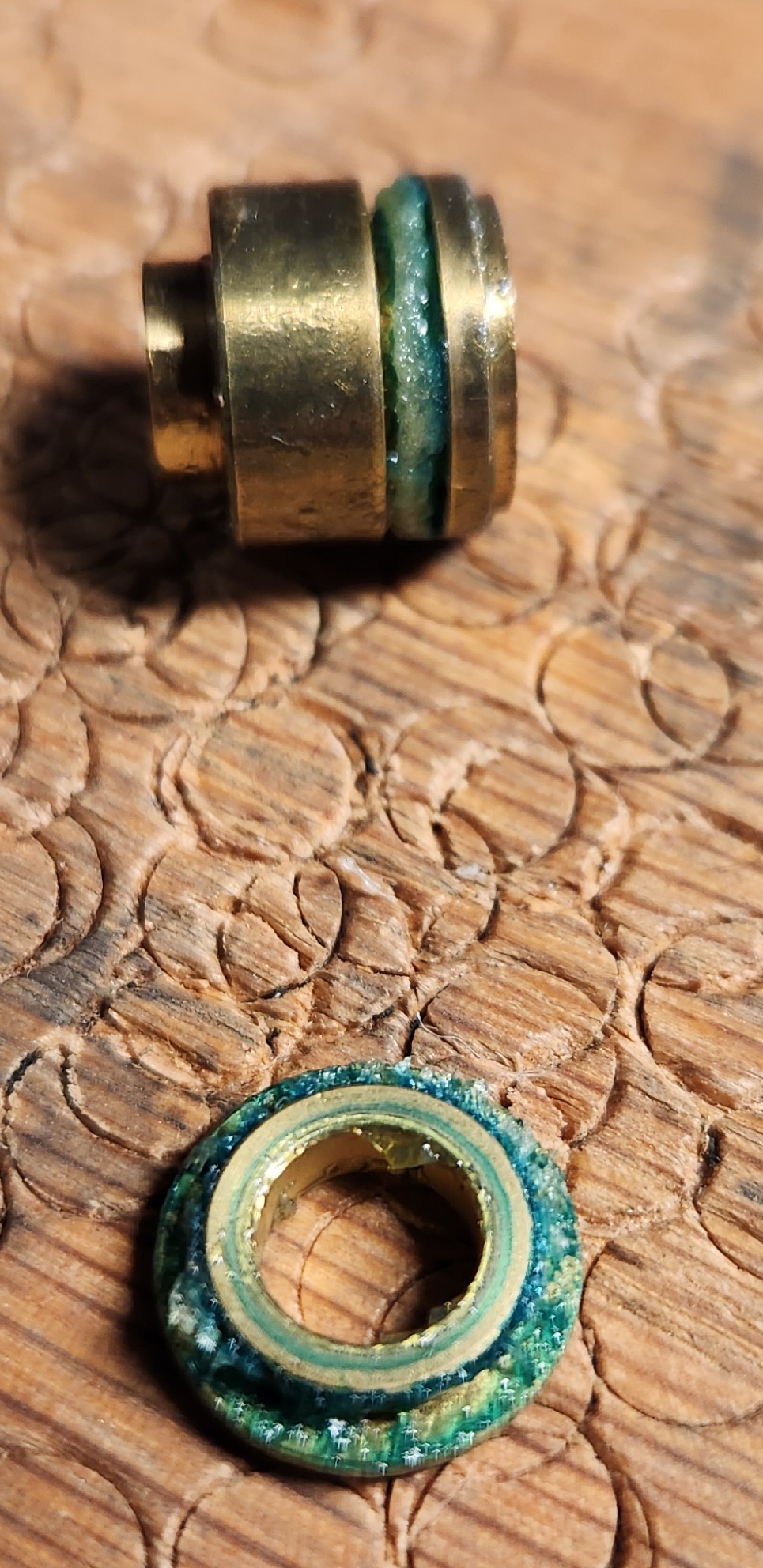

              The valve leaked when I first aired it up. When I got it broken down and tried to get new seals in there, I was met by a bunch of green hardened goo, sorta like someone poured blue lockitite over the seal on the valve cap.

ID:	794909 As I progressed, I found the front and rear seals disintegrelated with what looked to be the same goo.

              Its sticky and thick, Like epoxy that has just started to set up. I scraped most of it off, and am soaking it in solvent to see if the parts can be salvaged. Does anyone know what this chemical damage is? I have broken down several tippmann valves now and never found this type of damage
