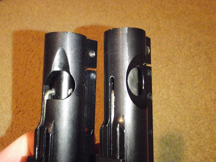

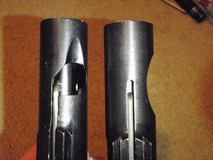

        My F/A had same internals as all my Pro Lites, only difference of course is the piston setup on the top rear of the receiver. Safety is totally different to properly actuate the sear in different fire modes. The feed opening on right of the receiver is different and possibly further forward than the Pro Lites. I too am brain storming a better feed scenario for mine

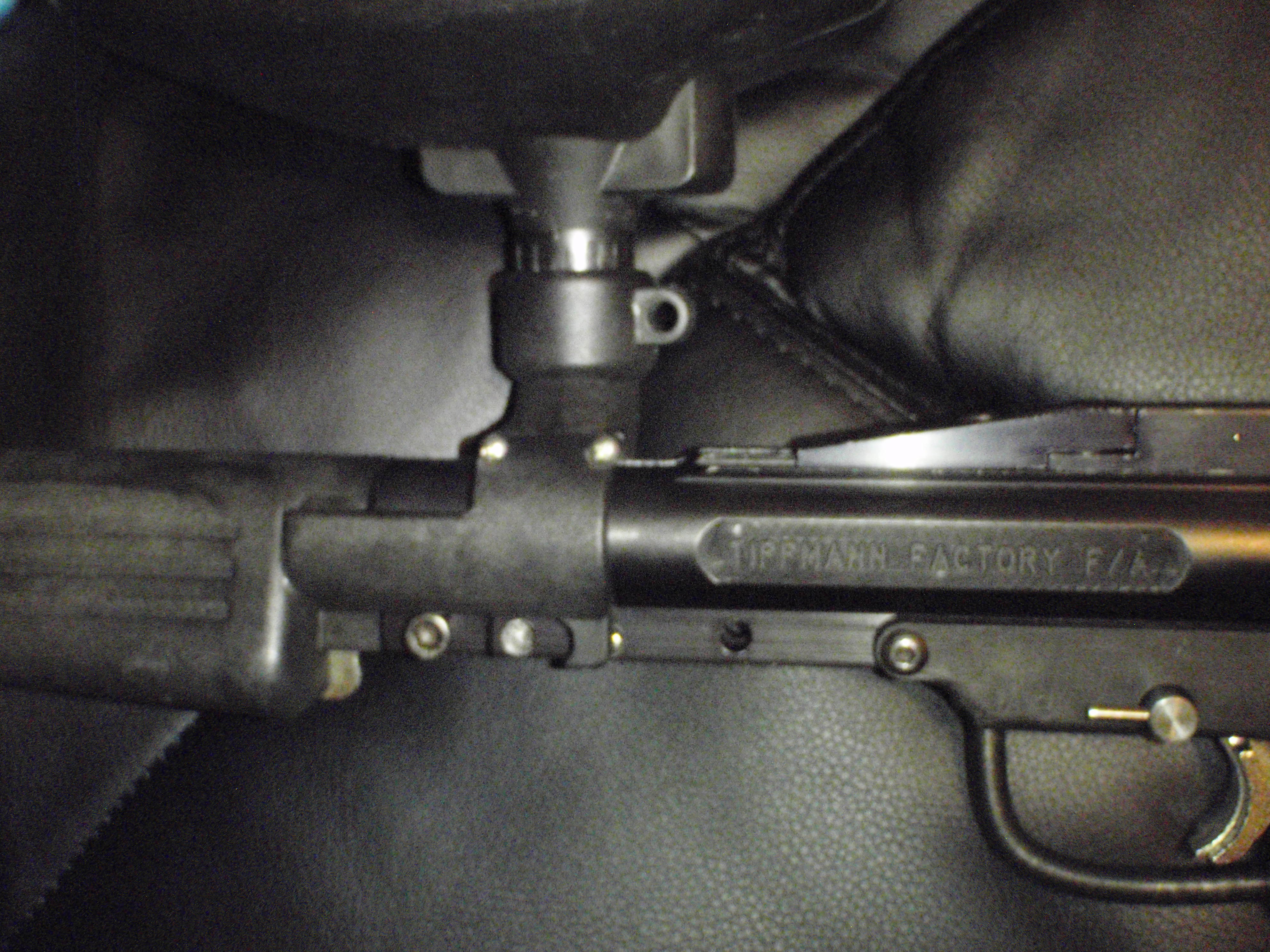

      It appears that the new cyclone fits the marker physically but will require being tapped for the 2 mounting screws instead of the current single screw mount. Additionally, it requires air to operate. I have considered a Rip Clip, but mounting seams a little tricky. There is no top rail to clip to, and the bottom screws may impinge on the battery or drive parts of the Rip Clip. I'm sure there are a host of other rapid feed systems that may be grafted on. I'm open to ideas.

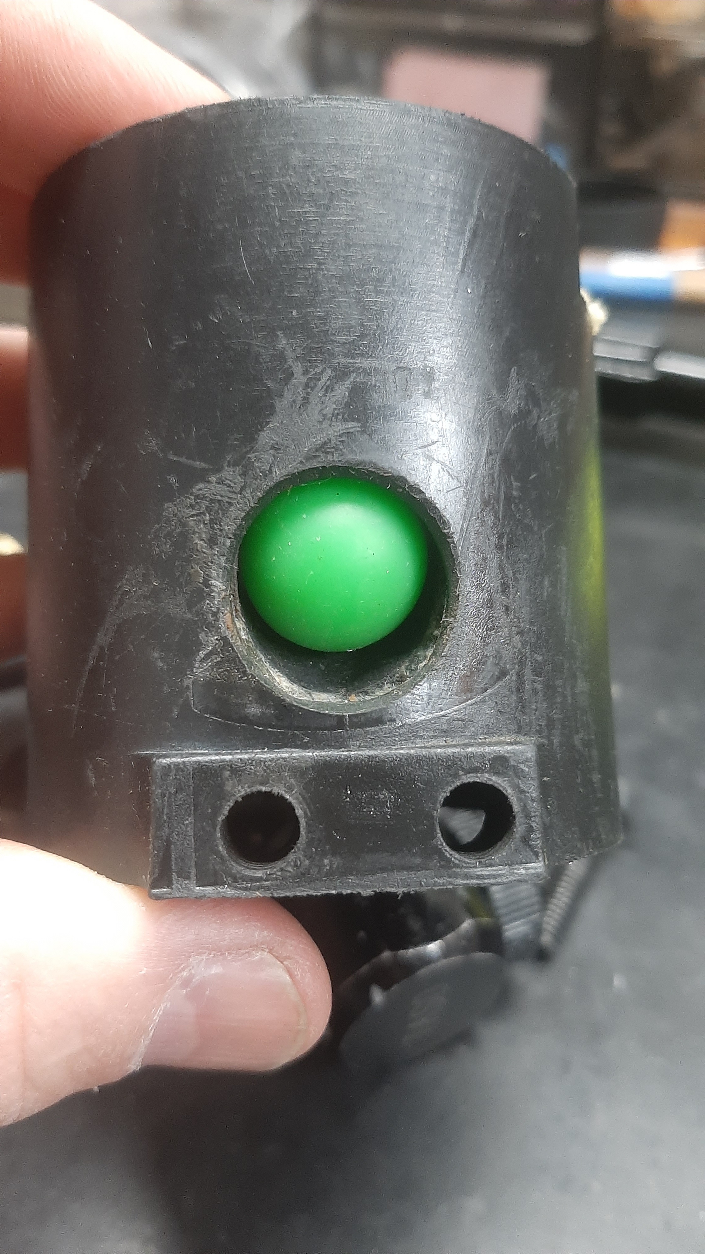

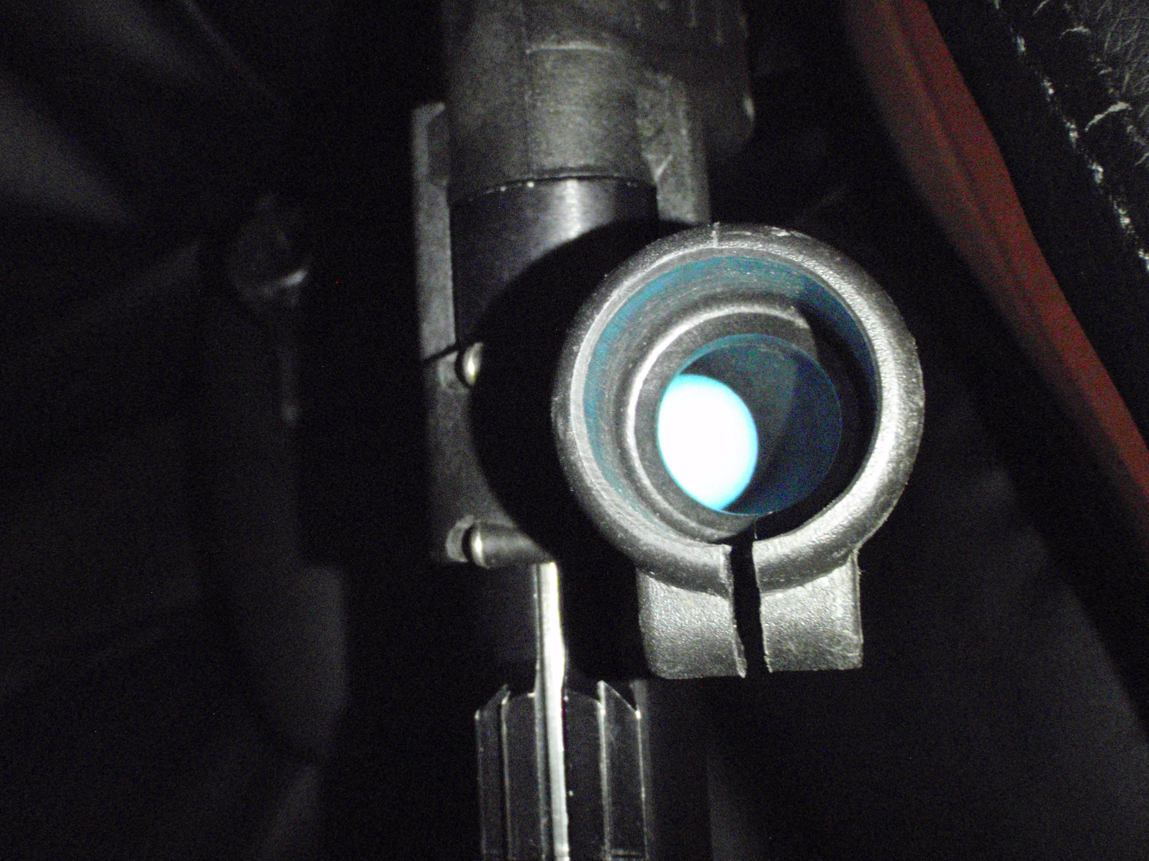

        I would not recommend the modern gas powered cyclone. There would probably be an issue with the velocity due to loss of pressure overall. Also it would be a pain to add a separate air line for the cyclone. Maybe that could be ran separate to the ASA? I've added a Pro Lite fore end to mine and it fits - but the feed neck does not align with the orifice on the receiver. I believe this could be dremeled out a bit to work but I don't have a junk fore end I wanna hack up at the moment. Second image is a training ball stuck right above the feed opening - rubber training ball, smaller than normal .68

          Nice solution to a difficult problem. I am sure I have a spare Pro Lite fore end if you need one. I am partial to a lower profile setup than the standard E feeder on a feed neck. I have the playing style of a near sighted sloth; invisibility is my only hope of not being repainted FPO colors.

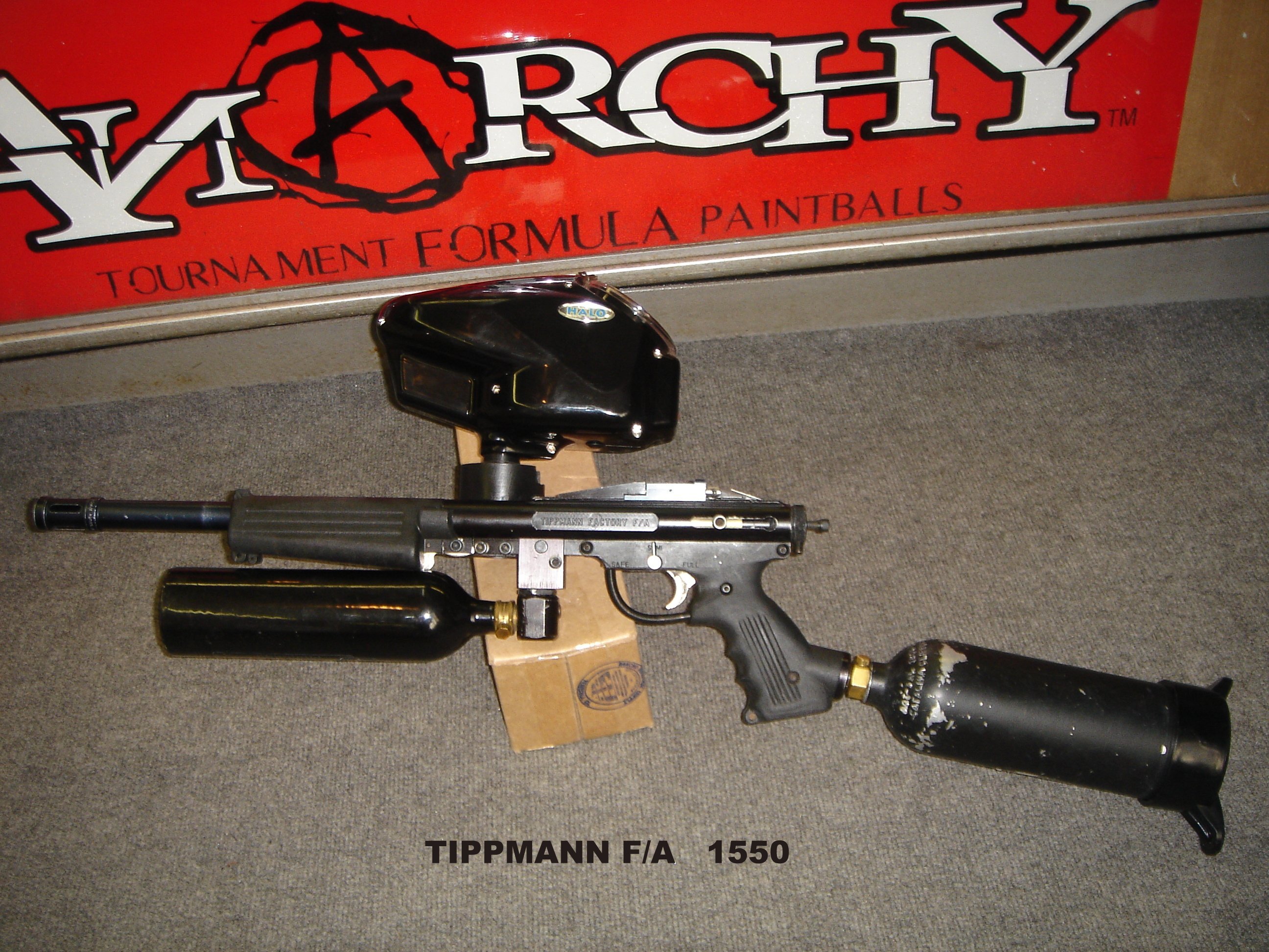

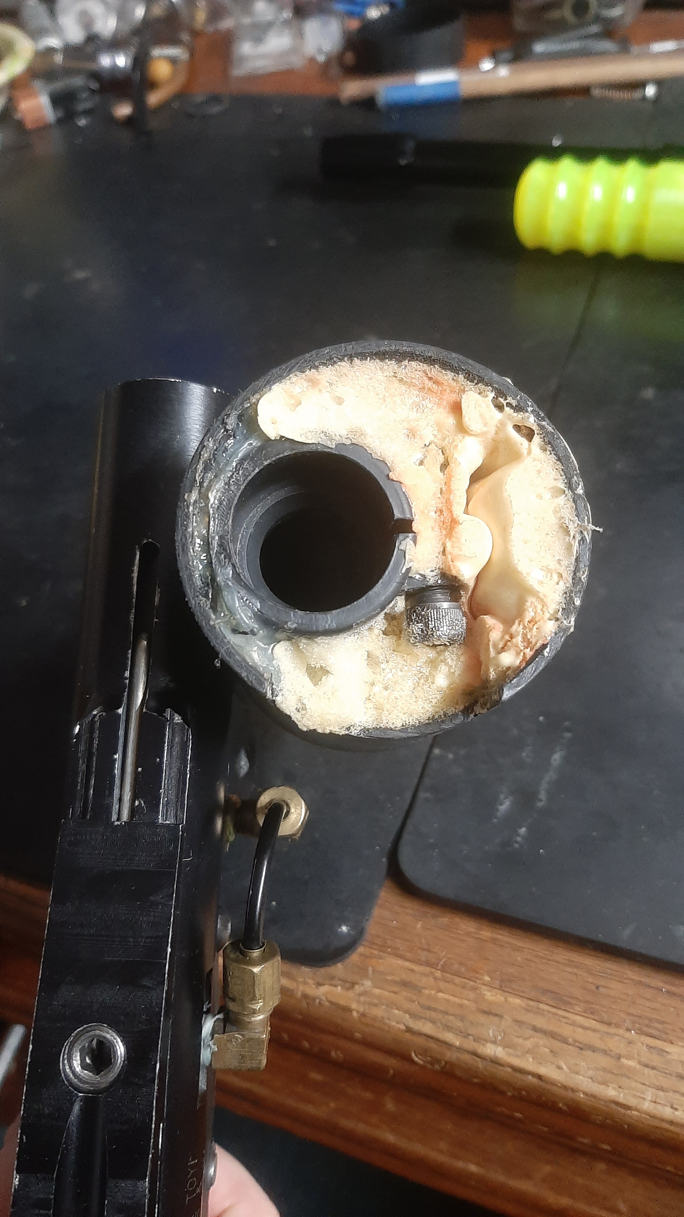

            So a bit getto. But i use syphon on the Fa so cyclone was not an option. I did this mod over 15 years ago and it still works. Took a 98 feed elbow and ground it down untill it fit in the empty feed, then filled the rest of the cup with hot glue. Halo works great. TPI F-A.jpg

              Ah this is great, thank you for this idea. I didn't think 98 feed elbows would slide on and lock in place with FA or Pro Lite bodies?
          • capitalpaintball
            • 310
            • Coventry, Rhode Island
            I said ghetto. Hot glue and expanda foam
            • C26G
              C26G commented
              Hott damm! That is the original FA cyclone housing? I think someone said the newer housing screw holes won't match up
            • capitalpaintball
              capitalpaintball commented
              Yes its the original housing, spring died long ago.

              Could a plate be made similar to the adaptors used to put rip clips on Tippmanns?
              • COB
                COB commented
                Get out of my head! You are reading my mind. Once I have full use of my left arm again, I will be working on something like that. Of course, at that time I will have to refer to your FA rebuild thread to ensure that everything else works.

              As someone else said, the Pro Lite feed port is at the 1 o'clock position on the body, the F/A port is at the 3 o'clock. So, I won't even bother cutting out any Pro Lite forends, not much material there to work with. We will figure this out eventually
