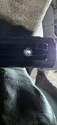

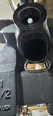

    Step 1. Use a carbide burr bit for a Dremel and file down the hump on the plug on top of the body above the valve chamber so it's flat to accurately center punch on the pin.
    Step 2. Use a 3/32 drill bit and go extra slow and drill down the center of the plug. let the weight of the drill take it down or if you go too fast the bit will go off course. You're going to need some good steel drill bits to make it through. Once that's piloted out proceed to step up one size at a time to a 13/64 drill bit. When drilling down into the grip go a little at a time. There's no hurry in connecting the two holes. You can't take it back. I had to braze a hole shut due to rushing. Make sure to keep clearing the shavings. I noticed while drilling this aluminum it plugs up the bits really easy and throws the bits off course.

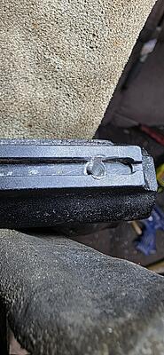

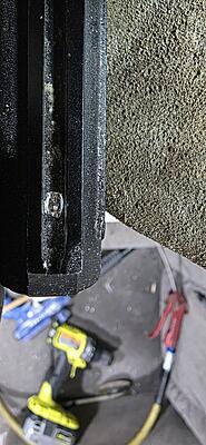

    Step 3. Begin drilling the hole through the grip towards the valve chamber. Start with a 1/8th inch drill bit and move up every step to 13/64, same procedure. Drill a little at a time and clear the shavings. Eventually you'll reach your hole through the top. If you go too far too fast you'll drill right through the grip. I use a curved diamond file to clean up the holes inside the valve chamber so it doesn't cut o-rings
    Step 4. Tap the upper valve chamber hole with a 1/4-20 tap and go a little at a time clearing the chips out of the hole. It keeps from chewing up the threads. When tapping the hole stop just before the bottom of the hole. Install a 1/4-20 set screw and use red loctite (the devil's anus) to seal the threads. It never needs to come back out. I've also used a 2 part high psi epoxy.

    This gallery has 5 photos.

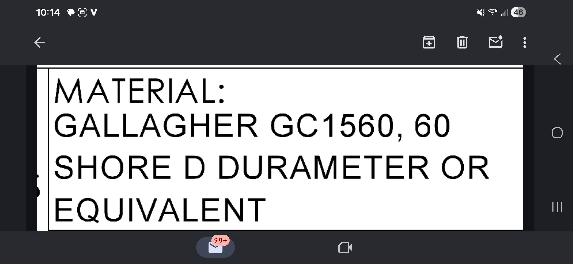

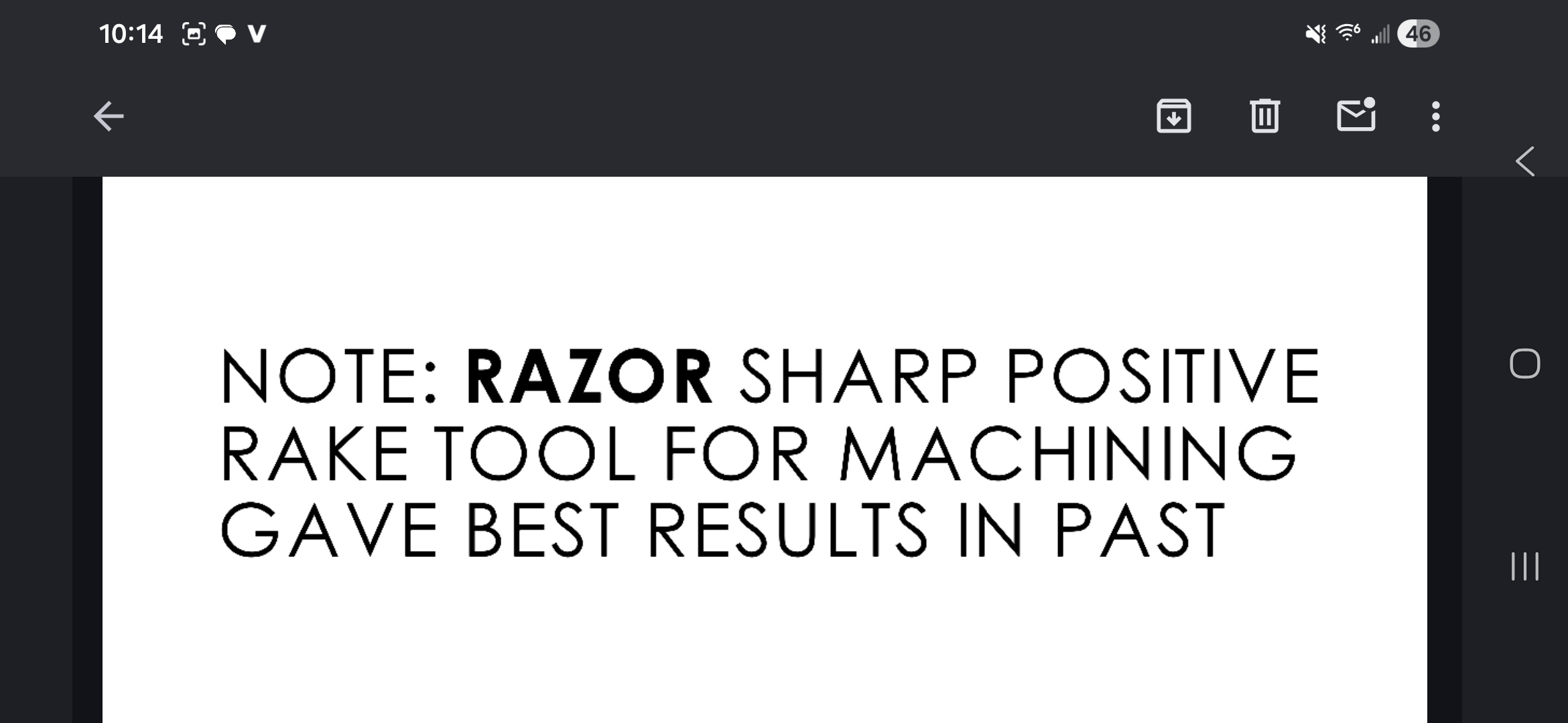

        SUCCESS! I contacted tippmann parts and tipmann themselves. They did some digging through the history books and found the info! Ill share it for anyone wanting to machine them. I also contacted Gallagher the company who makes the product and they have a 500.00 minimum purchase. The guy also while digging found 6 full valve bodies with cup seals that they're sending me. I told him there's a decent demand for them and they were more than willing to help keep them alive! So happy.

          Good work man. Did that dude have any more Cup Seals for sale?
        • Boomboom
          Boomboom commented
          No he didn't I'm not ready to make them yet. Also docs machine said he would make a bunch of them when he has time. I provided him with the specs

          I have acquired a lathe. Im attempting to make some cup seals this weekend. We'll see how it goes. If all goes well I'm going to try and make a hundred of them

              Well. I tried to make some cup seals this weekend. I searched everywhere besides Gallagher for the 60 shore d and no one has it. I ordered some 75 d and made a few cup seals. I installed it and it's too hard to seal. It has to be 60 shore d from Gallagher and they have a 500 dollar minimum purchase. I'll have to wait till I get the cash to buy that much material

              I have some other plastic rods that are softer that I'm planning on trying. I threw in the flag for the day. I'll be trying again. I'm going to get this.
