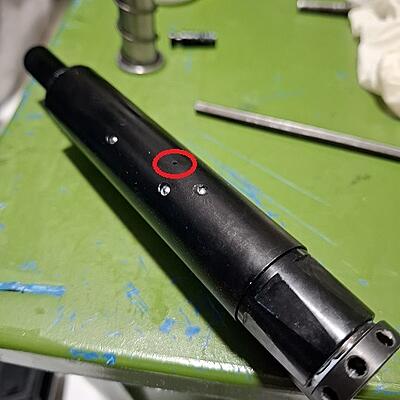

    I have two X7 Phenoms not working, each of them with a different problem. I'll call them Phenom A and Phenom B...
    Phenom A: it is not leaking when I gas it up but when I pull the trigger, the air vents thru the hole at the photo. Seems that some part should be moving inside but it's stuck (all internal parts are lubed);
    Phenom B: as soon as I gas it up, it leaks thru that same hole and it doesn't shoot when I pull the trigger.
    Does anybody know what could be happening on both guns?

    I have zero familiarity with that marker, but I did glance at the manual and that Power Tube Assembly has a number of o-rings, so my guess is that one or more need replacing. You can replace them one at a time to see if you can isolate the bad one or just replace them all. I’m guessing that’ll fix the issue. For me, I’d replace them all since they’re likely all the same age/usage and just for the peace of mind knowing they’re all fresh.

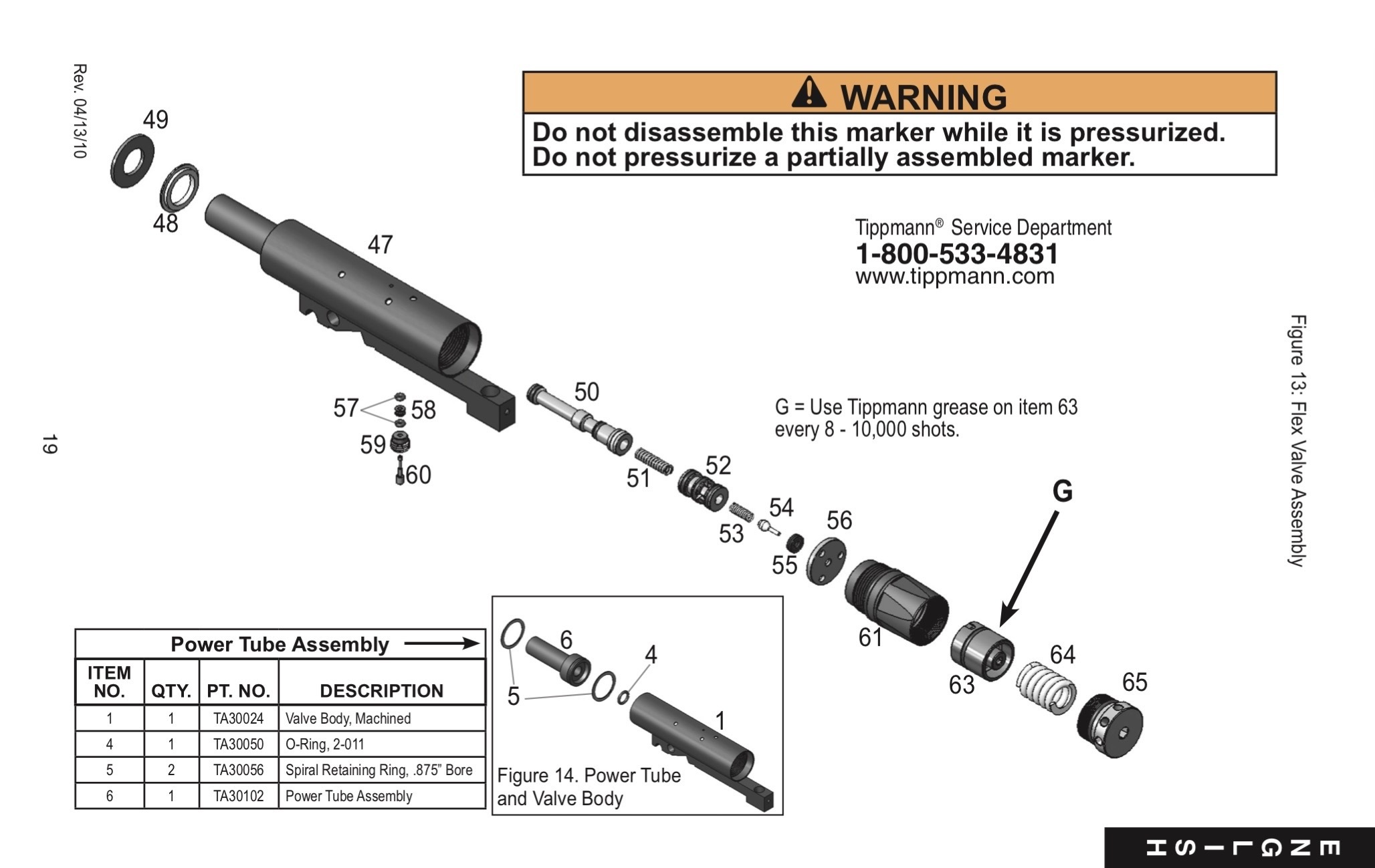

        I've worked on phenoms a fair bit, but I've never gotten all the way into them. That said, cross referencing that exploded view and the cutaway on zdspb gives me some idea of what's happening.
        Pretty sure you need to replace the o-rings on both part #50 and #52 seen on that diagram above. I agree with G-FOURce that it's probably worth replacing all the orings while you're in there. I know the trigger pin and that stupid cross pin are pretty sensitive on phenoms, I'd check them as well. Make sure they're not bent.

          I've replaced ALL o-rings but still got the leak. After I opened the thread here, I was wondering if the problem is actually the o-rings replacement. Seems to me that the new o-rings on part #50 are causing too much drag. Part #50 has to move freely so the air can go from a chamber to another and make the system shoot the ball. I'll try smaller o-rings to see if I can get less friction but still a good seal...

                          • 6182
                          O rings #57 are your likely culprit. From the factory those are polyurethane but a lot of kits just use buna. Buna can be used with the understanding that it causes a little more friction. I've found that polishing the pin (#60) can really help if you have a good way to polish it. Others mentioned bent pins, roll it on a table to see if anything wobbles

                            On both guns the #57 o-rings are original polyurethane. If I got how the gun works, these o-rings just seal the pin when it moves up and down. My doubt is: are they guilty of not letting the air to flow to the firing system?
                              What happens if over time the polyurethane gets gummy and then sticks to the pin, when that happens and the pin can't return to its starting point then the whole marker can't reset after it fires.
