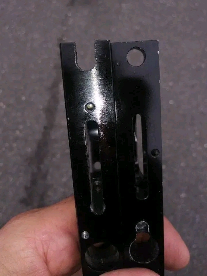

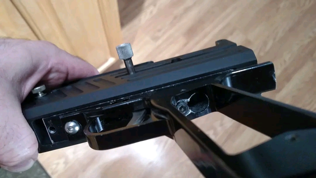

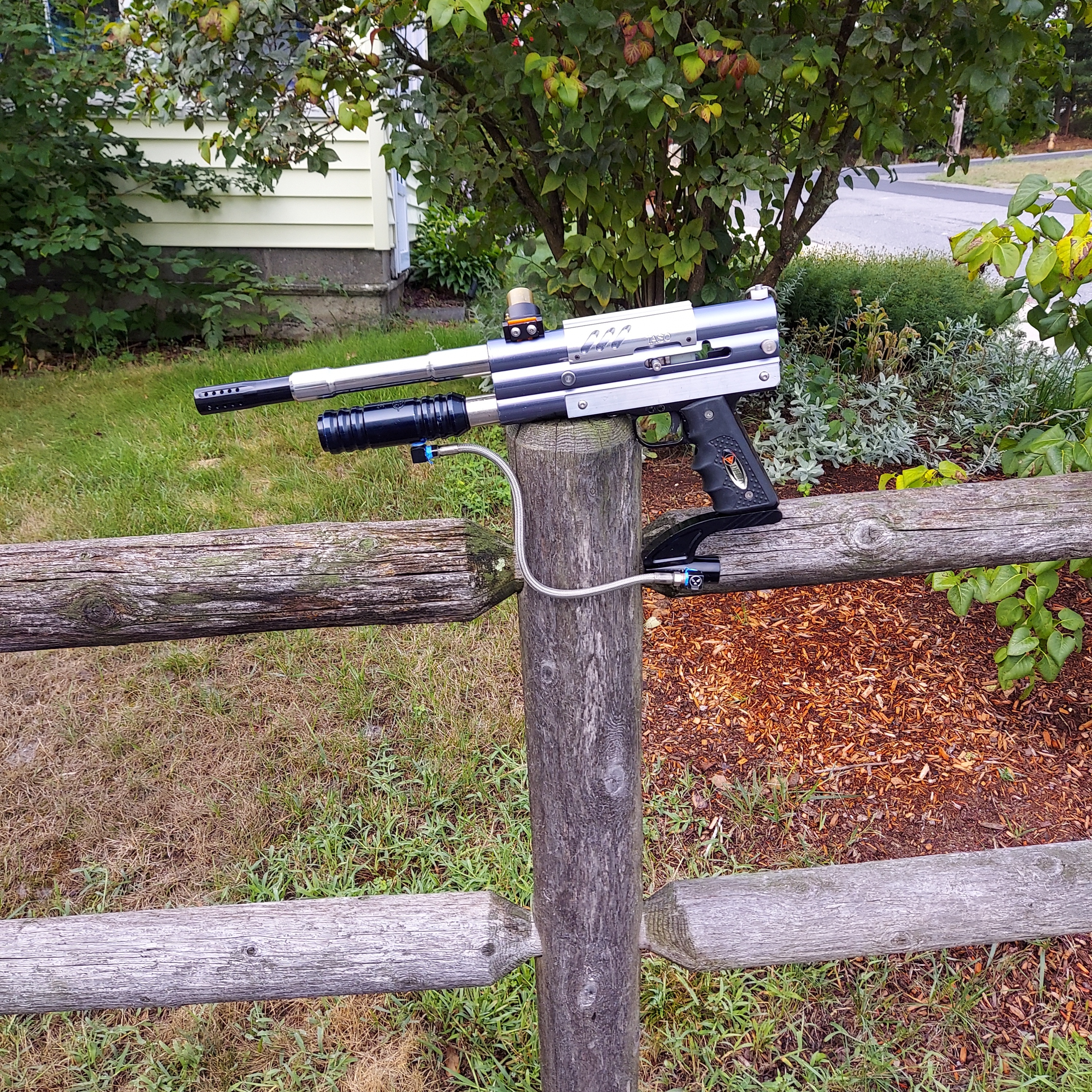

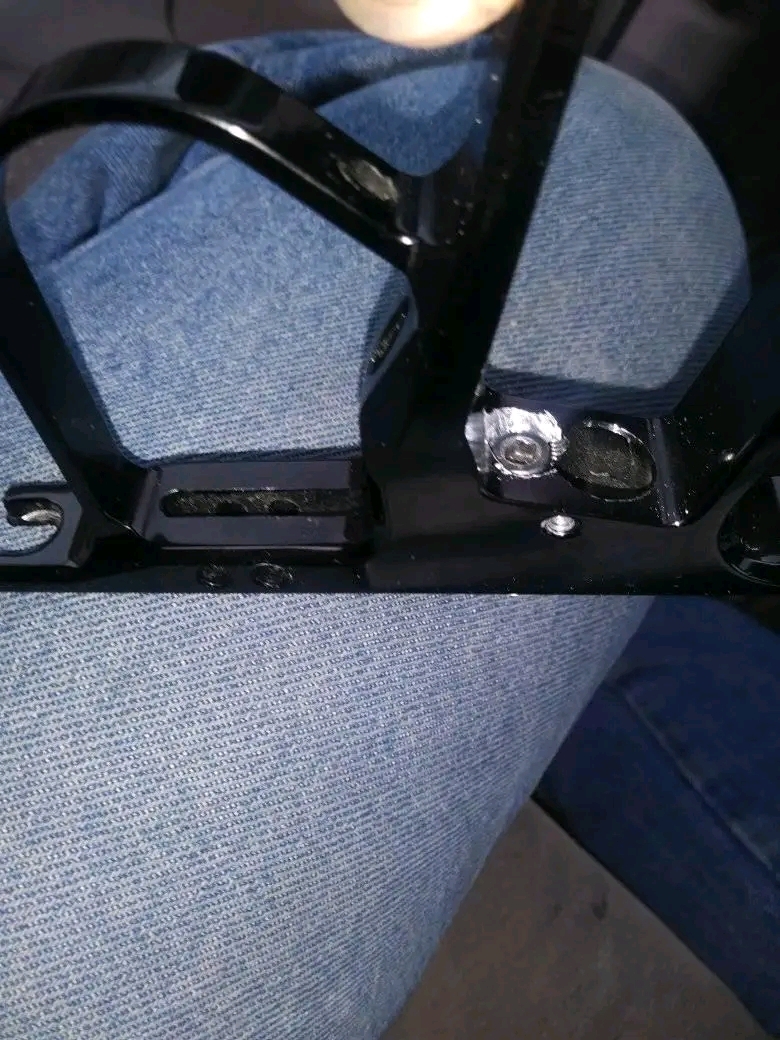

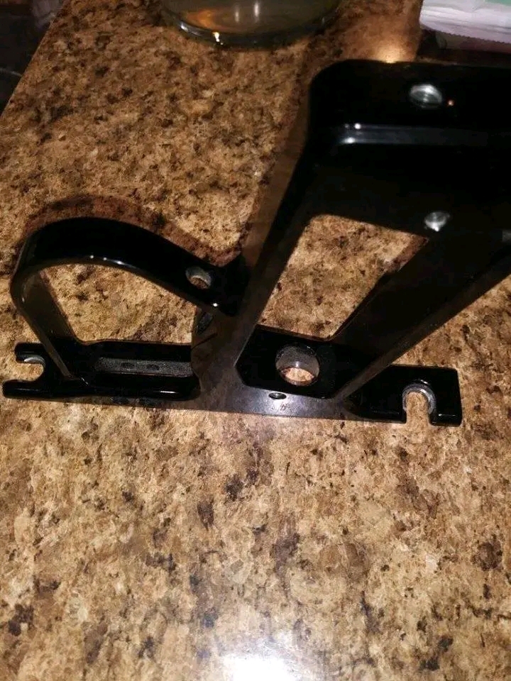

    If you love your VMs like I do but you hate the grip frame options that are available then do what I did..... Use a Shoebox Shocker or Impulse frame and mod it to fit. I borrowed the idea from the Carter Machine VMs he did since I used to own the VM Space Gun which was done by him.
    It's a fairly simple mod to do too all you need is the frame a drill some drill bits and your basic Allen wrenches. So all you do take off your grip and drink your garden from your stock VM take the frame and line it up (the frame itself will slide right over the stock trigger unless you have one of the old black triggers then you need to grind that trigger down first or widen the slot in the frame first), the front frame screw will line up perfectly with where the rear trigger guard screw would go, all you do is take your trigger assembly off line up where the grip block would go and drill one hole down through the frame where the grip block would mount and use a longer screw to mount it to the marker and that's it .....You now have a full .45 frame on your VM. If you used an Impulse frame (or Shocker double trigger frame) all you have to do is throw on a double trigger if you use the Shocker frame single trigger you don't need any trigger shoe at all.
