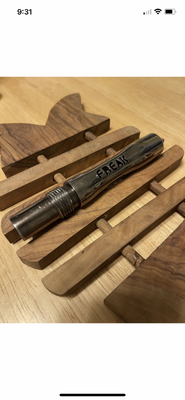

    Angel Barrel Threads
    Can anyone tell if this freak barrel will fit a G7 Fly?
    Doesn’t really the thread type in the listing.

    I am pretty positive it will not. That looks like old angel threads (LED,LCD, etc.) I have an 06 speed and I believe it has the same threads as the G7 and they are very different.
    I am a bit confused as this says the Angel G7 and G7 fly have different threads.

      Thanks, I was thinking the same thing. I believe the g7 and g7 fly do have slightly different threads. I believe one will just have some extra threads showing, or something like that. Not positive in the details tho

        Here’s a good summary from Enoch Paintball.

          that will not.. that barrel thread fits everything made BEFORE the G7 Fly
