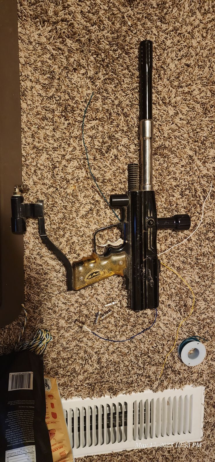

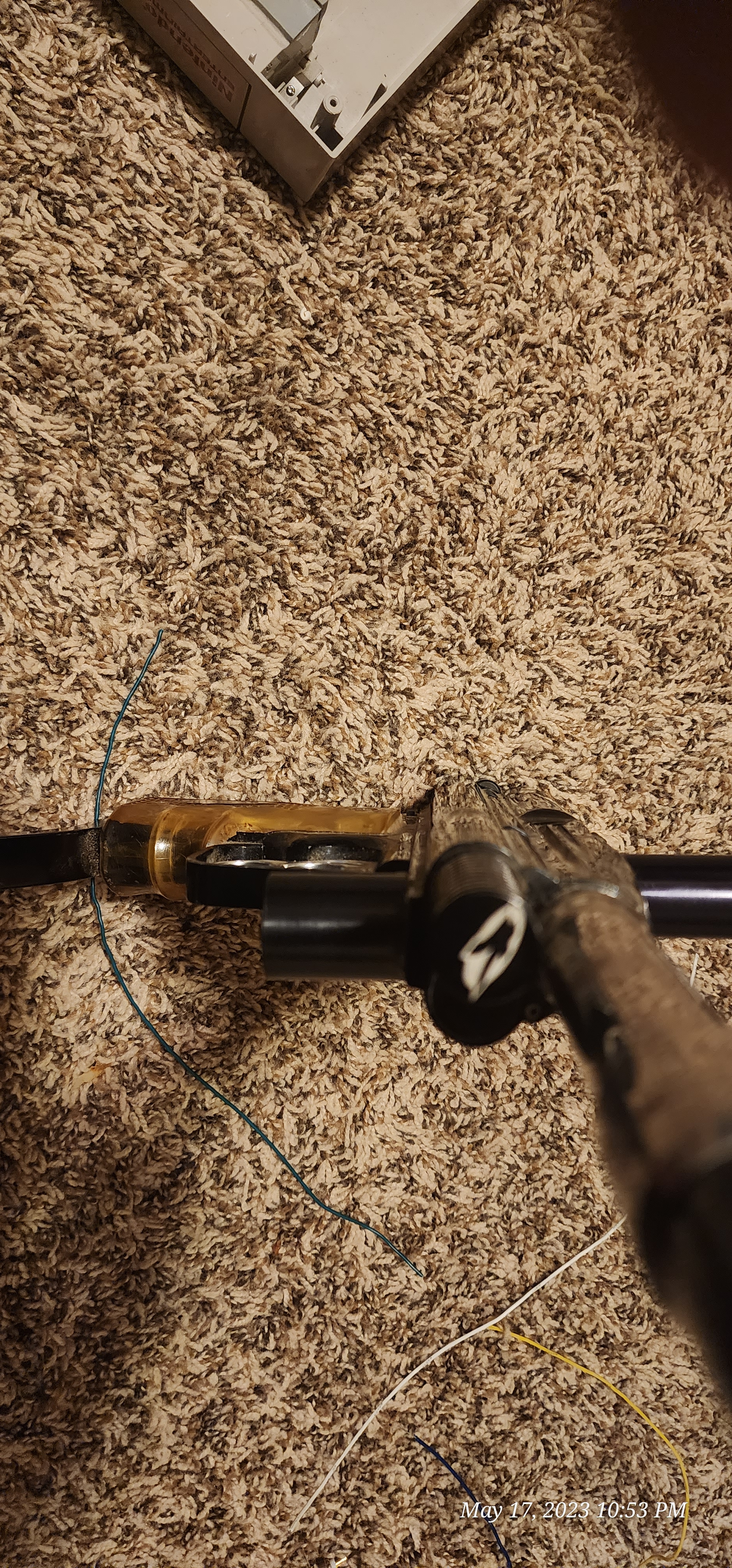

          I realized that I may want to upload a couple pics these are not great photos but they are of the marker in question.
          • Super Nova
            Super Nova commented
            Pretty terrible, better just send it to me lol

          Originally posted by s5lin
          I'm kinda in the same boat as the OP. I just got an old LED, and where is the Estilo tech that you mentioned in So Cal for angel work?
          And because I am a newbie to LED/LCD/ IR3 gen guns, why can't an LCD solenoid be used in a LED? I didn't think these 2 generations went thru as drastic a change vs the IR3, asking cause looking to know all I can about the older WDP guns
          The LED solenoid housing is very unique. See below for an old Warpig picture.
