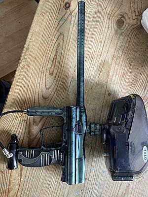

    Angel speed 05

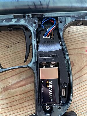

    Please could anyone help me with adjusting my speed 05 so that it rips as many balls as possible. I’ve no idea what the manual refers to when it says check the software. I look at the led for the software and it’s red but has no meaning. I just want this to be able to shoot as many bps as possible on this original board for now until I can source another board in the UK.

    Iirc 05 speed boards had no rof adjustment option

      Ok so I’m guessing I have to purchase a board that gives me the option to do this.

          Set the highest trigger offset. Depending on software, it will be all LEDs lit, or all but one depending onsoftware. Later boards with all lit is psp capped at 15. Increasing trigger offset to max will be uncapped "semi", but it's more like uncapped ramping
          • Woowoobeer
            Woowoobeer commented
            Thank you I’ll take a look see which led’s are lit and set accordingly.
