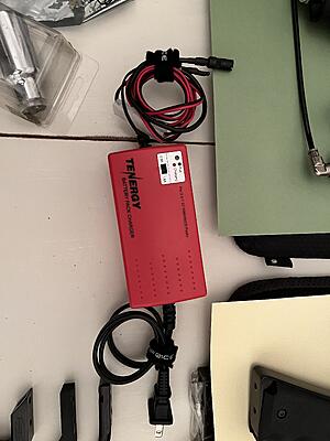

        I made a LED charger with an Amazon charging station and a intellifeed cable. I’ve been making cables and plugs for decade so don’t try this at home unless you know how to solder. It possible. I’ll look for a picture.

          Whoa, I actually found a picture of it. Here you go. I’ll help you out, or ship it to me and I’ll wire it no fee.

            It worked flawlessly.

              https://power.tenergy.com/tenergy-sm...RoCWwAQAvD_BwE

                I’m not sure about the itellifeed pass through wiring you mentioned. Check it with meter/probes.
                It should be the same Except you plug into the top rail instead of the back, try both, the smart charger will tell you when it sees a battery.
