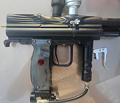

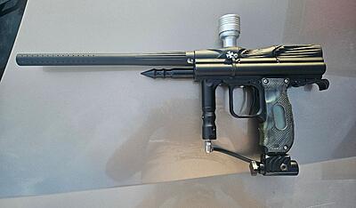

    Speed demon drilled for eyes
    This gallery has 3 photos.

    Thats supa sick, I love this era of angels

    Edjumicate me please. From your post, I would assume that this particular Angel did not come with factory eyes straight out of the box.
    As you can tell, my knowledge about Angels is limited. To me it looks like factory installed eyes, so presuming it is an aftermarket mod I am suitably impressed.

      Yeah the 03 speed never got eyes, the very first to get them was the a4 fly. Also yeah it's a very clean install, I feel like most of the angel eye mods I see are old epoxied eyes

    Yeah I was told the eye job was master tech, master tech fly'd eyes and a master tech trigger

      That's definitely what was done here. The WDP Master Techs used all WDP parts and the conversion was fully supported/warrantied by WDP. The "eye covers" are modified Angel AIR leaf springs that they milled to fit around the detents, and the eye wire covers were from the A4 Fly but had been cut down. They also milled out the underside to route the eyes and covers.
