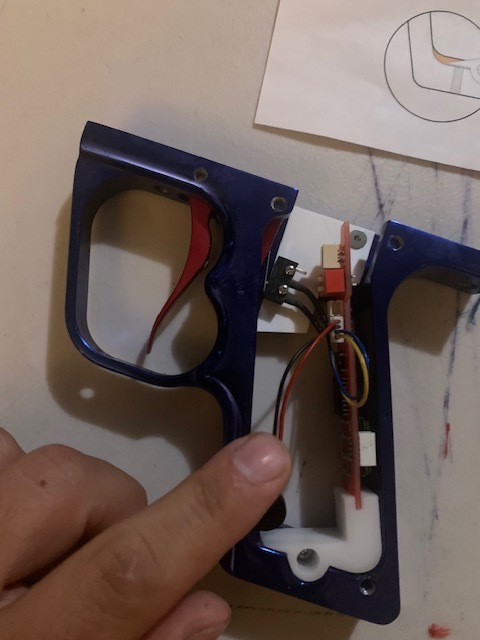

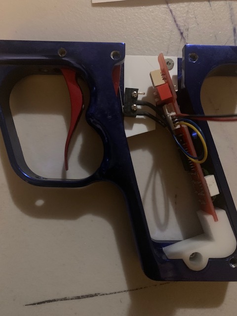

ID:	863431 3mm x 8 mm pins sourced from Amazon did not quite fit so I had to take a drill bit to my trigger and frame. The trigger itself fits super tight in this frame- not sure if it's from the plating but it's got some decent movement right now time to source some 4-40 screws and mount this switch!
    • screwloose45
      screwloose45 commented
      Those frames trigger pin holes were too small due to the plating. The black ones didn't have the issue
    • RustyShackleford
      RustyShackleford commented
      I figured it was from the plating I'm gonna try and make it work anyhow, i love single trigger setups!

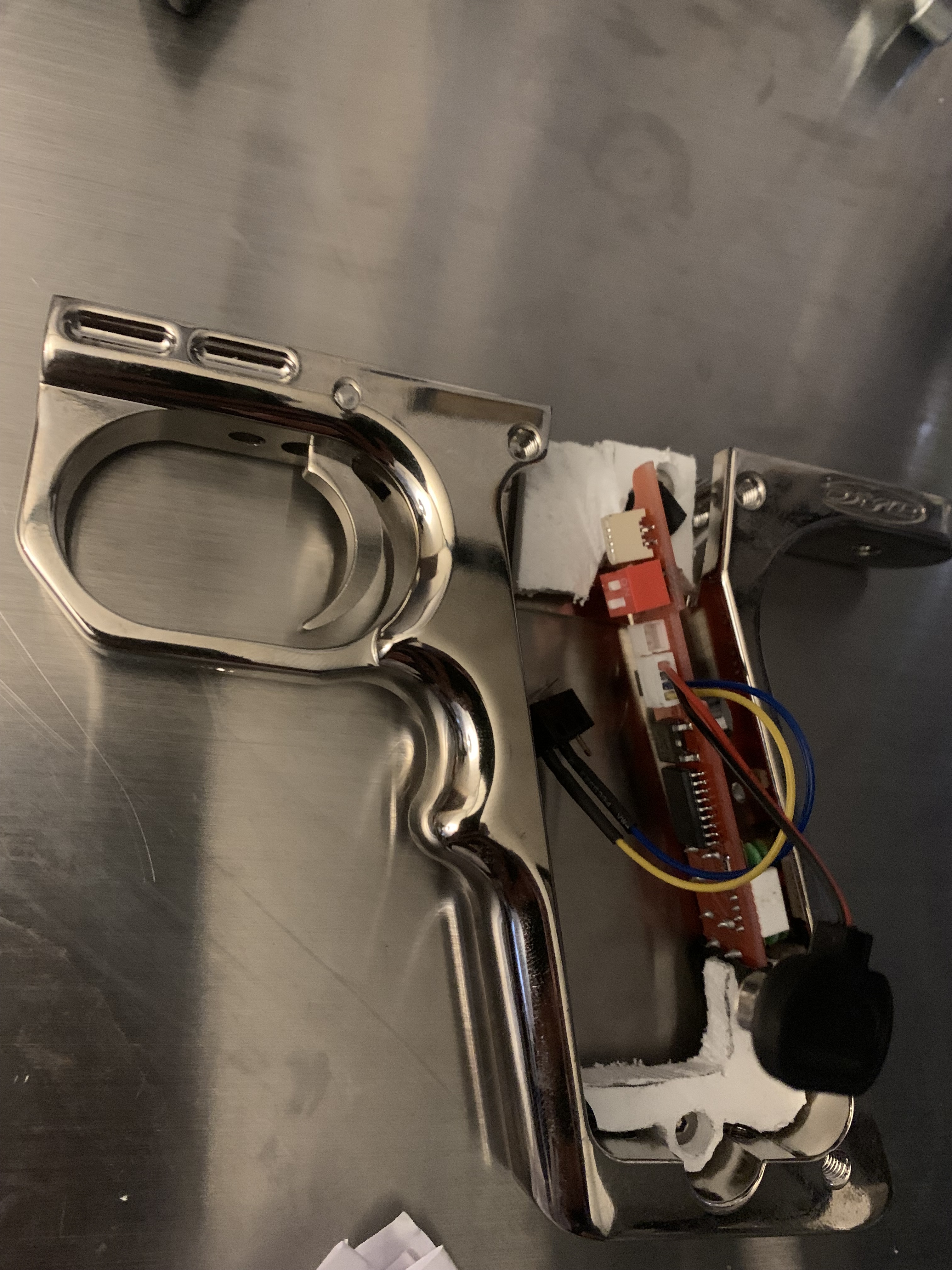

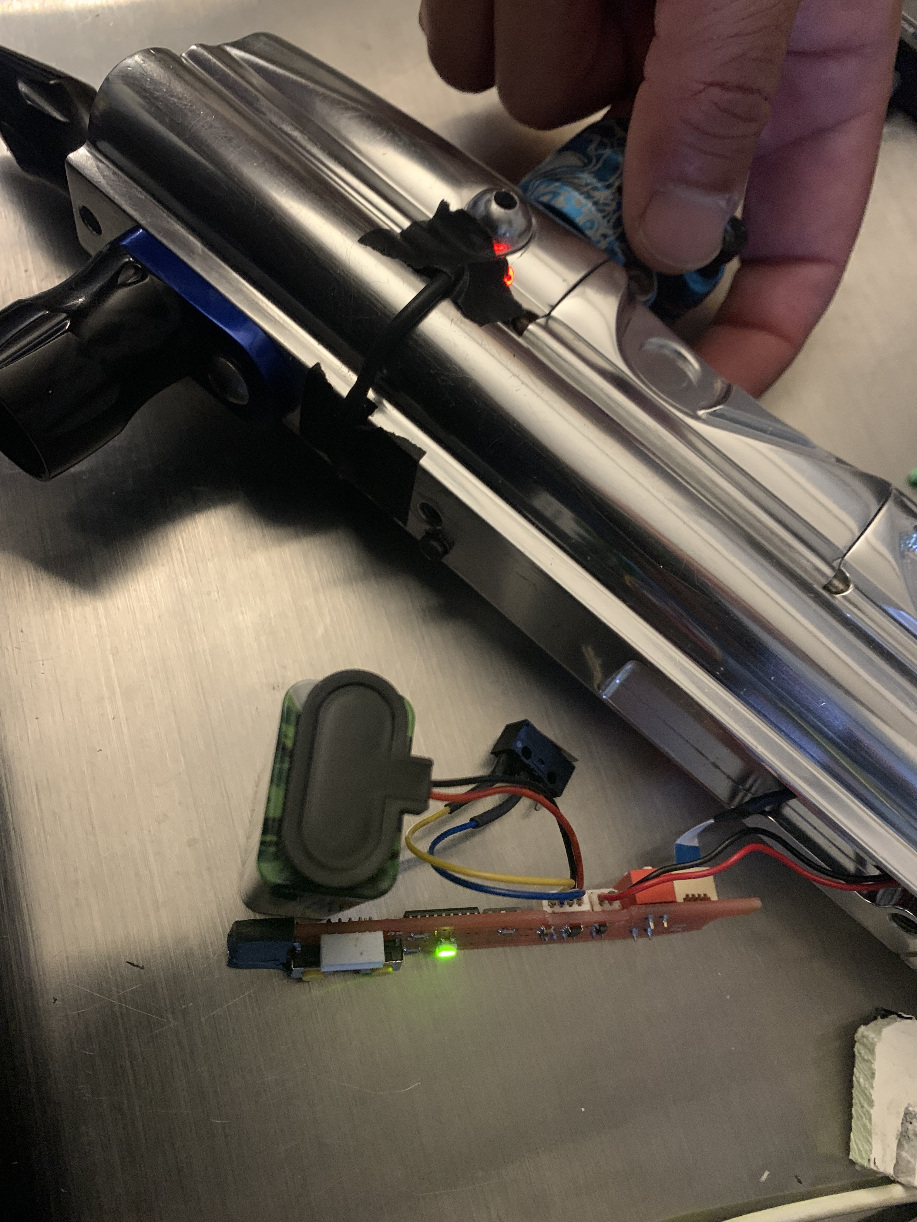

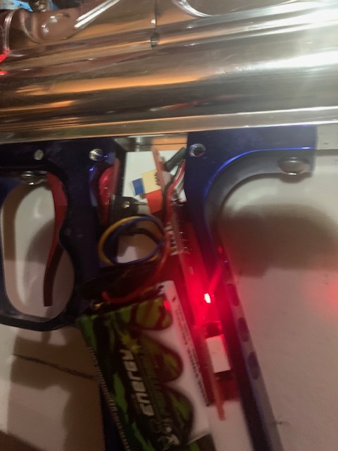

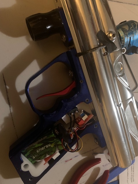

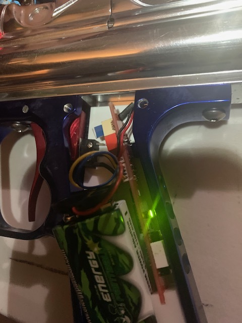

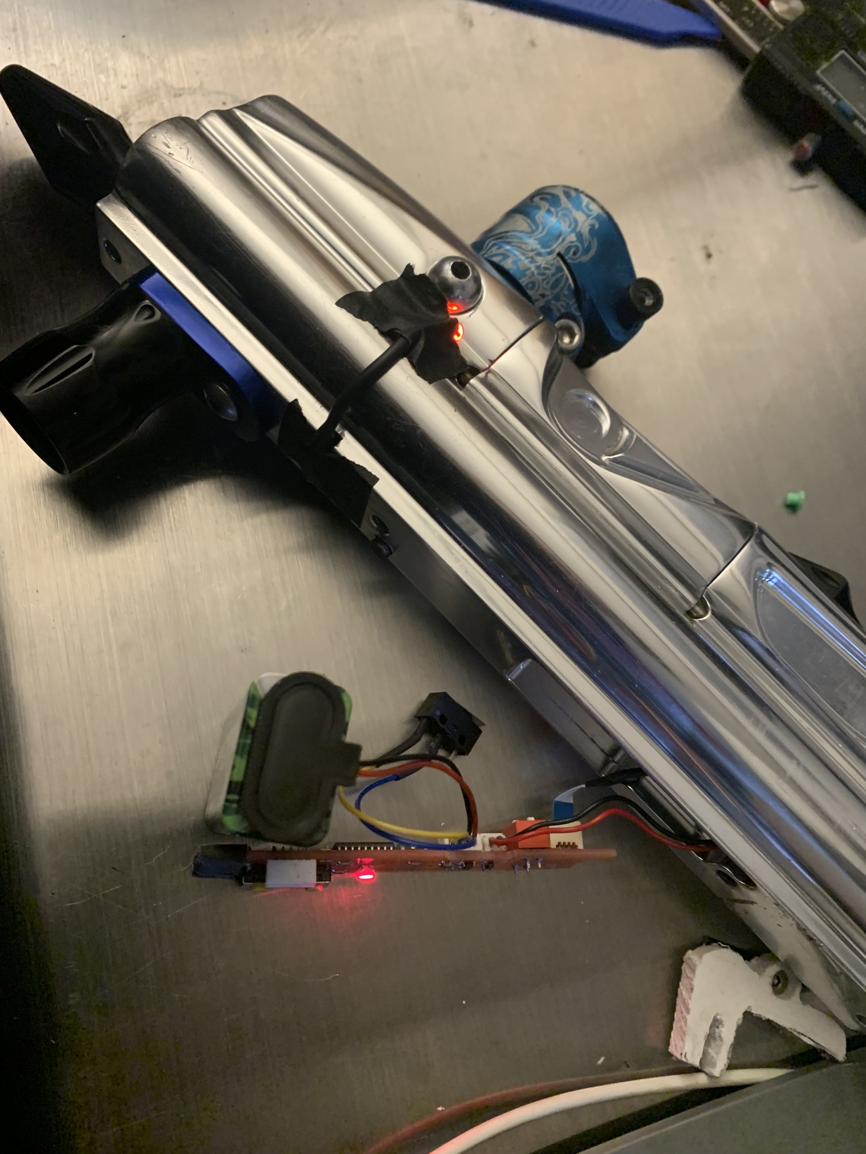

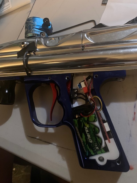

          Ok, i went back to my brothers frame- as much as i liked the chrome single trigger, i could use the money for bills and such. I broke down and got a LCD mount from a guy on ebay. Absolutely worth it- i know its not DIY but it makes mounting the switch better.

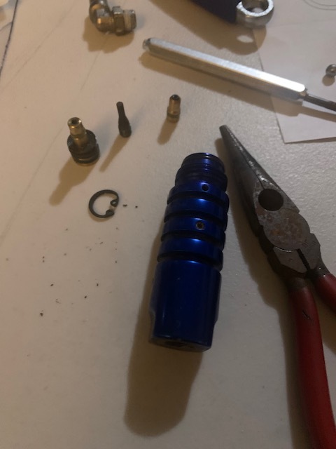

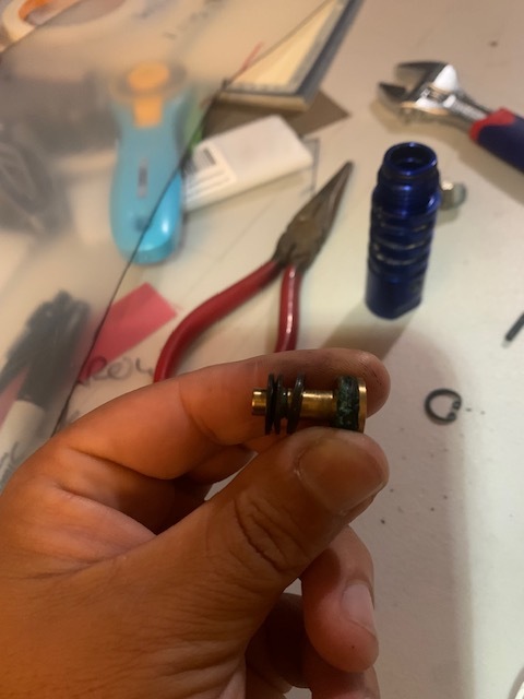

          Dr Strangelove on PBnation hooked me up with some angel eyes that are a wee bit longer than usual so i can plug it into the ribbon into the PM7 board! So this morning i got it all hooked up and took apart and serviced the mini-reg. Pretty incredible some of the Orings were still good, i just had to change one.
          Click image for larger version  Name:	IMG_1342.jpg Views:	0 Size:	53.3 KB ID:	872679 Click image for larger version  Name:	IMG_1343.jpg Views:	0 Size:	53.8 KB ID:	872680 Click image for larger version  Name:	IMG_1346.jpg Views:	0 Size:	61.6 KB ID:	872682 Click image for larger version  Name:	IMG_1347.jpg Views:	0 Size:	68.8 KB ID:	872684 Click image for larger version  Name:	IMG_1348.jpg Views:	0 Size:	45.6 KB ID:	872685 Click image for larger version  Name:	IMG_1349.jpg Views:	0 Size:	50.6 KB ID:	872686 Click image for larger version  Name:	IMG_1351.jpg Views:	0 Size:	92.0 KB ID:	872688

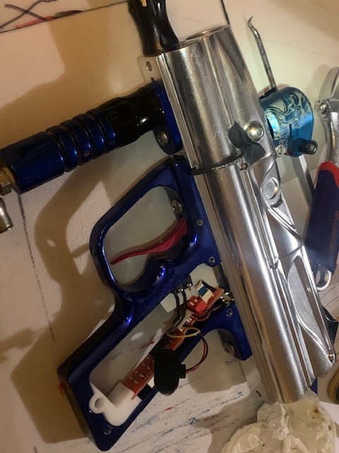

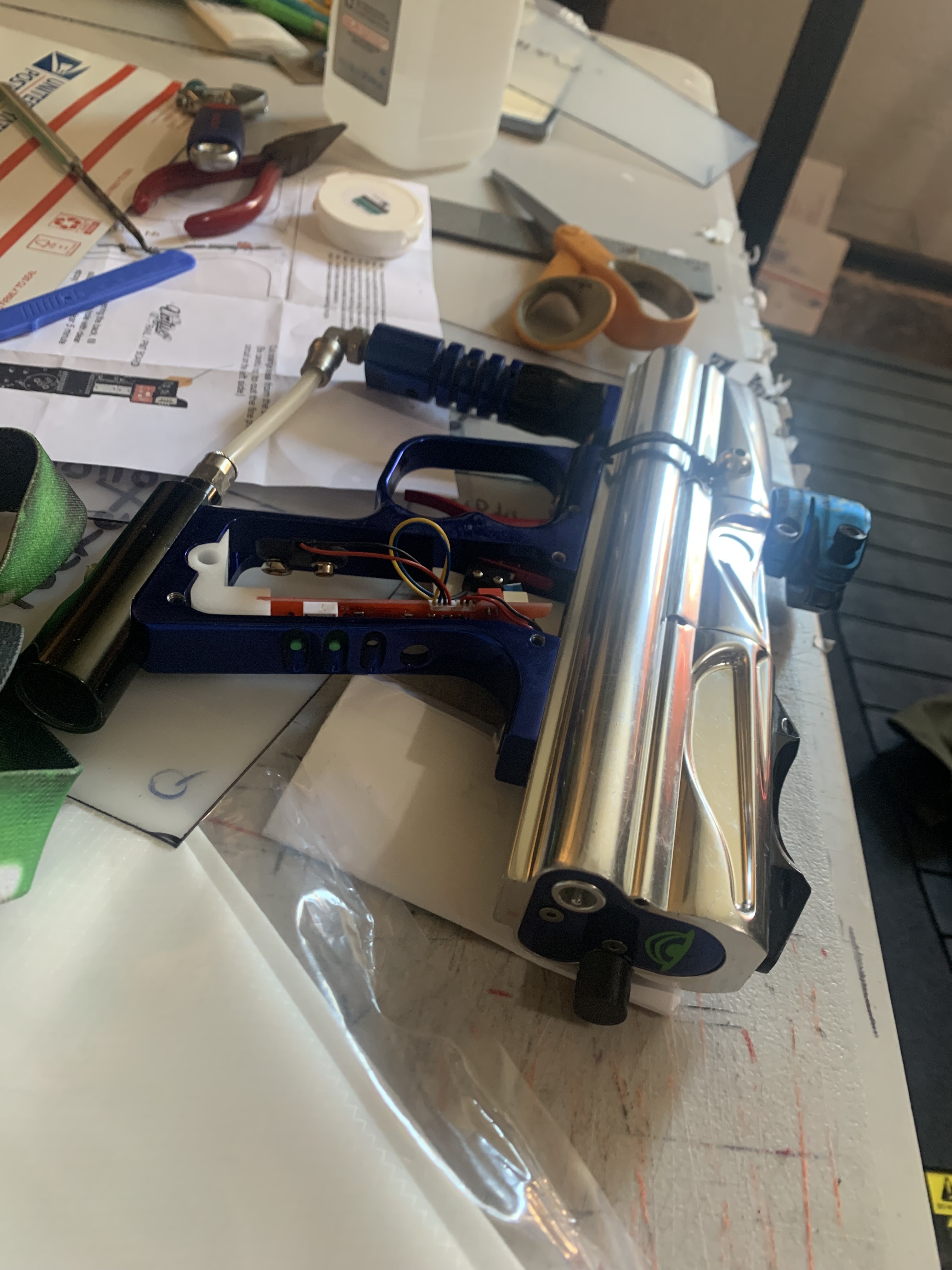

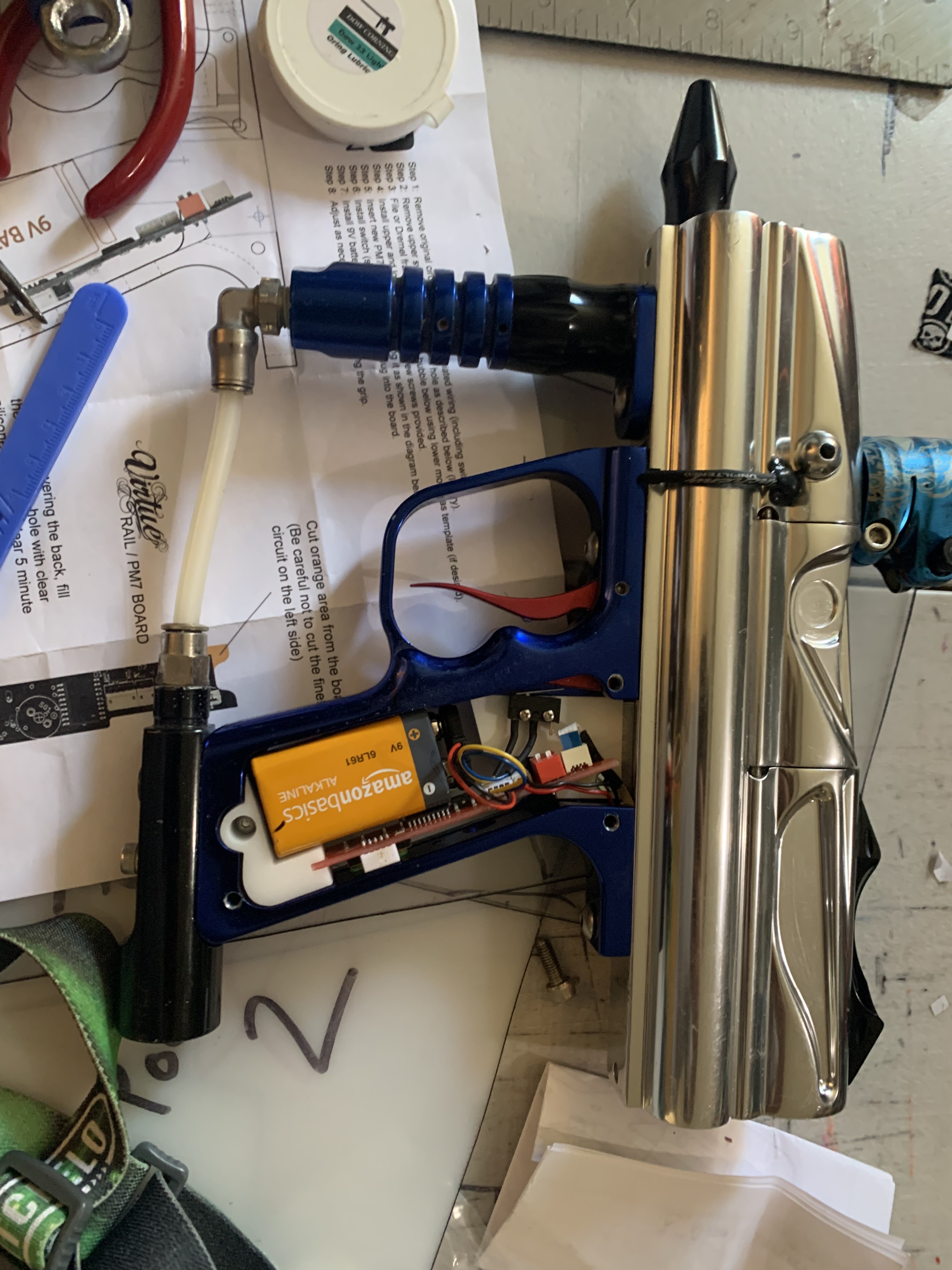

ID:	873099 guys - it's a success- aired up without issue - the anti chop eyes from Dr.Strangelove (angeleyes) absolutely work- no leaks- this is my first Angel restore - my brothers marker from 20+ years ago- just used a donor body from eBay- pm7 board, mount, and some elbow grease. Post video- I used a flat file to make clearance for the 9v inside the frame!
                big shout out to all of you guys- all the encouragement really helped keep it going.
                And Myrkul- big inspiration for posting this project! Thanks MCB! I'll post up the next one as soon as I get on itClick image for larger version
