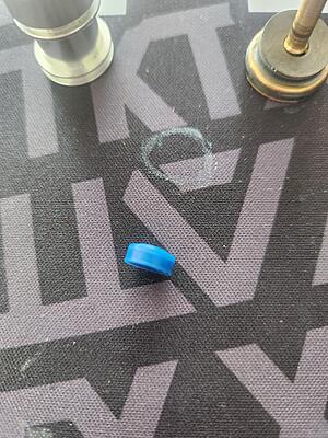

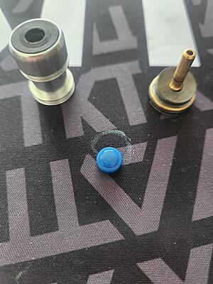

      CatFarmers commented
      Here is the "main seal". Im not sure what the A4 variants are supposed to look.
