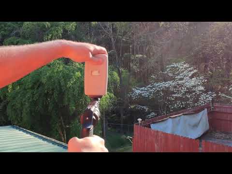

    So this is a project I've been working on since June 2019. 2020 put a damper on things, but it's something I'd like to get moving on again. Those of you who were members on MCB around that time likely remember the thread in the Members Only section. This is an adjustable velocity mod that also improves air efficiency. I'm finally at the point I want to move to production, but I'd like to gauge interest before doing so. It also looks like it may work with this new pistol of theirs, but I have yet to confirm this.
    Here is a video of Prototype 0 from June 2019. This one proved the concept, but wasn't adjustable, so velocity was temperature dependent. In the high 60's/low 70's (a weird cold front moved through, it's not usually that cool here in June), like in the video, it was spot on. When you got into the high 80's/low 90's, velocity spiked over 300 fps again, which required an adjustable version be designed. The adjustment required the loss of the aired up indicator/degas button, but did not require any permanent modifications. Everything can be undone and returned to as from the factory.

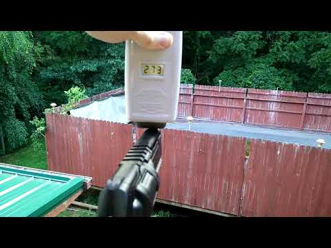

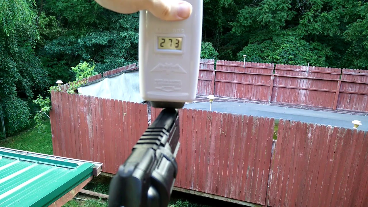

                      Getting closer to having these available for sale soon. Here is a video of the adjuster in action.
                      Here are some pictures of the adjuster. It was designed to be modular so spacers can be removed/added as needed to achieve target velocity.
