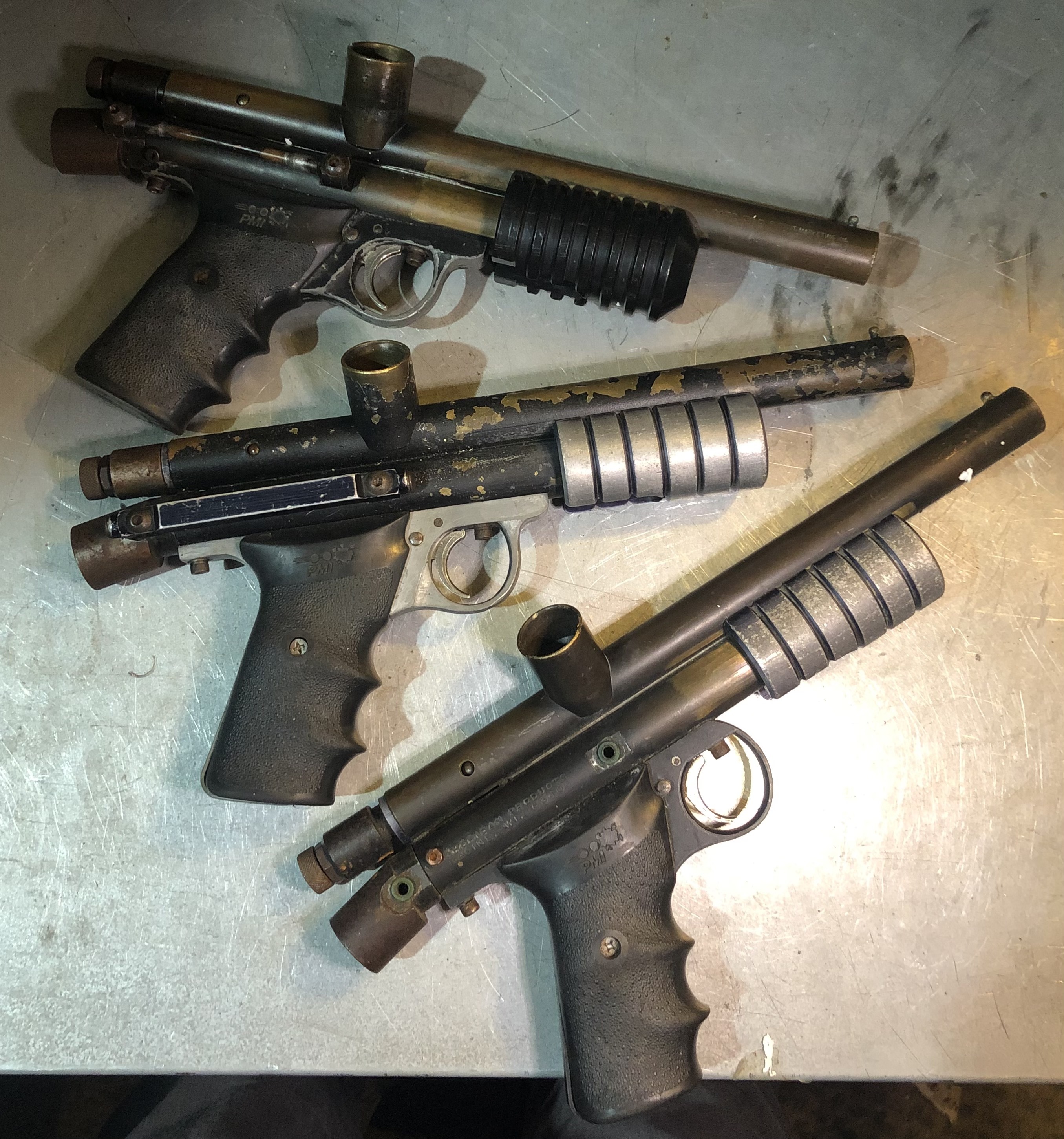

    Just got these 3 pirahna short barrels in today, they all need some tlc, they should be some fun projects. The bottom one is missing a lot of internal parts, but the top two look to be all there, so hopefully they'll go together ok Click image for larger version

      I really like those PMI grip and the PMI bolt
      The bottom one seem OK too, you could tap the airline on the side of the valve and use a stock with a bottle mount

            after taking the worse condition one apart, looks like its just missing the brass front plug and the air line on the side (I've never worked on these before, didn't realize the lower tube chamber behind the plug was just an empty chamber) I'll probably be ordering a few kits from xemon soon, I just wanna get them all broken down first. I think I'm gonna polish them all up and make them shine. Also I didn't have a valve nut tool, but 2 long screw drivers did the job just fine

              If you have a spare 1/4"(? 🤔) nut driver. You can grind down 4 sides and make a cheap one that way. 😉

            I tried making one out of a vm68 valve tool, but the valve shaft was a little too big diameter for tool I tried making, got a little flustered and tried the screwdrivers, surprised that worked. I'll end up making something a little more permanent soon

              Back in the early days....I'd seen 1/4" copper tubing, hammered out square and used for a valve tool. You can get real fancy and drill/pin a cross pin, for putting the valve nut back in.😁
