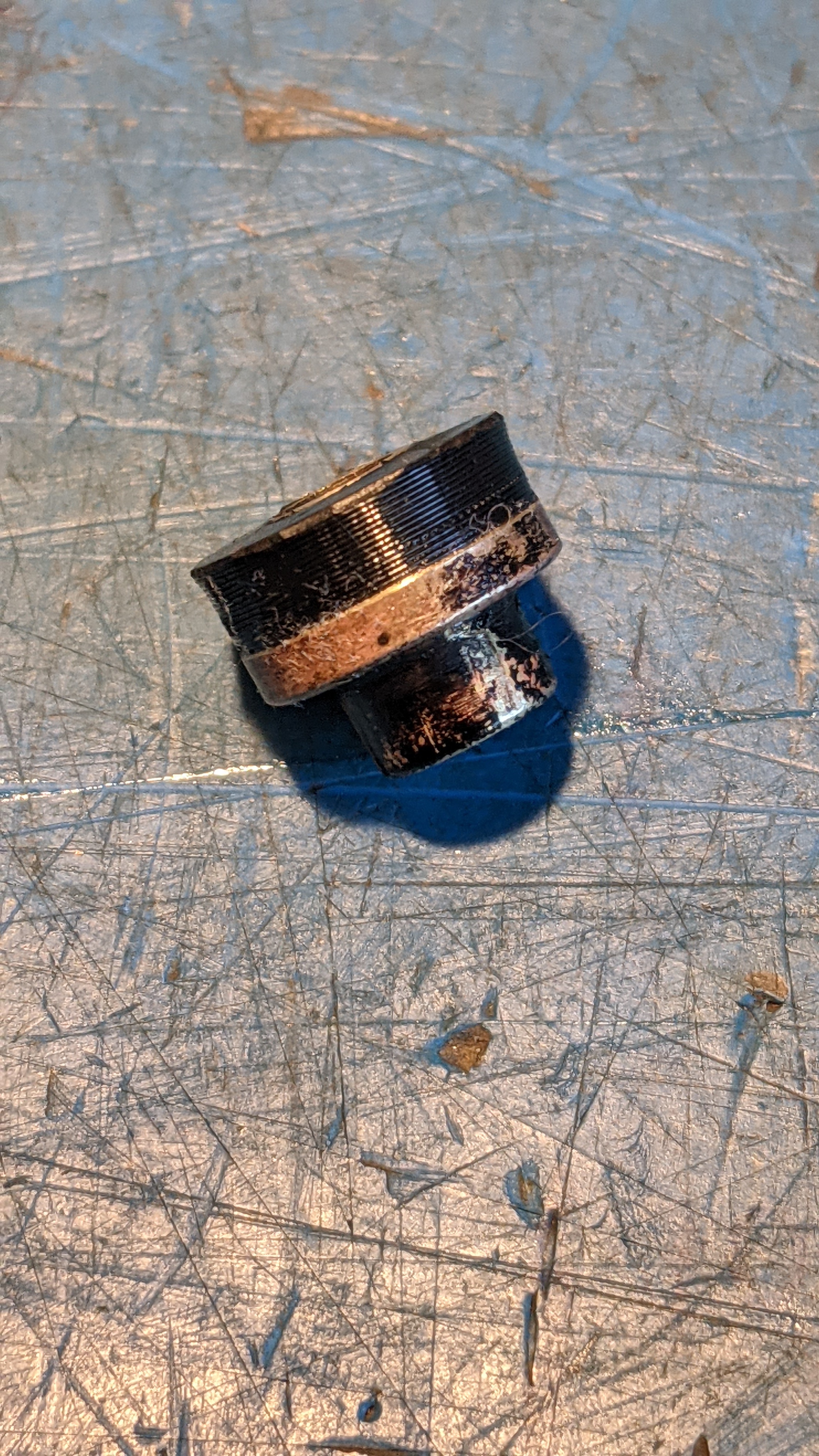

    Here is my very dead and leaky seal.
    I tried o-ring in there with no success ... Tried some experiment glue I've been wanting to try for a while ... Still leak ...

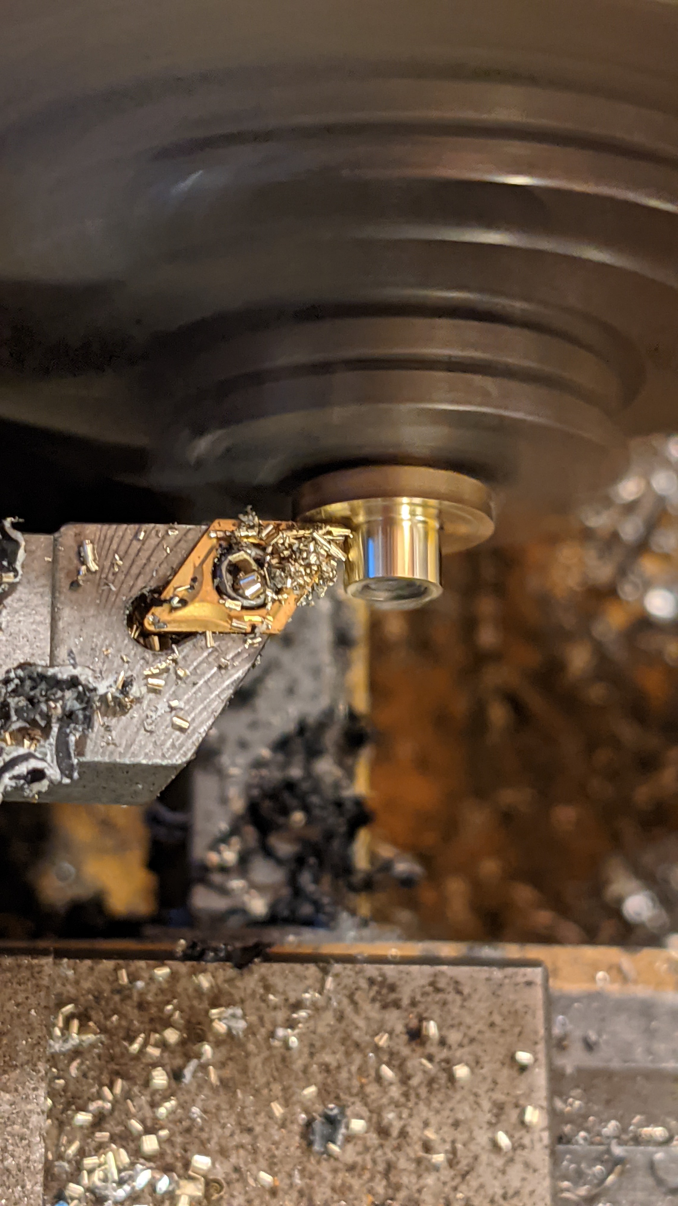

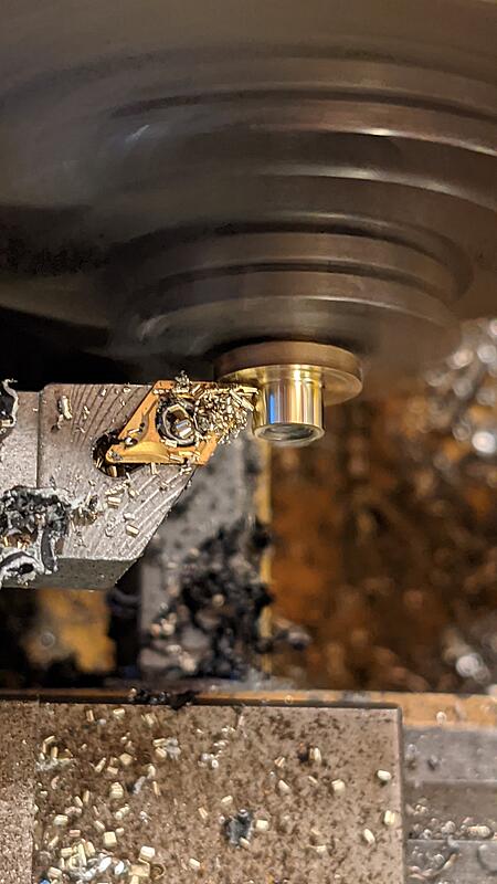

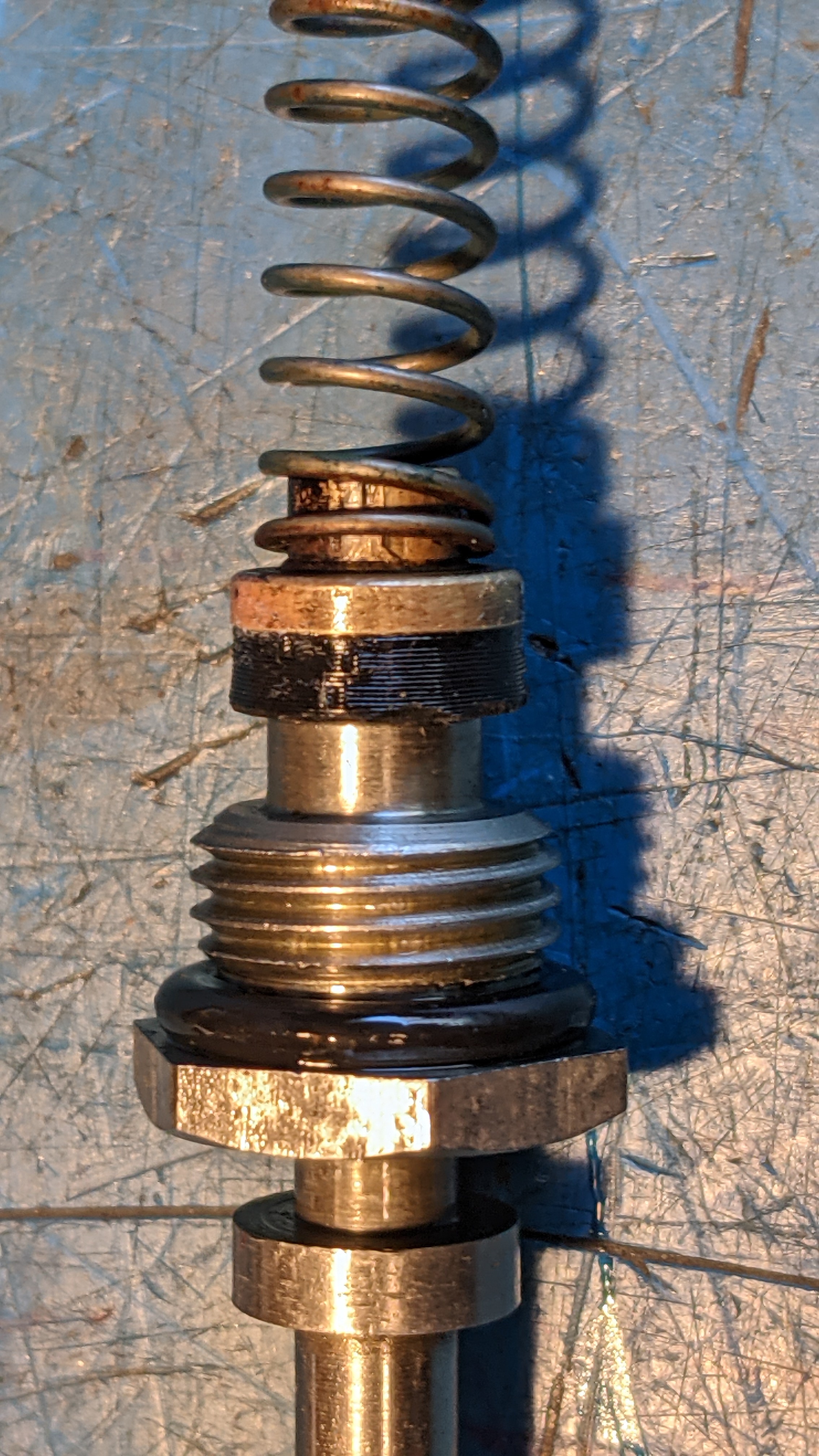

    And here is the last ditch effort:
    A 3D printed seal ... It's been under pressure with a 12g for over 24h and still seal and shoot ... So I feel good about it lasting ...

    Curious, though- you clearly have a lathe, why didn't you just turn a solid Delrin ring rather than 3D printing one?
    Doc.
    Paintball in the Movies!
      XEMON commented
      That is a really good question!
      Here are a few things (not necessarily in order ... But kinda?)
      1) I had the right filament already loaded in the printer
      2) I didn't thought of it
      3) it's quicker?
      PS about #2: I don't have much delrin ... So I try to save it ... So I never use it ...
      Now I'm thinking about it, I need to pick up a few rod of different sizes so I can actually use them 😅
      PS #2 about #2: would delrin be soft enough? I've worked with PTFE solenoid a lot and they leak ... Always leak ... And never seal ... Ho! And did I mentioned they always leak? ...
      Ultimately I'd like to made "drop-in" seal so anyone can replace them without the need of the lathe ...

        Well, its been about a month since i put a 12g in, its still shooting ... so i call this a success.
        When i finally drain it out, ill open it and look at the seal ...
