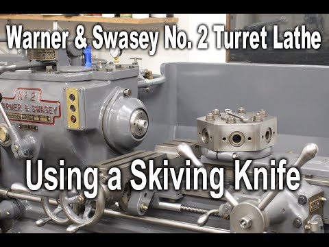

    Here's a quick video I ran across, showing how they made parts of a 'Cocker barrel just before WW2.
    Who needs CNC? I knap parts for you fellows out of flint! With rocks! In A Cave!

        Never seen something turned like that before. I'm very used to "in line or slightly below center axis"

                    -This is more of a "shaving" style cut than conventional single-pointing. It's a form tool, similar to what you see Clickspring using a lot, but as it applies the cut tangentially, it reduces the chipload.
