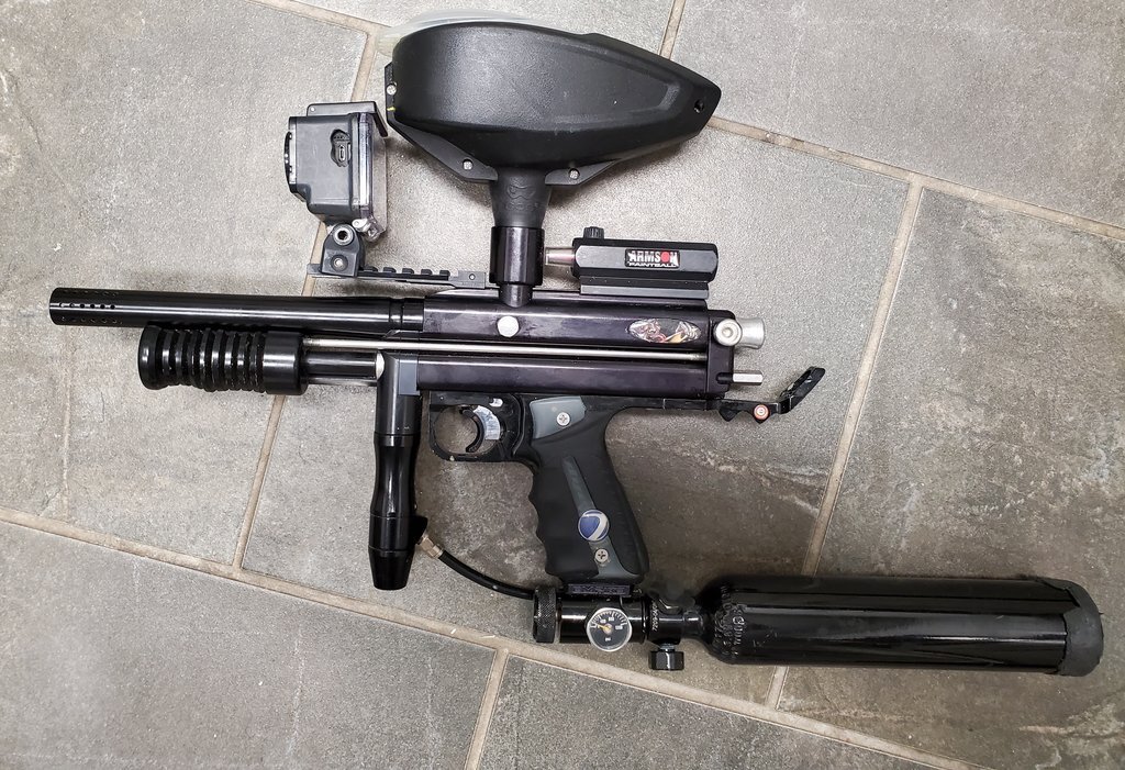

    I rean a Python kit with 1/2" tip and loudner on my Viking. Whole barrel was so short I had a ref give me shit before we took our barrel covers off for "Forgetting my barrel in the stagging area"
