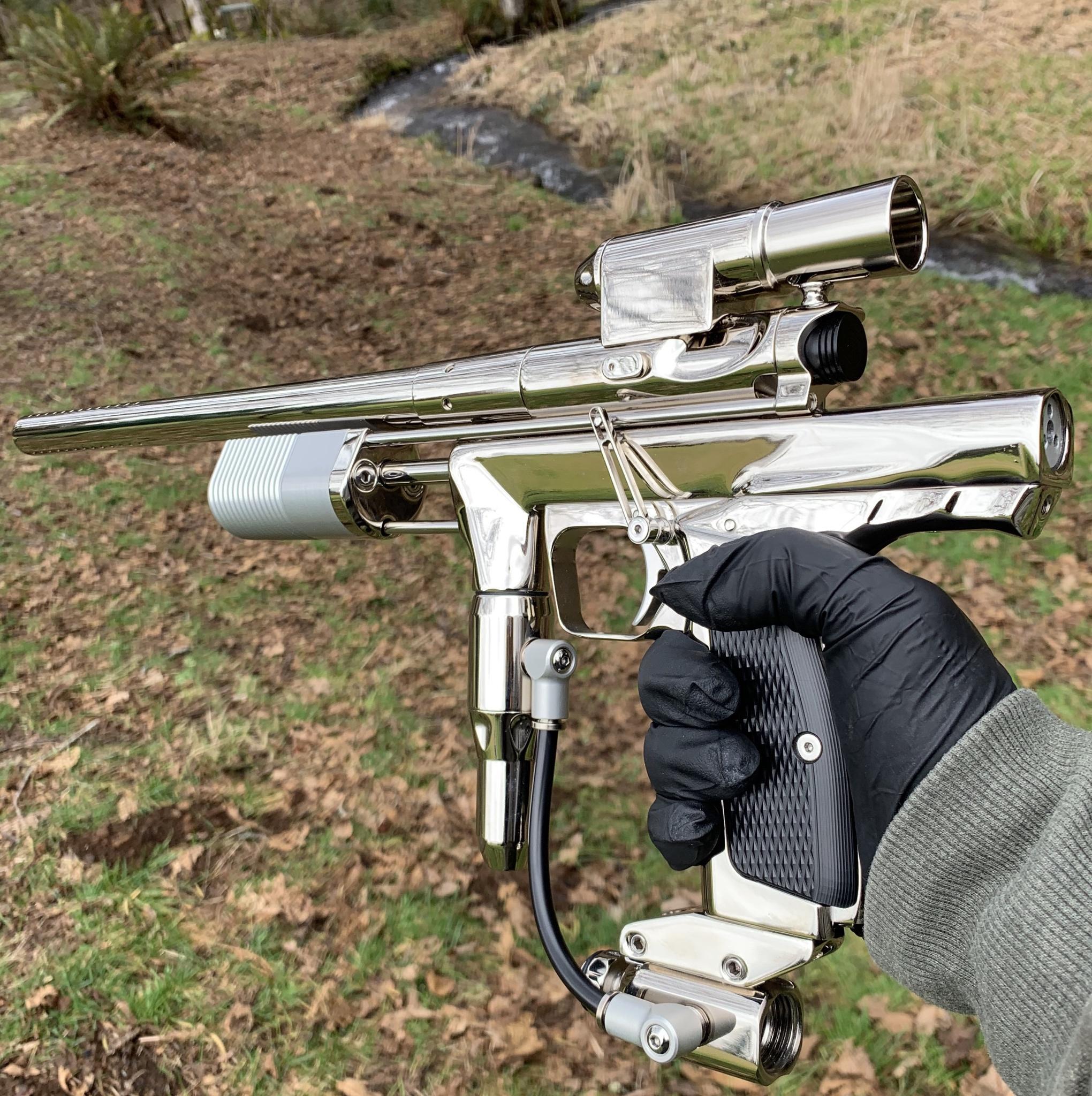

    I electro nickel plated a S6.5

      Did you do that yourself?
      Carp commented
      That looks like something straight out of battlestar Galactica with all that shiny...😅
    • Arthur
      Arthur commented
      Thanks my dudes.
      I had Arnold’s Metal Finishing in California do the eletroless plating. I bought this S6.5 on the old site. It had been beat up, used and abused and put away wet. Rust on the main body near the feedneck too. The original ano was awful, it was this greyish color, no idea what they were going for.
      I then sent all the parts into CCM for a complete build and tuning. All in all took about 6-7 months to complete this build.
      If you run out of paint you can still blind opponents with it or check your hair while on the field.
      Very very smooth finish.
      FredMnkyDad10 Feedback
      • Arthur
        Arthur commented
        Lol 😂 Duh what do you think I use for clearing corners and hallways, bro
          What did that run you if you don't mind me asking? Or did you personally plate it?
          • Arthur
            Arthur commented
            It was cheap my dude. Than again, I was doing all of this during the height of Covid, so maybe I was getting a deal. About 400.00, give or take some change.

            Thats too bad that powder-coating does indeed lower the value, which really it shouldn't. imo
            Now I totally knew electroless nickel plating would ensure lower overall value -- Unless I find someone who digs battle star galactica of course. I never plan to sell it anyway, so Im good.
