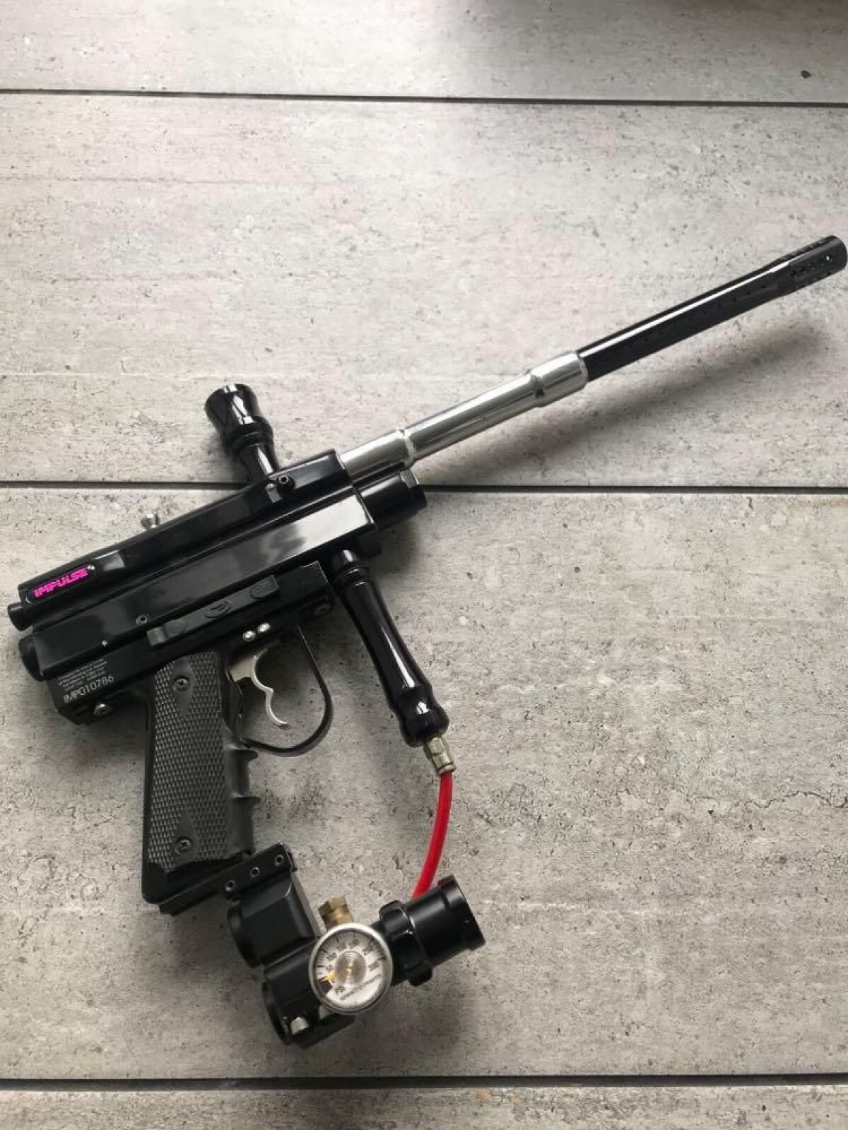

      Yep, regulating the pressure directly from the tank, thereby eliminating the need for an HPR was a thing back in the day. As was having a whole plethora of regulators, with some idea of where the perfect gap between pressures was - but that's a whole different can of worms. Anyway, the initial run of both Impulses and SFTs were sold with a gas through, rather than an HPR as a grip.

          Notice the bottle threading directly into the regulator? It is the same as that Impulse above except instead of an ASA it has 5/8-18 male thread hooked to a fill nipple, on/off valve, and tank pressure gauge so that 4500 PSI goes directly into the regulator. This design also does away with the LPR, the whole marker runs on less than 200psi and that brass valve hooked to the regulator is a 240 PSI pressure relief valve. It should also be noted that for whatever reason Smart Parts included that hose with 3000PSI working pressure.
          This might seem worse than tank regulator to HPR to marker, but in fact this one performs better than my other ones which are that way. I have a Ninja 90ci with a 4500PSI HK regulator, which has an ASA that is hooked to a maxflo inline to my remote, and once the tank dips below 800 PSI (which is the preset output of the HK regulator) my velocity starts to drop, whereas with the Infamous tank/maxflo reg I don't have any noticeable velocity drop till I am close to 200 in the tank. This also does matter as in normal gameplay the pressures will run low, one hopper and 3 pods is enough to drain that 80ci tank to only a couple of hundred PSI.
