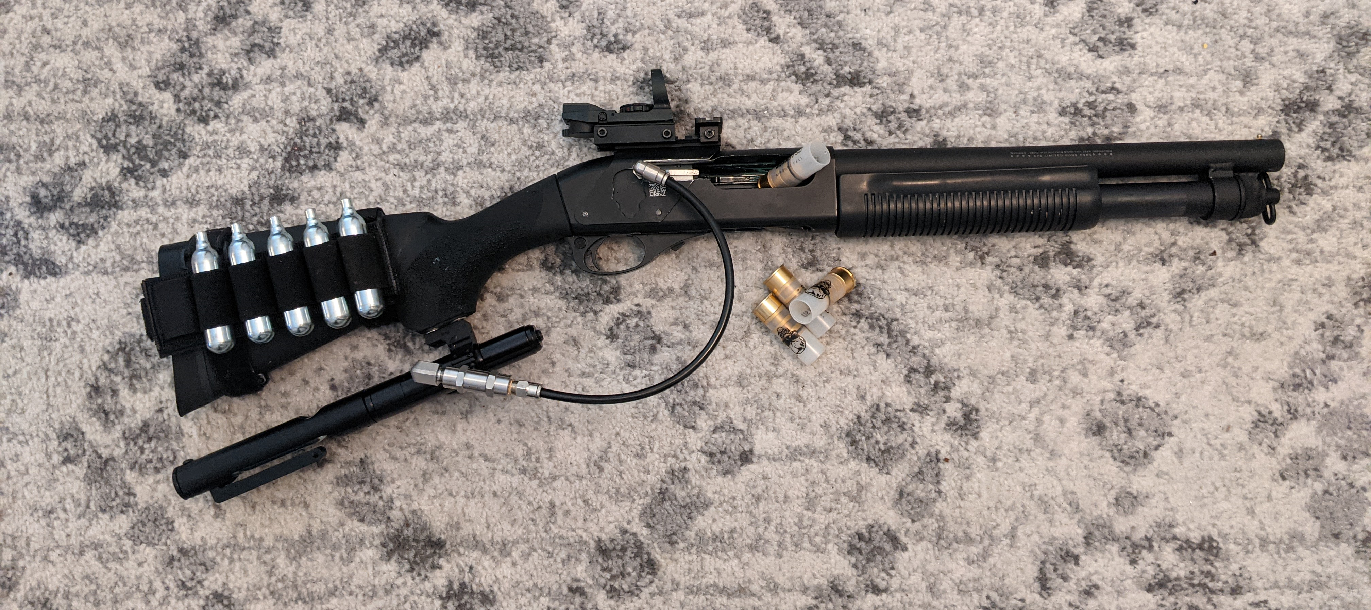

    Finally finished this project and wanted to show how fun it is to use!
    It's based on a CAM870 MKII, to which I've made a number of modifications:
    - Bolt valve spring lightened and trigger hammer spring strengthened to dramatically increase velocity
    - Bolt drilled and tapped to accept 1/8 NPT air fitting
    - Receiver dremelled to allow travel of attached air fitting
    - Hogue stock cut and drilled to mount bottomline regulator ASA to allow easy control of input pressure and thus velocity adjustment
    - 12g co2 or HPA remote line configurations
    - Check valve installed to improve 12g efficiency

            You can find shells from here too. Do keep in mind that I made a LOT of modifications listed in the OP to be viable for paintball. Out of the box you are going to get 200-210 fps on first strike, even less on roundball, with no way to adjust velocity, and you are going to have recharge the bolt with a special co2 charger midgame every 10-15 shots or so.
