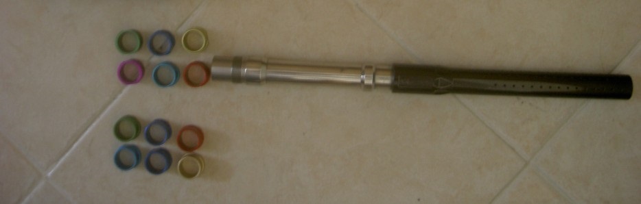

        It's my favorite barrel, the OTP G-1 barrel. They were the first as far as I know and were out in the latter mid 90's.
        • Memornix
          Memornix commented
          Wow, I remember when these came out, my mind was blown

          Yep. The All-Americans were probably the first to come in specific bore sizes, though they were not generally sold in "sets".
          The OTP was the first where one barrel had an interchangeable bore. Can't recall when it originally came out, but pretty sure I had one when I launched this biz, and that was '98.
          I remember a big chunk of the reason I wanted to get a lathe was specifically to make my own OTP inserts, and mod some of my own barrels to accept them, since I was too poor to be able to afford the real thing.
          At first, they just came with three inserts- I'm not sure anyone even specified a bore, they were basically just small, medium and large. Later (still in the 90s) OTP started offering a wider range- the first inserts were, as I recall, something like white (clear) red and blue, with the later ones like purple, green and a different blue- the ones shown above are the later kits.
          The Freaks came out about then- '97/'98 ish, maybe? Can't recall precisely when.
