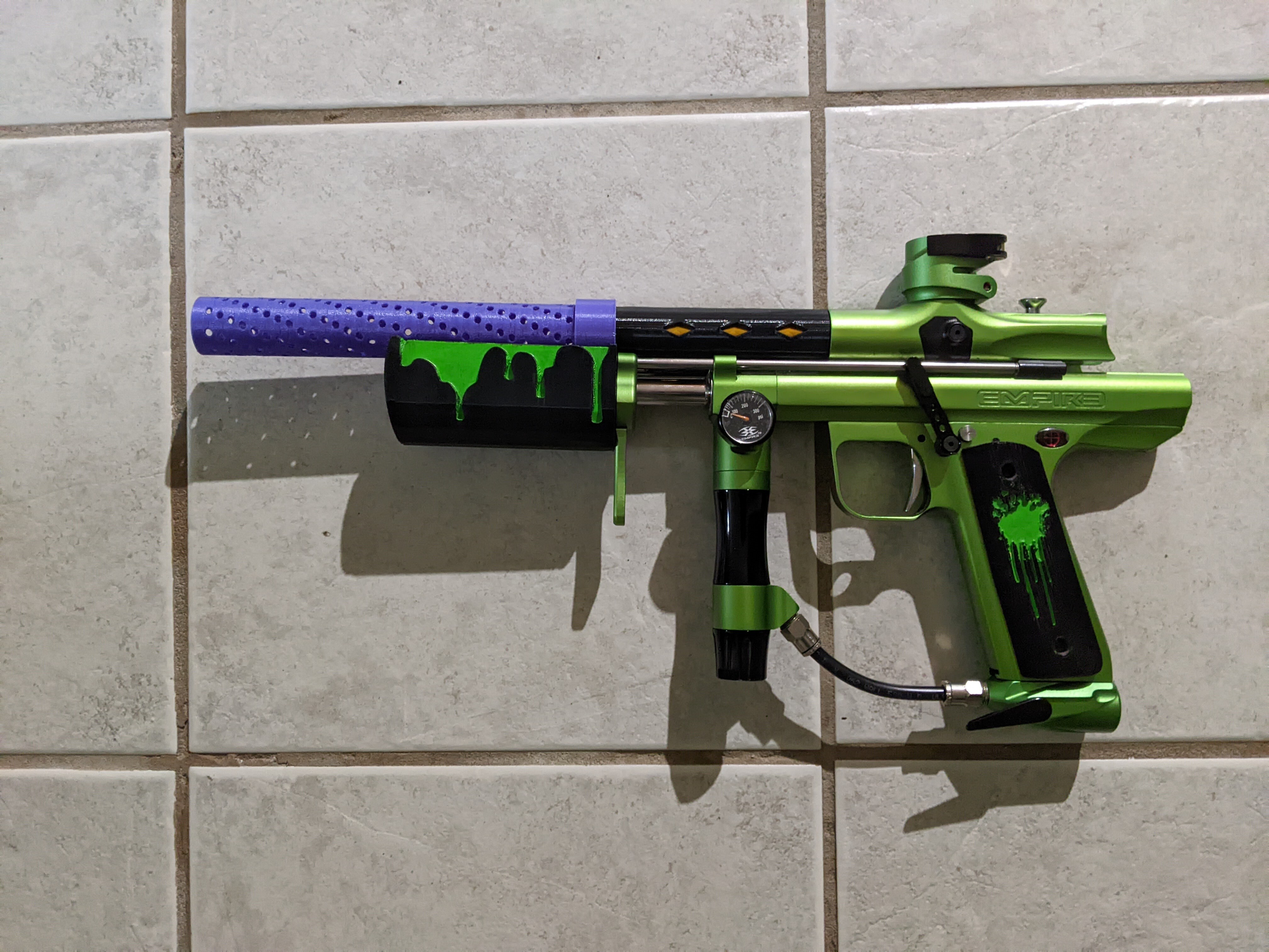

      I had the same issue so I 3d printed my own handle with less slop. Although I did print one in wood and it did not slide well. This works great, but I am sure a drift kit would be way better.
      Mine has a morph valve with ID hammer and bolt and it shoots as nice at my cocker pump with ccm pump kit and CCM internals.
      Pic was from when I was testing out a modular barrel, ignore the prototype colors!
