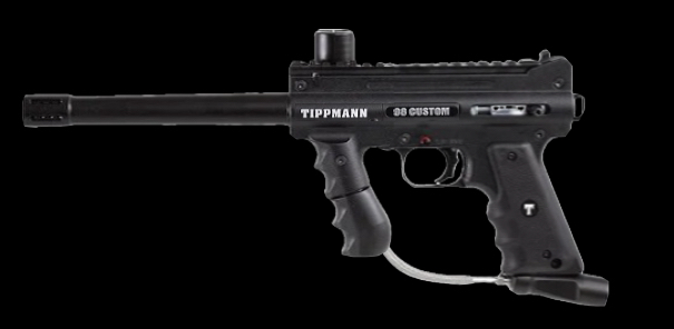

      Originally posted by Meleager7
      Picture this.....
      A 98 Custom like body, but about 1/2 the length of a standard 98
      A Tippmann Flex Valve bolt system
      Mechanical ( but you could add clapper boards later)
      Vertical Feed
      Would have that classic 98 custom foregrip ( admit it, you love this foregrip!)
      The return of those shark gills!
      Would you buy it!?
      Hell yes.

          even though this topic is a couple years old, the concept interested me enough to do some crappy photochoppage! i give you.......
          The 98 Mini!!!
          WELTHOUSE x Timberghosts

          The weight balance of a tippmann with the ergonomics of an invert mini! Can't wait!

                  #29
                  The 98 Mini!!!
                  Yep, now imagine a Tippmann Flex valve is inside there, and the concept is complete! Who knows someone at Core sports to send this to !
