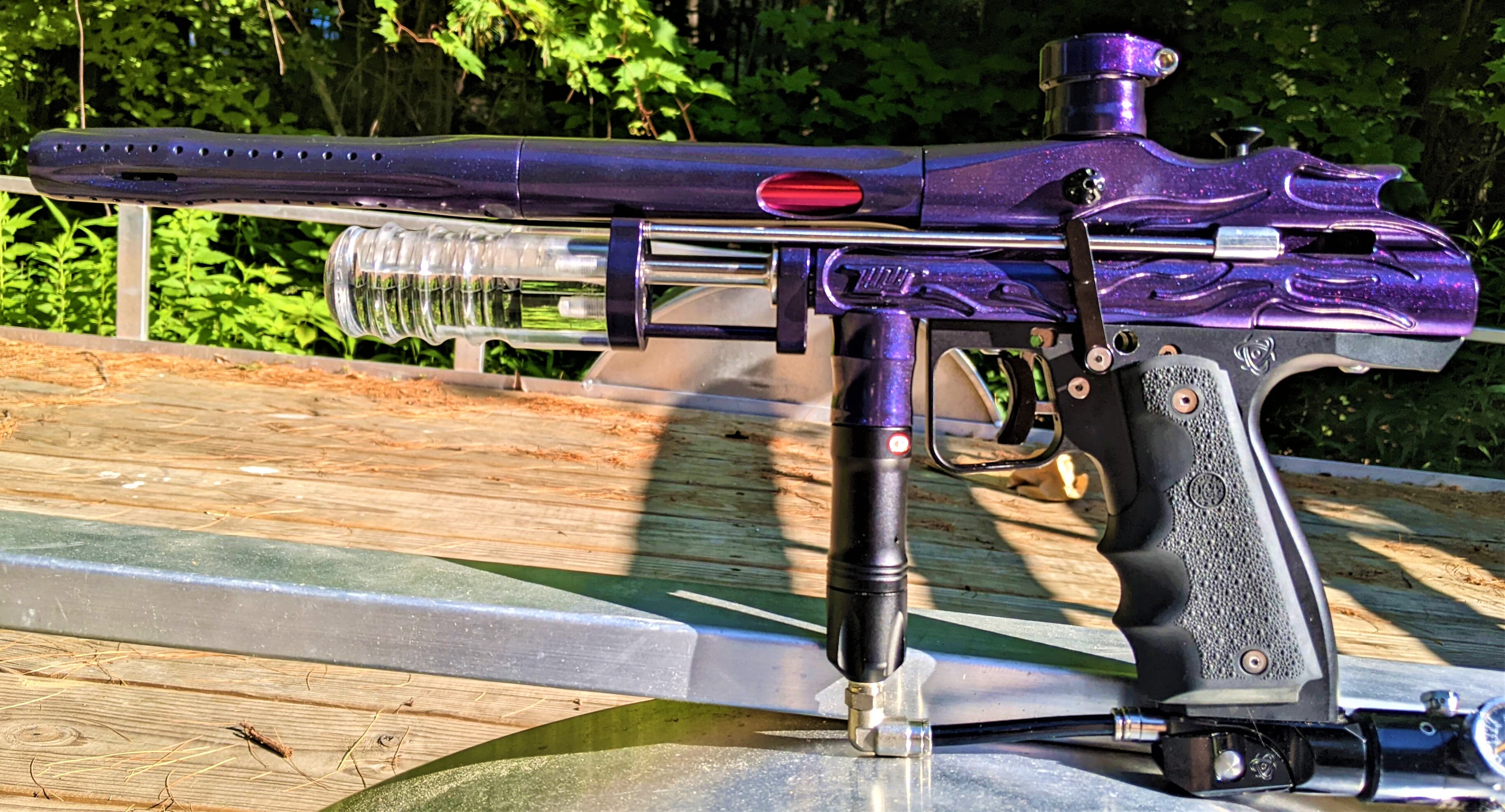

    Hey,
    I just got my 06 Black Magic back from the Cerakote shop (https://www.barefootcustomcoatings.com/). I asked for a purple chameleon like coating. He put the Mystique FX coat on it, and it came out better than I expected! I tis a bright metallic purple in the sunlight and a deep dark purple in the shade. Pictures just don't do it justice!
    These pictures were taken back to back, one in sunlight the next in the shade.
    Also, for those who were wondering if Cerakote is strong enough for paintball, he coated a Revy for me, and I torture tested it. I shot it several hundred times and even at point blank range. I have videos and will make a post when I get the time to edit the video a bit. Short answer is, yes it holds up!

    Wow that came out nice!

      Damn you and I must be twins, I am about to get my body back with GunCandy "Mongoose" on it. Very similar purple chameleon colors!
      (Pic quality is terrible as these are screencaps from a vid he sent me)
      • shooter311
        shooter311 commented
        That is awesome. I got my minimag body coated in guncandy stingray, it was a bit more blue, but equally awesome!
        I got pics from the shop as well and I was a bit bummed since it looked almost black, but once I had it in hand it was a way different story.
