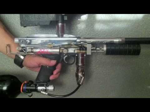

    Curious what the pump community thinks of this mod? Would you allow something like this in pump-only games? What if it was paired with an autotrigger making it essentially a semi-auto marker? I’m interested in building a pump with this kit but if it wouldn’t be allowed or frowned upon I don’t think I will.

        So do these run as a regular 3 way with the option to pump it then?
        • Grendel
          Grendel commented
          Yup, it is just breaking the mechanical interaction between the 3-way and the trigger so you have to do the two separate actions but everything else is just like a normal cocker. With practice you could be essentially just as fast as a cocker but it is an alien feeling at first. So if I was to use it in a pump game I would limit myself to one small gravity fed hopper to keep myself on reasonable par with the rest of the pumpers

        Not quite ...
        Its a 3 way that is not linked to the trigger, to cock the gun, press it, then release it (it's spring loaded).
        So you "pump" by pressing it, it's short stroke and light compared to a "regular" pump kit

          As I understand it these are basically a much-simplified and miniaturized way of approximating the functionality of a Brad Q. Nestle S.H.O. Sniper.

            Same thing, but without the pump handle connected.

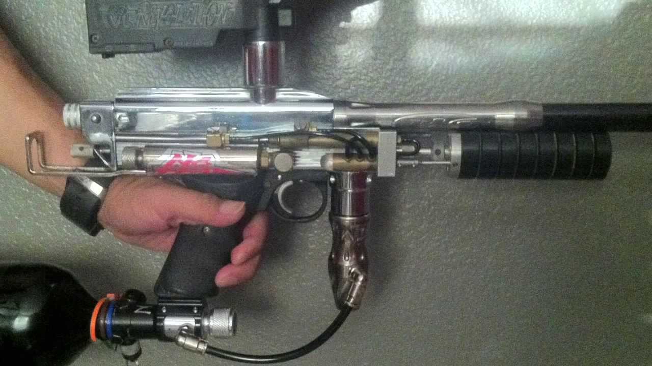

                        Update to show off completed build:
                        I wanted to go with a front block with an integrated VASA as it would put your finger closer to the "pump handle". Chose the Inception Designs extended reach platform over a mini platform as it gives room for your thumb and I can only find full length pump arms that were tapped for auto-triggers.
                        Also went with a smaller LPR so it wouldn't get in the way. I had a WGP Tickler lying around but I think a WGP Bullet would have been perfect.
                        The "pump handle" has a set screw that holds it in place. I had replaced it with an longer screw to use as a hitman handle, and it worked great, but it looks cleaner without it. If I find an inch long 10-32 black shoulder screw, I may try it again.
                        I'll also want to replace the pre-travel screw with a shoulder screw for a smoother pump stroke:
                        Normally don't put a set screw on the 3-way, but I'll probably put one on here for added stability.
                        Overall I'm very happy with how the build turned out. I think this will be my primary recball gun for a while. I'll be able to play pump against renters but also fall back to higher rate of fire if needed.

                          Can't even tell it's a pump on first glance.
                          I think it's funny that the LPR now gets in the way of the pump handle.
                          This would be cool on one of those world's smallest Autococker (Mini/Midget/Half-back) builds.
