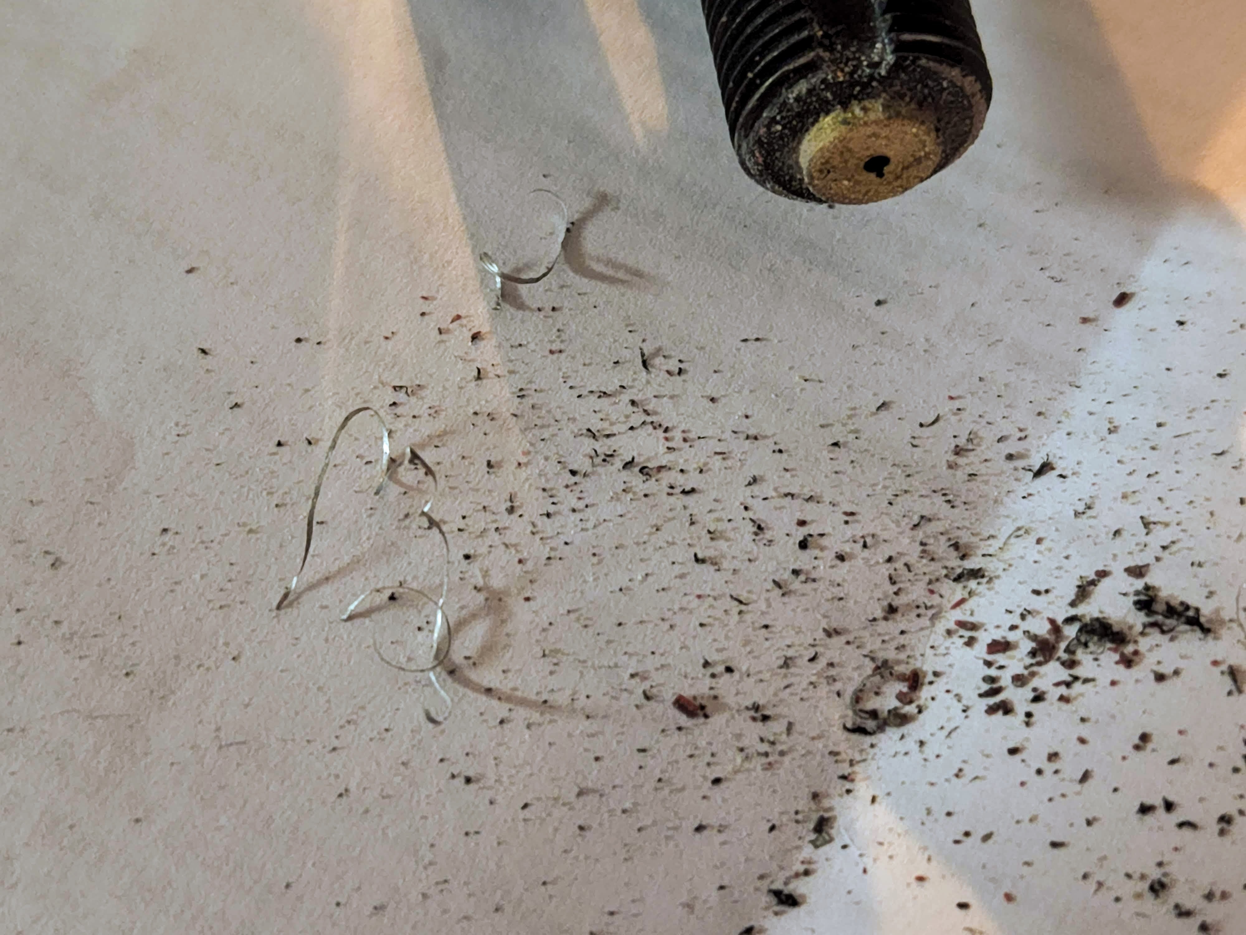

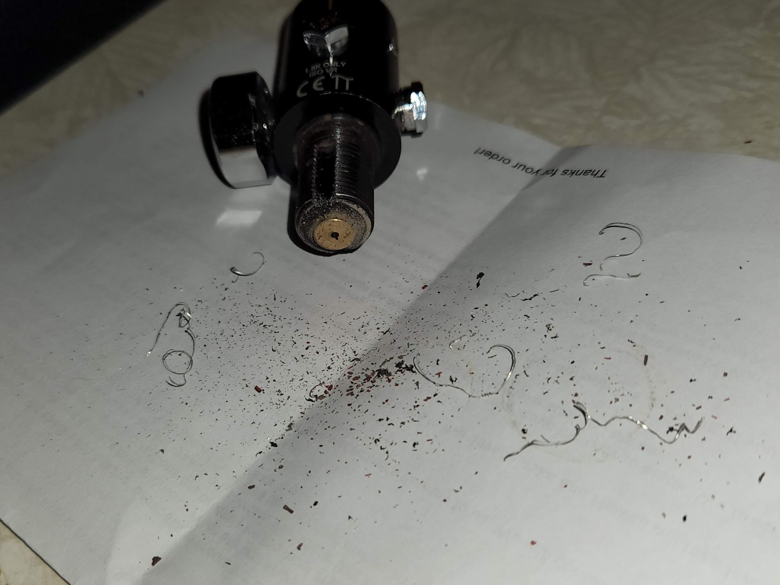

    Been having some fits with my Empire peanut tank, namely around the fill nipple. However, I've always noticed that sometimes it sounded like something was inside the tank, so I decided to take the reg off and inspect. Lo' and behold, metal shavings and some dirt. The metal shavings have got to be from the regulator screwing into the tank, because those reg threads were SHARP! The dirt could've been from anywhere, just another reminder to use a nipple cover!

    • zinger565
      zinger565 commented
      True! I don't think it's from my local field though. I bought the tank used, and it's always had a bit of a rattle. Also, haven't heard anything on any of my other tanks.
      dirt in the fill nipple is a possibility.. also you would be surprised by how much sh*t a poorly maintained field compressor will add to your tank
