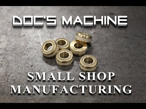

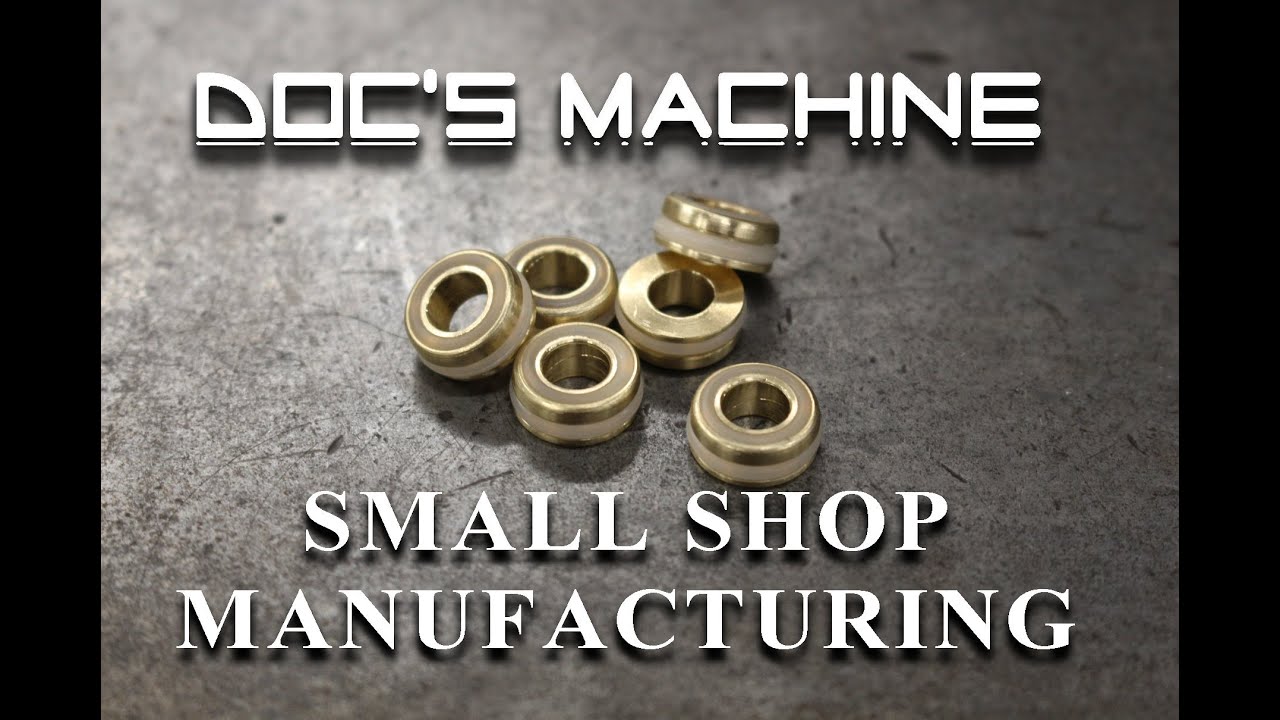

    After putting together those Montneel seals, I shot some extra video, and tried to piece together a sort of "process" video, showing more or less how it was done.
    Keeping in mind I'm still pretty new at this- both recording and editing (and planning and scripting and acting and... ) but we gotta start somewhere.
    Let me know what'cha think- I'd love to hear some feedback, good or bad, and hopefully I can make the next one better.
    Doc.

          Did you make that tool to swage the seal in?
          neato.
          • DocsMachine
            • 2774
            neato.
            -Yep. Took two attempts to make the top punch, and I started by just setting the part on the table to crimp it down. If I wasn't extremely careful- with a ball peen hammer?- I'd also wind up partially collapsing the side O-ring groove too. So I had to make that little fixture to support the upper face of that same groove.
            ... And you guys thought they fell out of the machine and I just stuck 'em in a bag.
            Doc.

              Those nippers after the cut off are a good idea.
