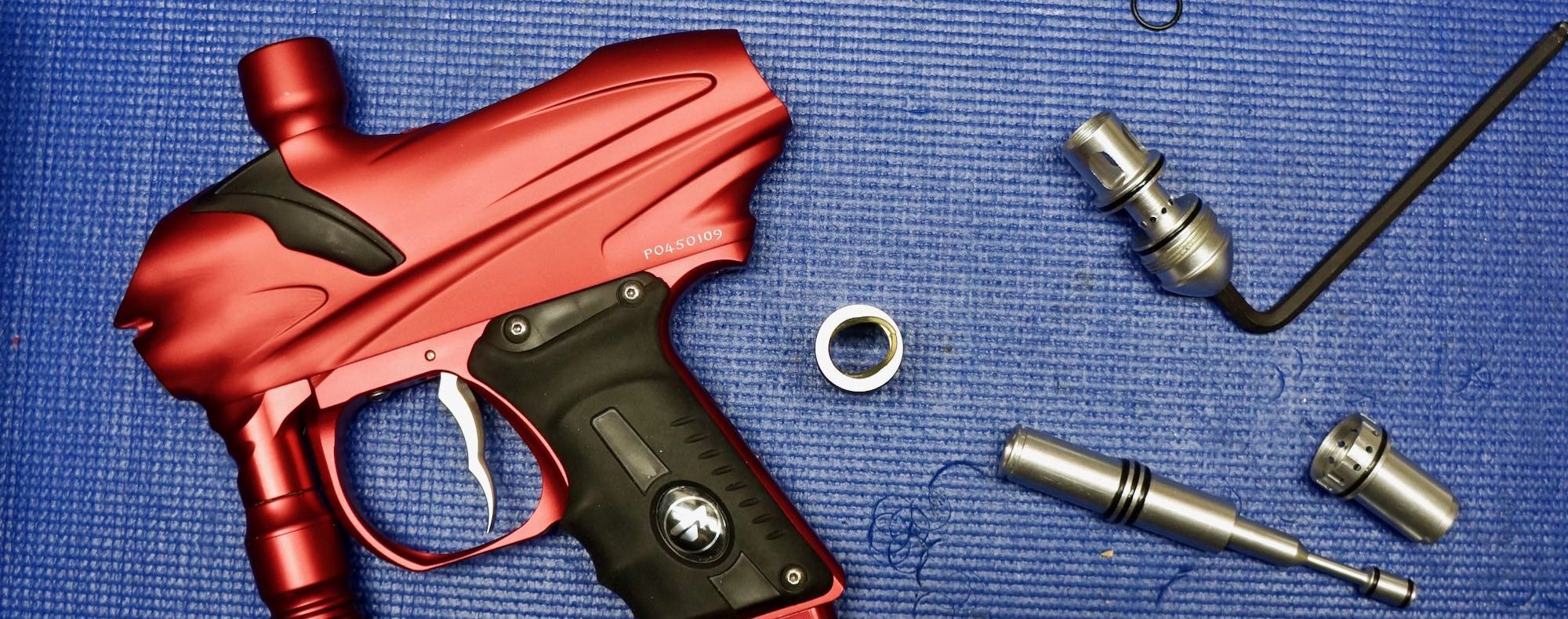

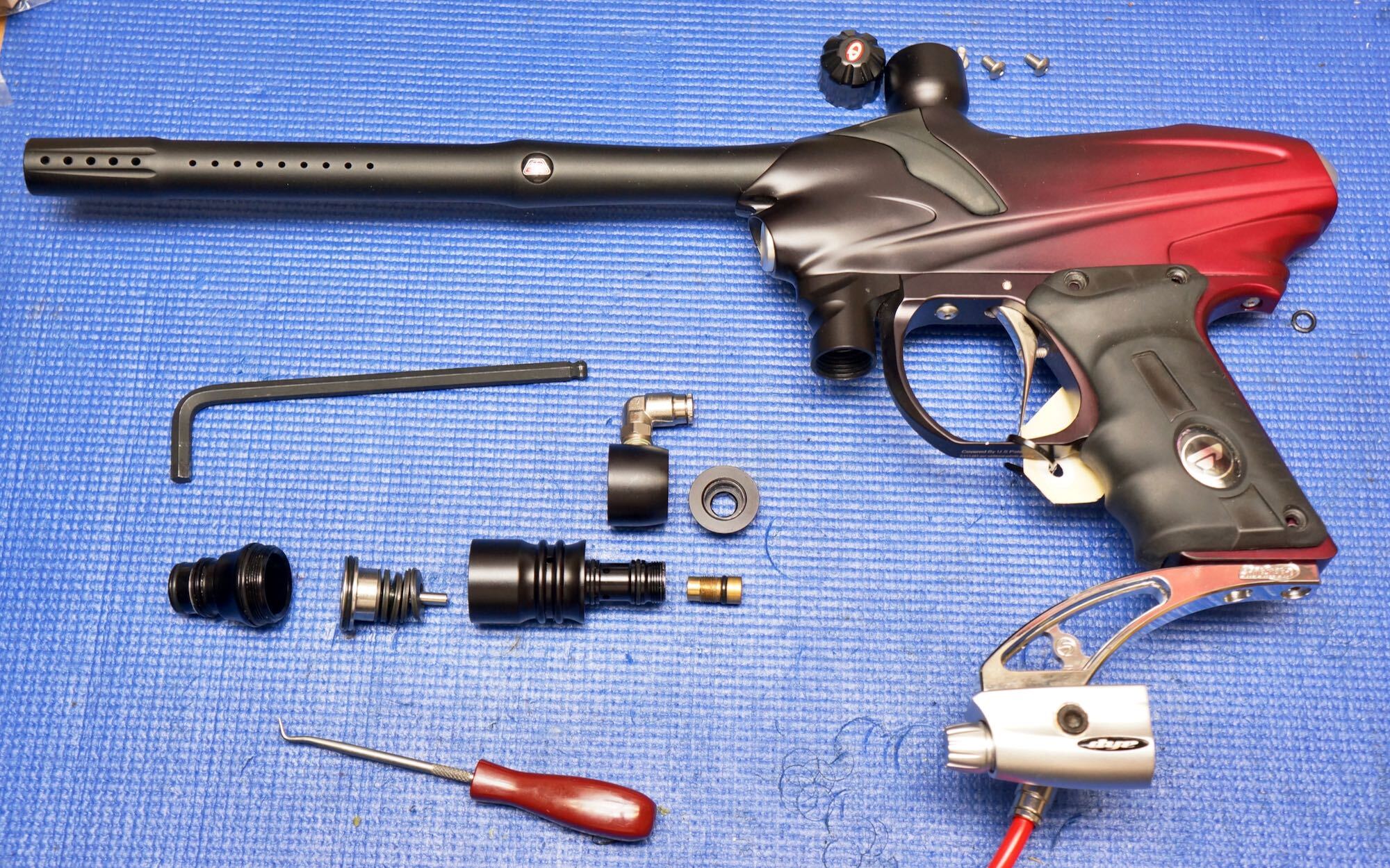

    Can someone fill me in on the history of the Proto Matrix?
    I've just recommissioned a couple of early '05 models and was curious about their origin. Apart from their rather chunky looks they appear to be nicely put together and look like quality markers.
    All they needed were new urethane o-rings in the HP regulator and bolt assembly. Apart from that there are no signs of wear so I suspect that neither marker has seen much use.

    These were Dye Matrix markers at a cheaper price point. They had 4 model years and we're discontinued (most likely) because they cannibalized the sales of the high end Dye Matrix guns. They used the same bolt system as well as many of the same parts of the higher end models.
    I'm a big fan of both the PM7 & PM8 models as they were more slimmed down and still hold up well against today's offerings. Dye really put the nail in the coffin with the PM8 which came with the Ultralight frame that was used on their DM line as well.

      The proto line was more often a test bed for the dye matrix line. This is why you would often see innovations come into the proto line a year ahead of the dye line. Some of them got innovated into the dye line, others, when used on a mass scale turned out to not be good ideas so they were dropped
      That 05 you have there, go compare it to the dm6. You can even see it in the body styling.

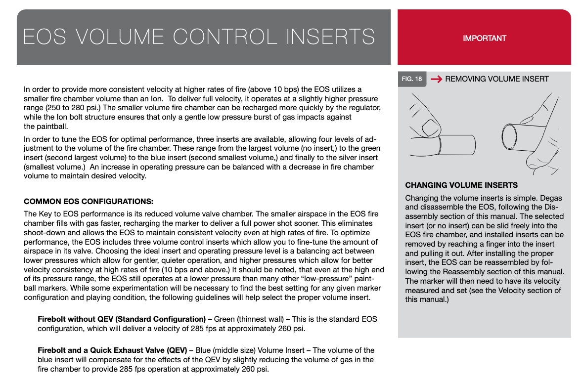

                    What did the mod entail, was it a spacer like on the EOS?

                      Originally posted by mikew
                      Love this sort of info
                      I'm not sure what the EOS one was like but sounds like it. Literally anything that took up space in the dump chamber that didn't interfere with the bolt movement. Some people used tape, I've heard of garden hose, a lot of aftermarket bolts came with plastic spacers

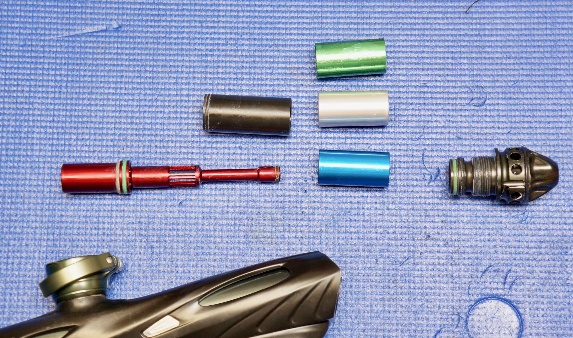

                        The EOS has a removable carrier that holds one of three supplied spacers. It's very Freak like which is understandable given the parent company.
Name:	Screen Shot 2022-12-26 at 10.54.11 am.png
                          Yeah it's pretty much the same idea then.
