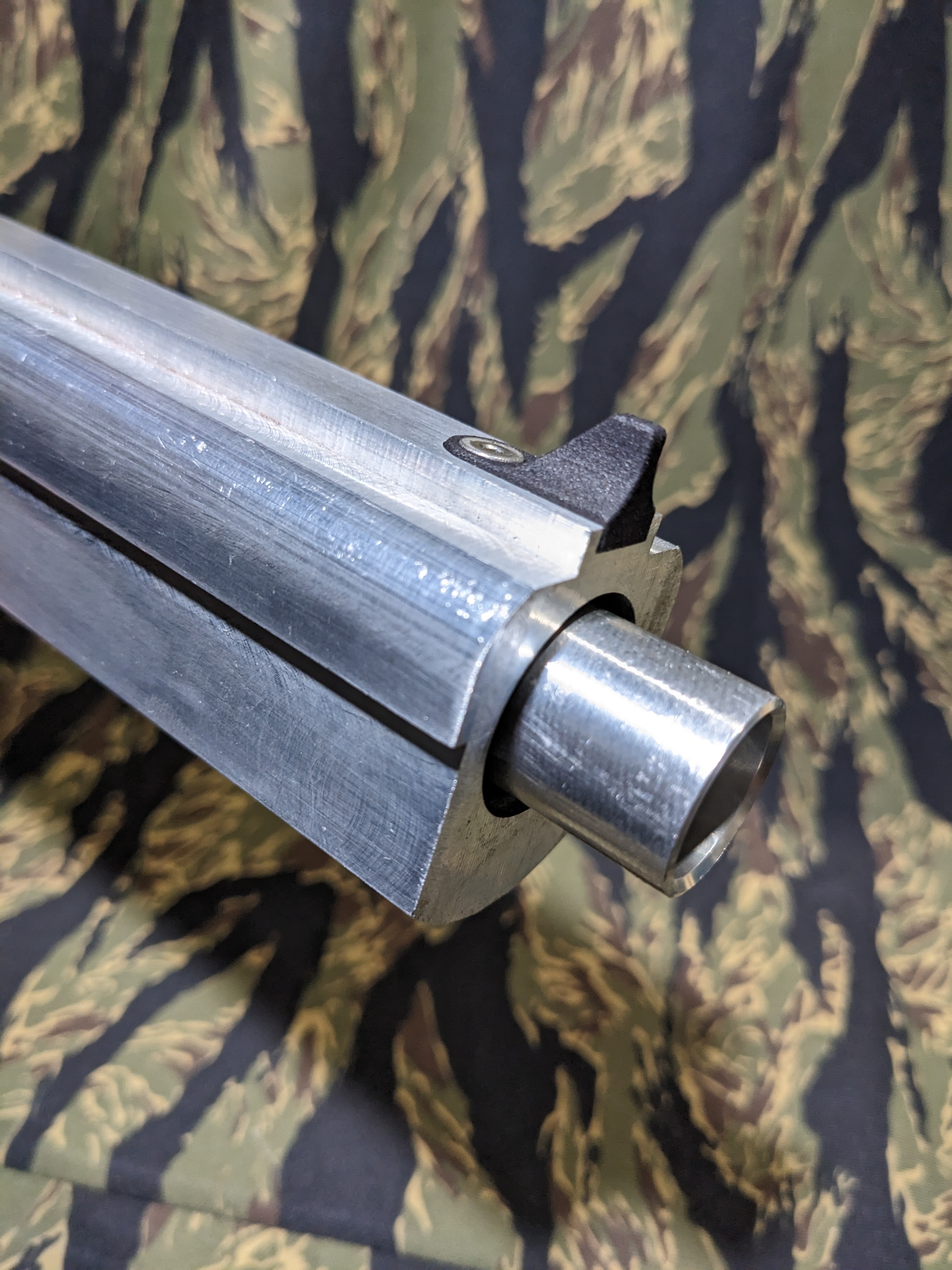

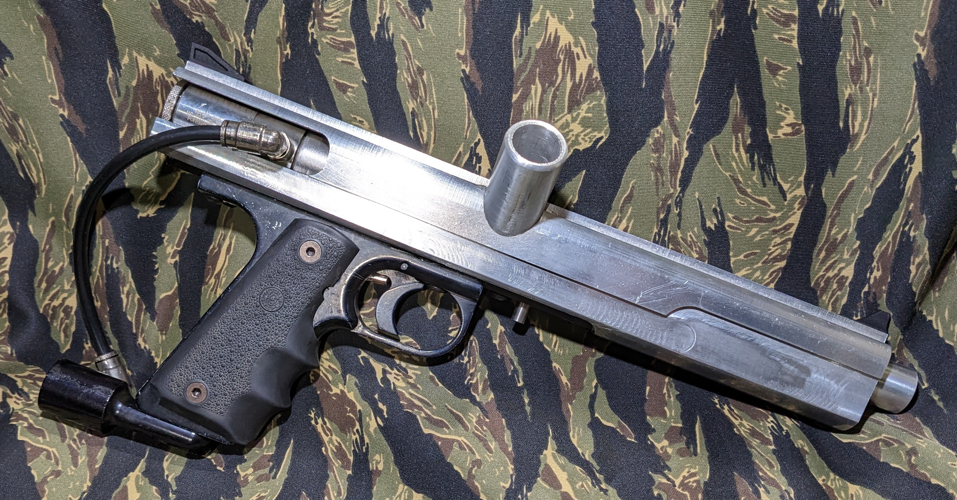

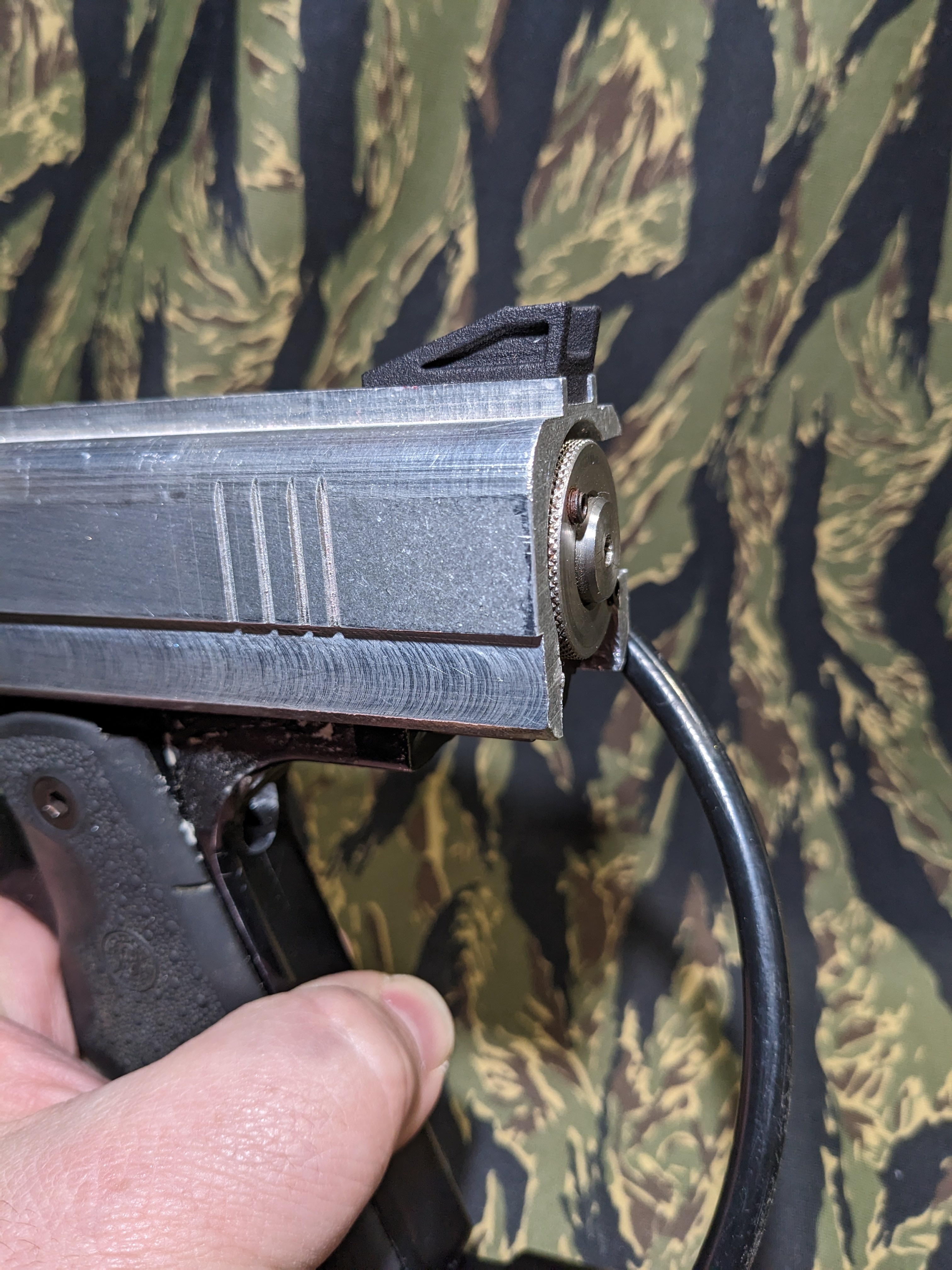

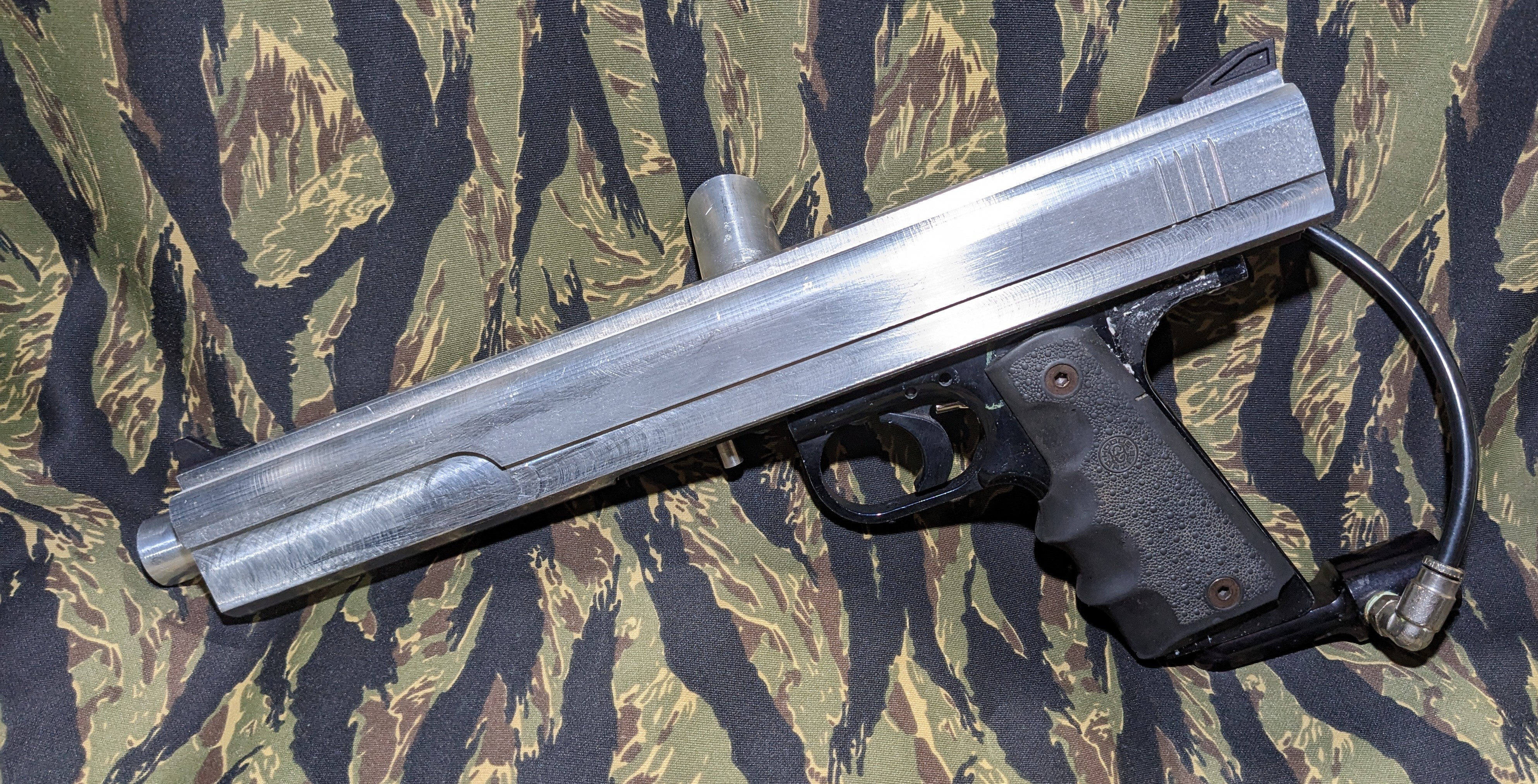

    This has been a long bit of time to get to this point I have started this all the way back in 2016 for a friend of mine we both moved since then and this one I deem not ready for prime time or public consumption because in attaching the feed neck I totally botch the welding and bulge the body around the top and I cannot read machine that so I will just have to accept that there's a bulge there. There's also a couple other little flaws that I just didn't like in this version.
    Anyhow this started because of a local legend of a automag and a duck that walked into a bar and came built together that used to be in flagstation paintball shop in Brooklyn New York. A lot of it was just hearsay of who did what I've never seen it but I wanted to make a clone a lot of discussion has always taken place and this friend of mine gave me the push.
    It is a precision milled way extended site rail essentially. The frame rail is machined to match the body to keep everything aligned very tightly it is machined match to the inside classic mag body that had the feed neck removed as well overall bore is only plus five thou oversized to the actual mag body and valve.
    And yes you're not seeing things that frame has been relocated way back more. Both sides are just temporarily placeholders for what will be the final more than likely sterling silver or stainless steel printed sites. Those are actually nylon printed on there right now.

      Does it replace the body and rail or does it slip over a slimmed body?
        Ecapnation commented
        It mostly is just a giant sight rail over a lot of very precision machined parts
