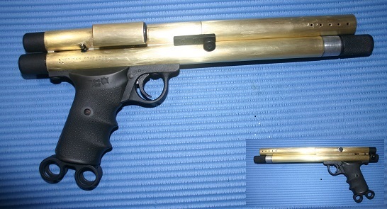

          I used that stuff on a powder coated brass body. It worked quite well......

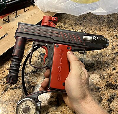

                  I may have to try that for my mag project. Whoever coated this forgot to coat the breach/threads, wanna get it annoed, but gotta strip this stuff first
