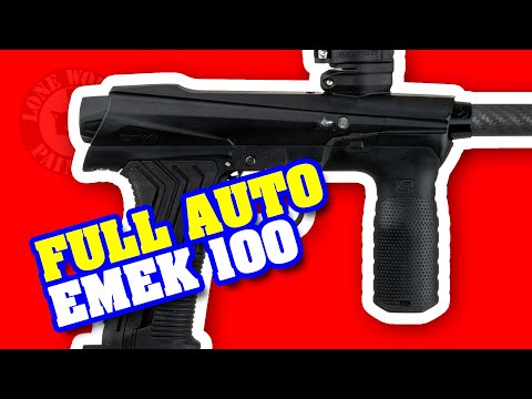

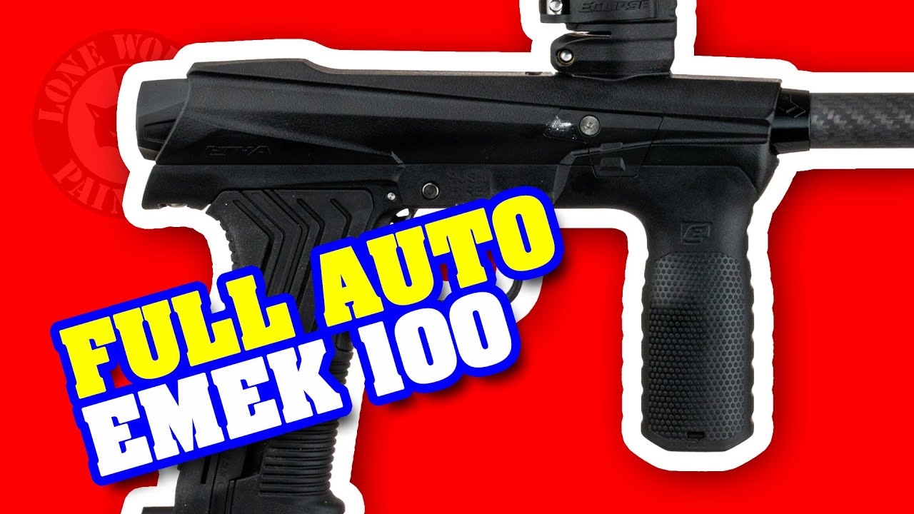

    I know there’s a few brilliant folks around here. Please explain how the switching or solenoid might work.
    The video itself doesn’t explain anything, just demonstrates the Emek firing away. Within the comments, Lone Wolf Paintball says it’s still in testing.

    I could not see any movement on shooters finger, so i’m guessing its not an RT mod.....

      I'd have an orifice and a shuttle piloting the valve. Shouldn't be too complicated.

          It is essentially a deliberate malfunction.... Also really stresses out certain components of the bolt system.

            This mod has been done before. It's essentially a deliberate o-ring malfunction. I was reading a post on one of the PE Facebook pages yesterday about it. From what people are saying, it looks like a good way to eventually trash a perfectly good Emek.

                  What if it is a pilot and shuttle type valve as Nate described? Wouldn’t make sense to advertise a future product that’s based off an oring exploit. Eyes shouldn’t be necessary if you can adjust the ROF to your loader. Does seem more novel, but it adds to the options for the platform and may still be cheaper than a new Etha 2.

                    What would cause this to be worse than the same number of individual trigger pulls?

                      From what people are saying on the FB post, PE is warning against this. Not only is it uncontrollable, but they’re saying it can damage the engine.

                    Damn that’s thing is cool. Makes me might want to buy another emek! I sold my regular one and got a mg100 that I use a hopper on mainly but will eventually use mags when the 20rd continuous ones get released. And as asked above, how does this hurt the engine more then the same amount of trigger pulls done consecutively? I mean the emek uses the same gamma core engine as most current PE markers up to their CS2, all which have the capability of having extreme rates of fire. And if you watch the pro games and the back players using gamma core markers, they practically shoot full auto speed continuously the entire match as they lane down the field.

                      If you can get it down to a reasonable pace as they did in the video then it shouldn't cause any problems in the bolt system. The usual "Full Auto" Emek mod results in a much faster, uncontrolled speed (like a sear failure on a blowback), and that is known to cause the core spool component of the gamma core to snap.
