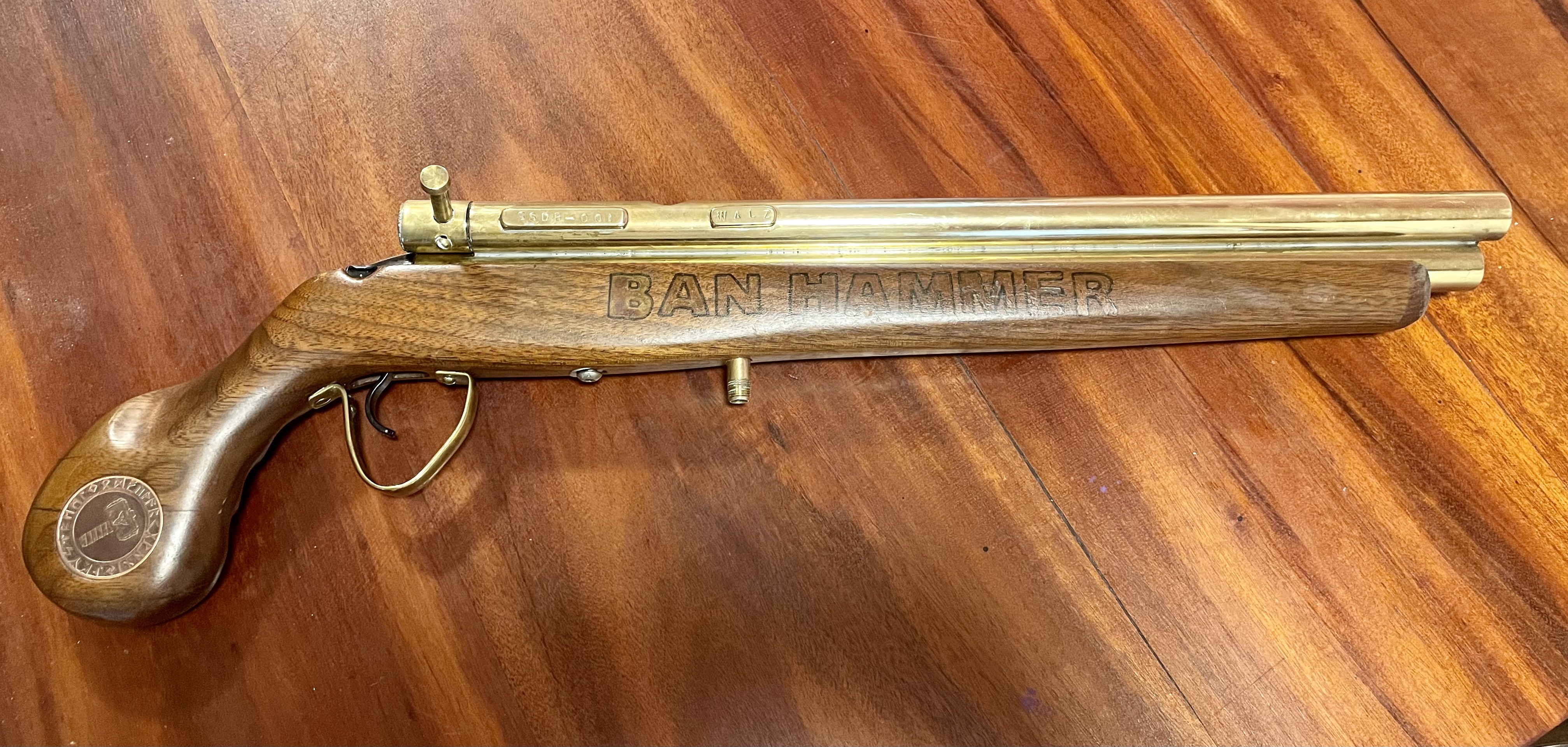

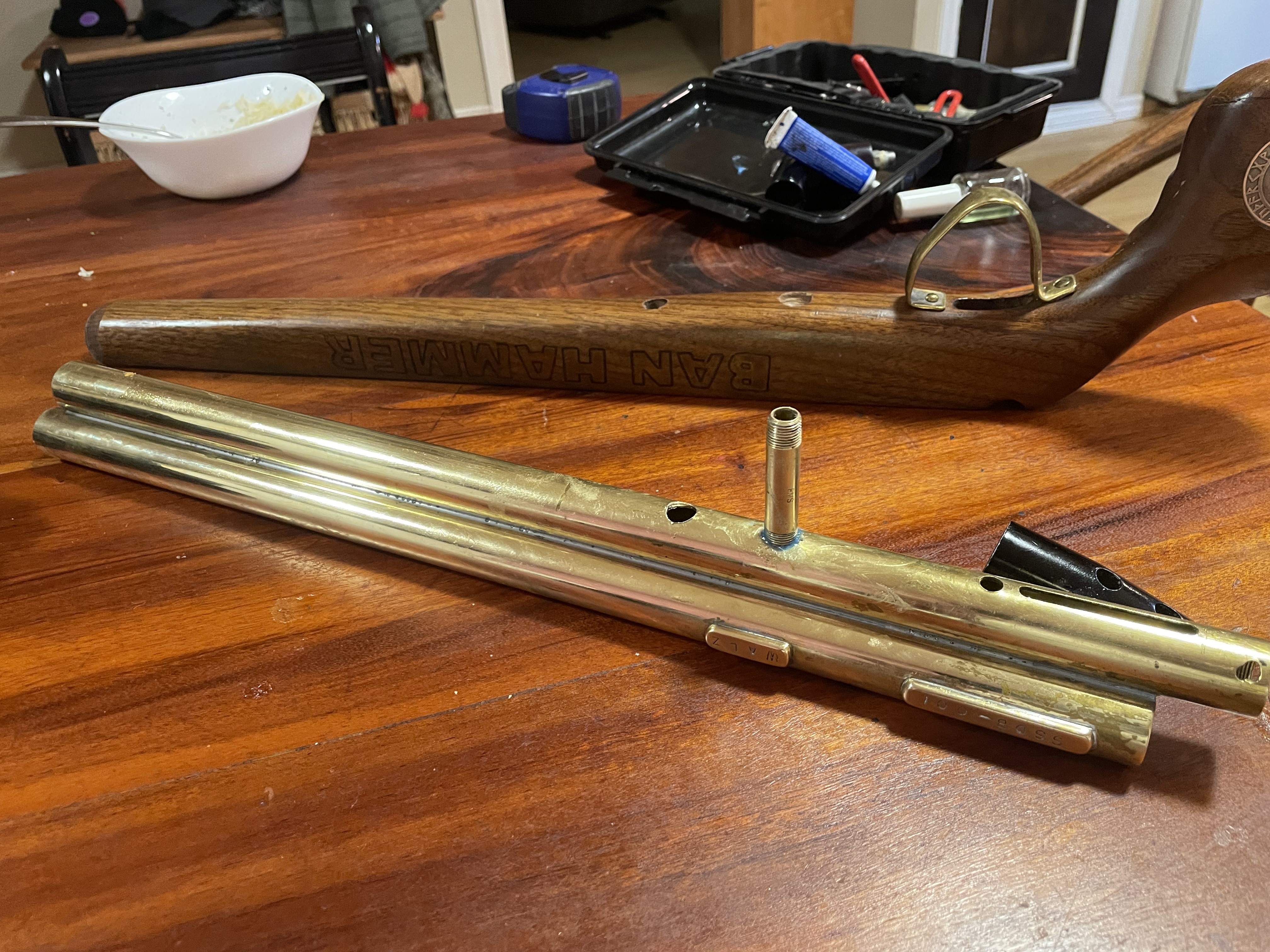

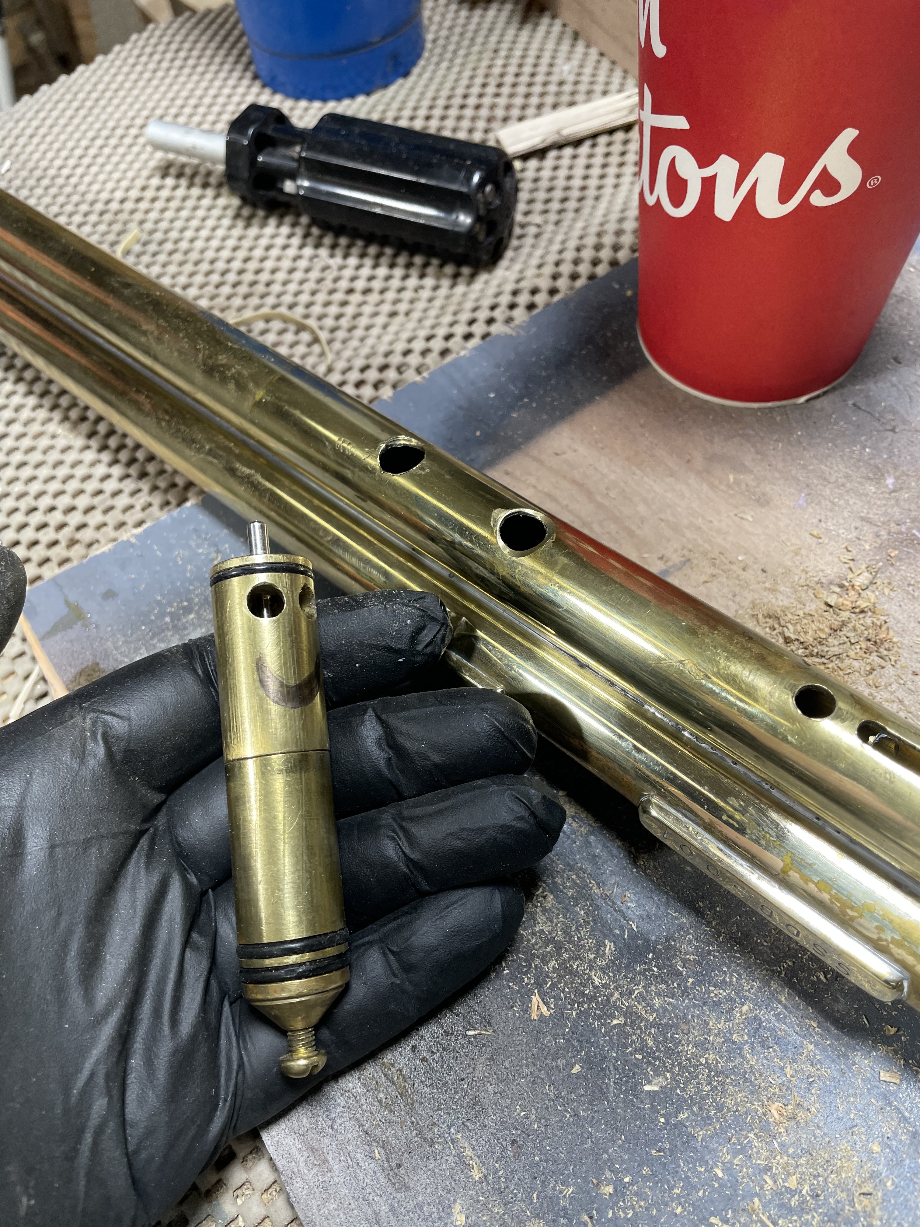

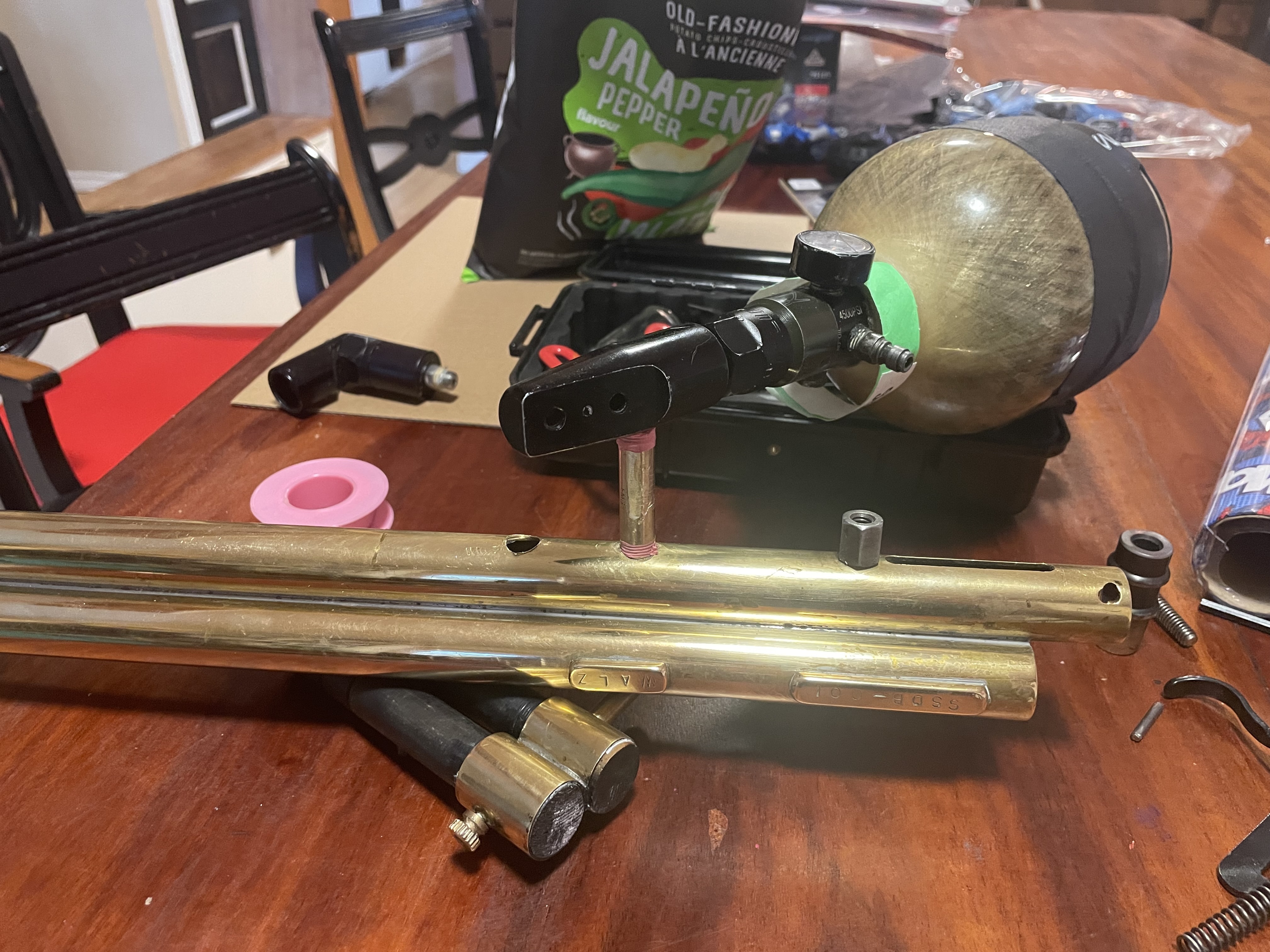

ID:	455078 Years ago I had trouble with the 12 gram cart valve for the Ban Hammer. So I decided to mod it for constant air (4 Oz tanks)
    I wanted to run a PPS angled adapter, and those are 1 inch in diameter. I didn’t want to drill out the original stock, because it is beautiful and also narrow. To that end I made my own stock and the Ban Hammer lost some of its character. Lately I have had 4 of my small tanks fail, and decided to try running a remote. With a 12 Oz sling across my back in a swag Nike Fanny pack, I hit the field and it worked! So no longer needing the PPS adapter, I decided to see what I could do to get the Ban Hammer back in its stock.
    Remote in Fanny Pack
    Custom Sheridan Pellet Gun valve I modded for constant air
    brass tube
    PASSED THE AIR TEST!!!
