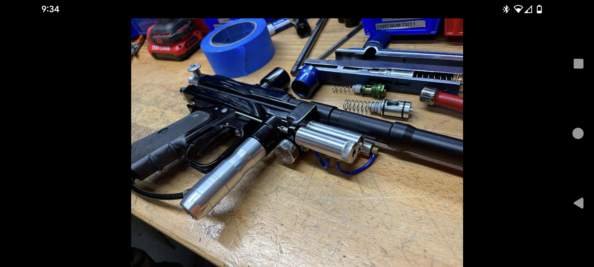

    I just recently came across a Facebook post by the tech at NovaPB that was just a picture (below). I couldn't find any more info on what is happening to this cocker. Obviously something is up with the pneumatics, that 3 way is nuts. However, in the back it looks like some valves I assume 11/16th and 9/16th.
    The owner commented on the pic, something about balanced valves they are coming out with.
    Do we have any information on these projects?

    Oh hey I remember that, just checked the old post on Facebook again. Seems like they are making 11/16th and 9/16th balanced valves. I think there trying to go LPRless, or at least that's what they talked about in the comments

      That 9/16" valve concept is pretty cool - integrating the jam nut is an interesting idea.
      • Toestr
        Toestr commented
        Looks like it'll use a regular socket too.

      Did they fabricate their own pneumatics to handle the direct operating pressure of their balanced valve (no LPR)?
      I'm confused about the design of the valves. Shouldn't the cup seals be enclosed somehow if it would be balanced?
      • Toestr
        Toestr commented
        The Spyder balance valve didn't have an enclosed poppet. Neither did the the Empire valve for Bushmassters.
      • minimag03
        minimag03 commented
        That's neat. I didn't consider balancing the valve on both sides with pressure. Thanks for explaining that
      Yeah I saw that and zoomed in to check. Sure enough thats a one piece 9/16 cocker valve. Very cool.

        And it's a captured valve, too. How very Angel of them. I dig.

      Makes we wonder if that section behind the name but threads isn’t too thick.

        Talking about the length of material sticking out past the jam nut threads? It does look like a lot. The length of the stem also looks short.

        The idea of a valve that threads in using the jam nut screws is definitely one of those “why didn’t we think of that 2 decades ago” kind of things.

          Anyone notice the sliced cocker in the back with one of their valves installed

            A potential issue with the integrated nut on the 9/16 valve is that it might not index properly when tightened down. I think they could skeletonize transfer section in which case it should probably be made of stainless.
            • latches109
              latches109 commented
              Moving on to 11/16” was the best solution from manufacturing and functional standpoint.

            Yeah I think both skeletonizing it would be helpful. And seeing how the rear is a socket I'd want it made of stainless to begin with.
