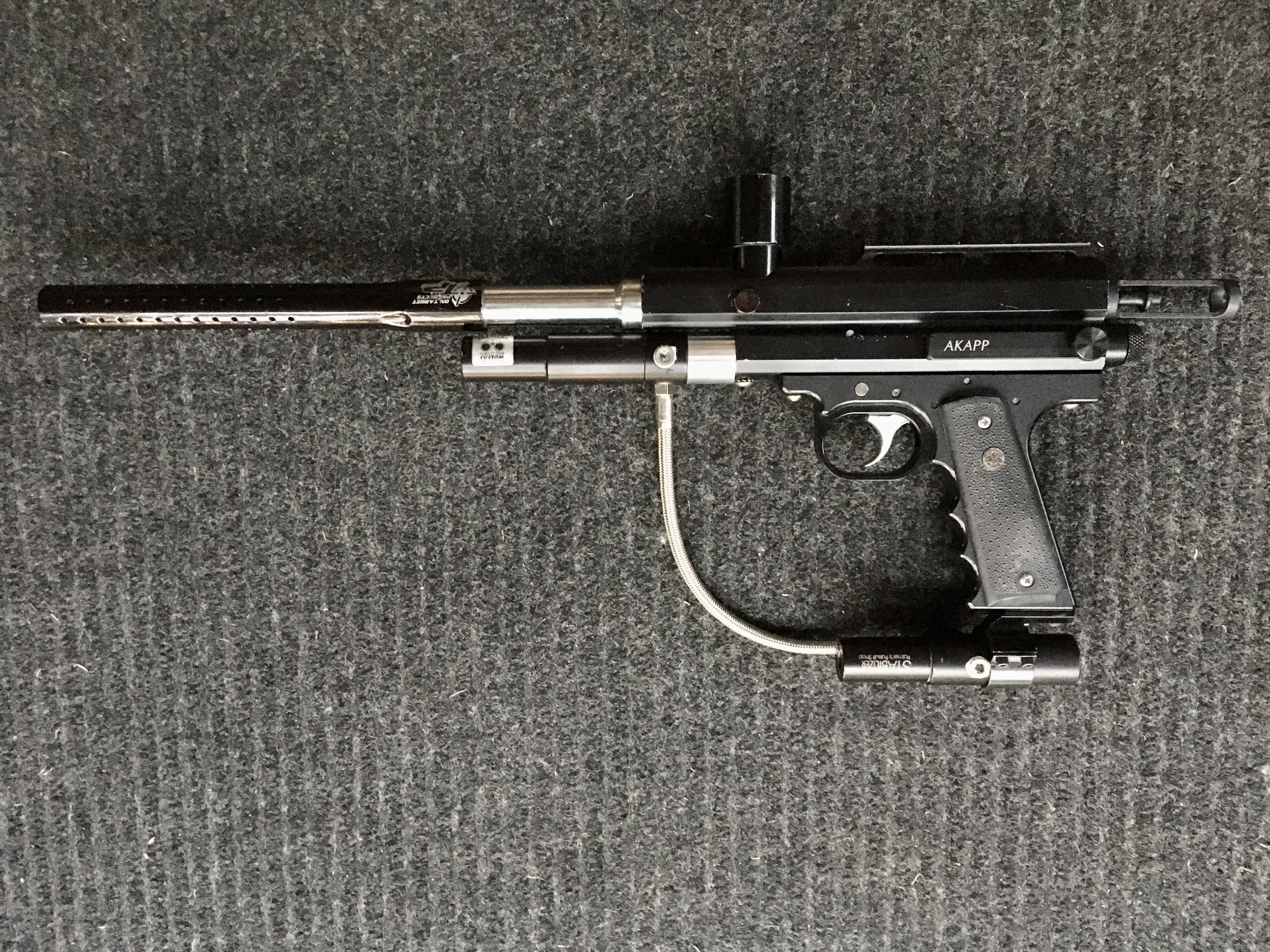

    What bits are needed to change the Stabilizer to low pressure operation? Can I simply source the correct spring? I remember Palmer used to offer a kit for this. I have an extra Stabilizer ready to go.
    I'd like to put together another setup akin to this one:
    Click image for larger version  Name:	9168F483-6A09-400B-B49B-6956867FF65C.jpg Views:	0 Size:	4.44 MB ID:	543021

      Oof! 200 psi is a very tough number for Spyders. I've done it once but could not get the marker to reliably cock. At 200 psi it would be better to use the balanced valve. That's not something I had in the plans, however it could be done. Ideally I'd like to be between 250 and 300 psi.
      Perhaps I'll give them a call and find out what all I need.

        I have used a female Stab on my Ion without any difficulty (150psi or so)... to the best of my knowledge it was a standard output reg.
        That pressure range shouldn't be an issue, though... 300psi is close to the middle of the adjustment range of a standard Stab.
