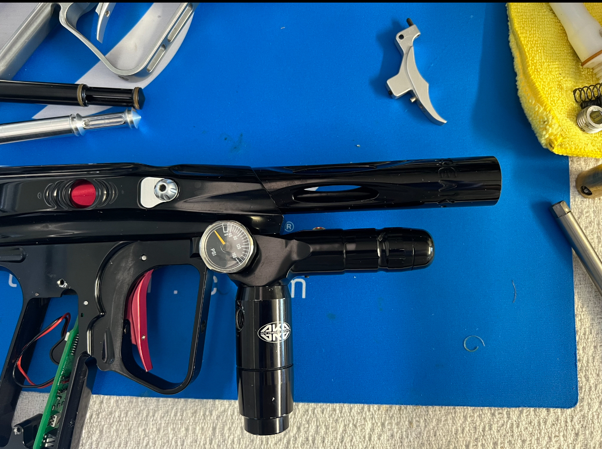

    you can use an ego solenoid using qty (2) 1.6mm x 12mm screws. this would eliminate the upper board and allow you to add a frame from another platform, e.g. ego
    • latches109
      Always Sciencing
      • 2092
      Here it is, working with IPR mod, my evolve bolt is leaking but finally put it together.
