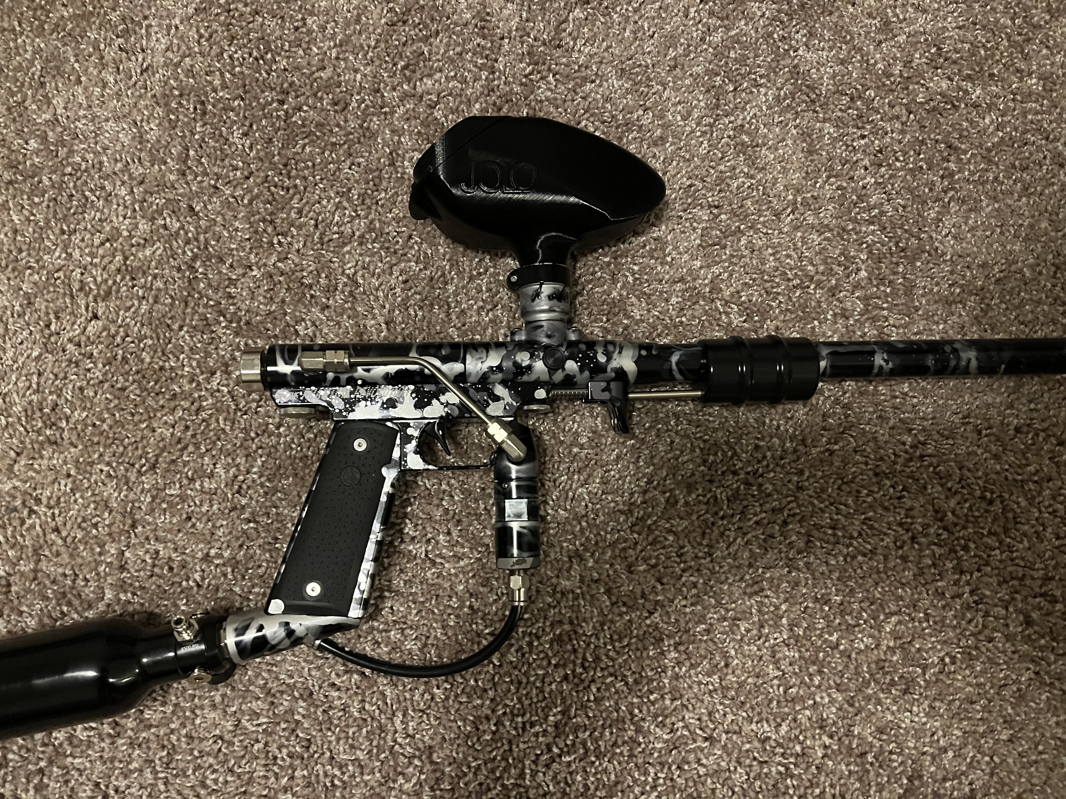

    I absolutely love CCI phantoms. I've got a variety of pump markers; a smooth as butter pre-2k sniper, a gorgeous custom pgp, my wife's emek and an armson semi but if I ever need a competitive edge I go for my phantom.
    I run mine with a 12 Rd feed, UC kit, vsc 12 gram, 45* grip and anywhere from a 6" to a 14" barrel depending on the field I'm playing. I used to swear by using a t-stock but have found that playing without one makes me stop chicken winging and makes me a much smaller target.
    I think the nice part of a phantom is it's dependability and modular format. With the right parts you can have a complete unique marker that feels right for any player or scenario.

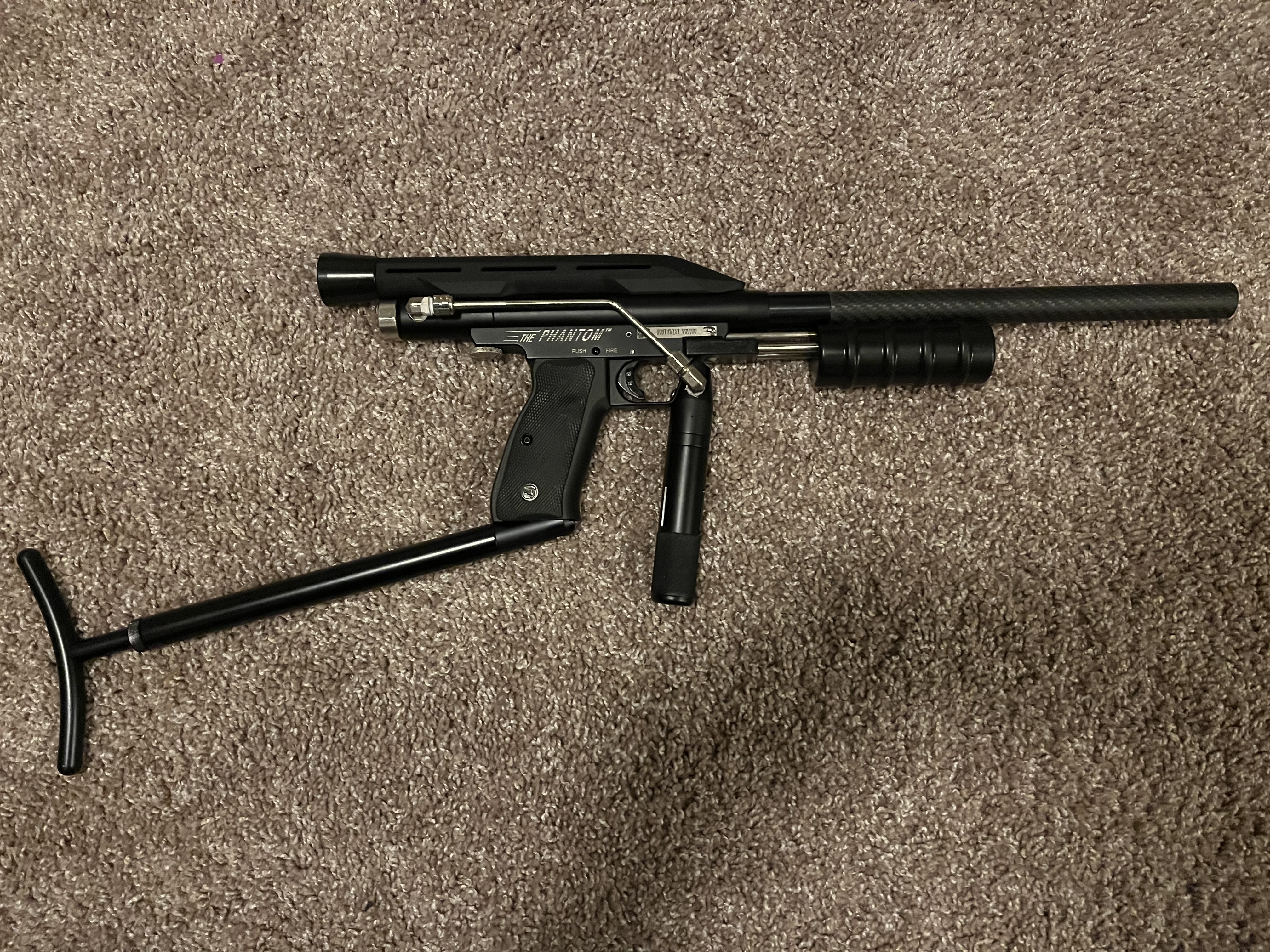

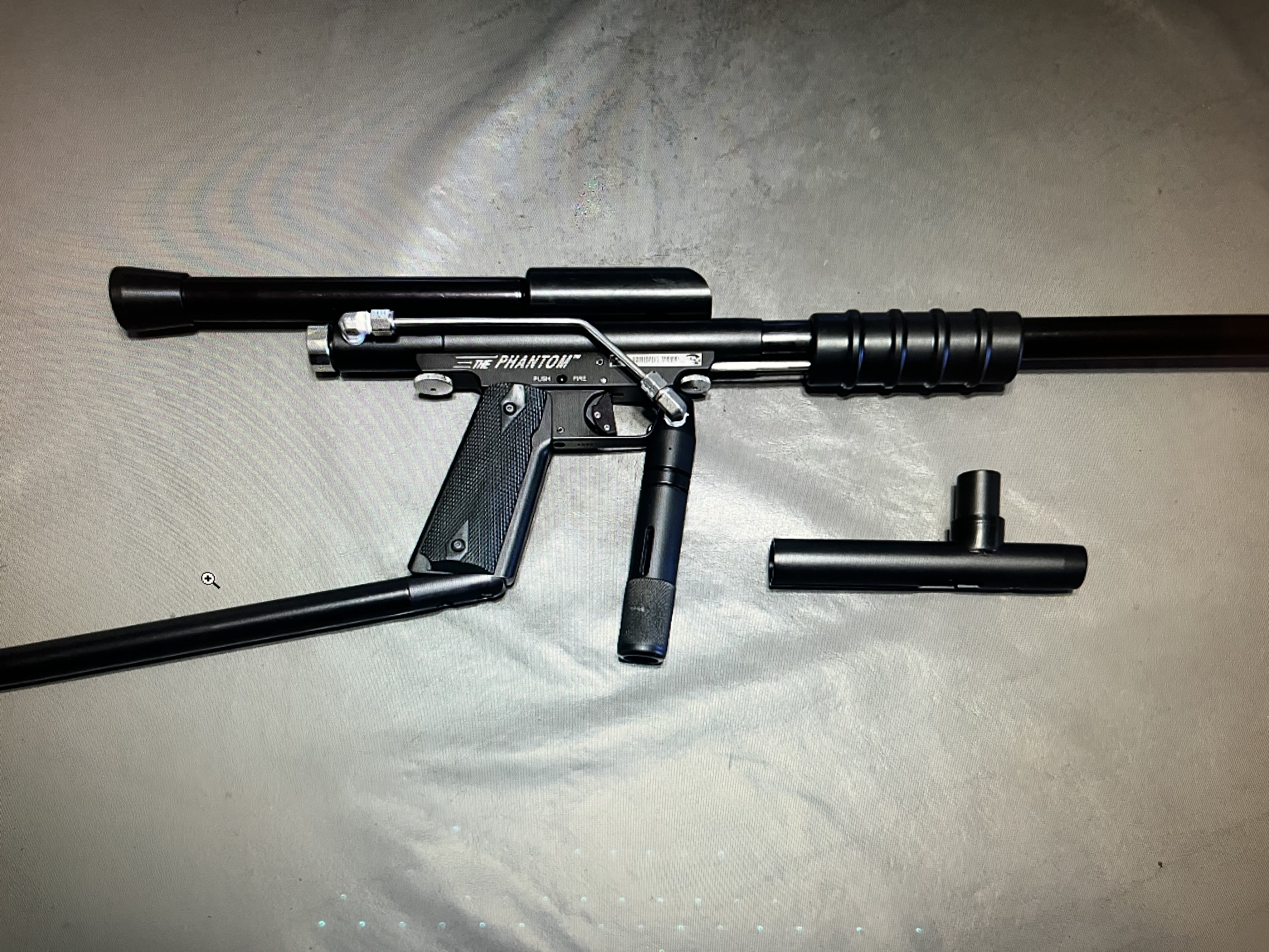

            I have an interesting order coming next week, but figured I could post an update.
            I was shopping on multiple fronts, and they all kind of came together at the same time.
            Stock VSC: Got a bone stock VSC phantom circa 2005 from a member on here. Without a return spring having to pull it forward is a foreign feeling. With a return spring, better or at least more traditional, but hated it with the stock barrel. I'm guessing the pump handle swelled or something as there was noticeable drag and just consistent resistance that was pretty unpleasant. 3/10
            Seller was super cool and shared some of his setups and recommendations. Happened to order a Deadly Wind carbon fiber barrel that only had a little bore at the back of the barrel for the handle to slide on, much smoother, 5/10.
            Open class: second phantom came from ebay, pretty much purchased within an hour of each other to the lament of my wallet. Vandetta style undercocking kit, has the newer body with the o-ring detents and some neat extras. No stock and no trigger shoe, but had those to add. This one was painful to pump when received, actively straining and flexing, having to hold parallel to body to pump. 1/10
            Modified Open Class: Turns out previous owner had 3 return springs on this guy, either they were much, much stronger than I am, or they just installed them prior to the sale to make sure it wouldnt be lost. Removing two of them and this is dramatically better, feels a little harder than a really lightly sprung sniper, but smooth, stabilizing rods take away the stock woble. 6.5/10
            Modified VSC: By this time, mods including those recommended by the MCB member came in. All those together, and the handsome little devil feels great. As a bonus I get to run one of my favorite grips. The factory style pump handle, but under the barrel feels nicer than the square vendetta style, also used one return spring for this one. Pretty much tied with its sibling, and on par with even a really well sprung sniper, but the marker itself is way lighter and has a more consistent pump stroke. Plus it shoots great! Played a round last weekend and put about 300 rounds through it. 7/10.
            The wildcard.
            Phantom Revolution: Noticed this guy on facebook from a seller who was selling a lot of really high end phantoms. It looked like it was missing some parts, but the seller was actually able to find them prior to shipping. Also had aftermarket color matching detents. Initially, it was disappointing, especially for the price. Pump trigger bound up pretty easily without the barrel handle. Slide rod is surprisingly wobbly, and the springs don't pull it forward consistently so running into similar odd feeling as the stock VSC without a spring. ?/10
            Cleaned and tweaked Phantom revolution: Disassembled and found that the detents were causing a lot of drag on the bolt, especially with there being 2 and the bolt not having slots for them. Inserted a blank on one side and now far less drag. Added the over-barrel handle and less wobble. Cleaned off some old grease/gunk (previous owner stated he had not used it in a very long time), and re-lubed the bolt and the pump rods. Goodness, it is smooth! Like problematically smooth. Like "staring at my other pumps and thinking how clunky they feel by comparison levels of" smooth. "Looking for another Revolution levels of smooth."
            Pump action is buttery, just a perfect amount of resistance. It still seems to get caught or bind up a little bit occasionally. I need to really take everything apart and clean/replace o-rings etc to get it perfect as it doesn't feel smooth all the time, but when it does its thing, it is sooooooo very good. 10/10.
            Verdict thus far: You guys weren't wrong. The pump stroke can be a bit stiff, but with any of the stabilizing methods it feels pretty good. If I got the open class phantom first, I think I might have immediately looked to trying to sell it as that was painfully hard. Thankful I had a chance to talk through with a few phantom people who had some advice so I had things to look for and improve.
            The Revolution is a pretty odd duck. Will have to wait to see how it shoots, but it really has potential to be pretty darn great. If I could find a way to stabilize it a bit more, make it more consistent, and add an undercocking kit, I think it would be the new bar.
